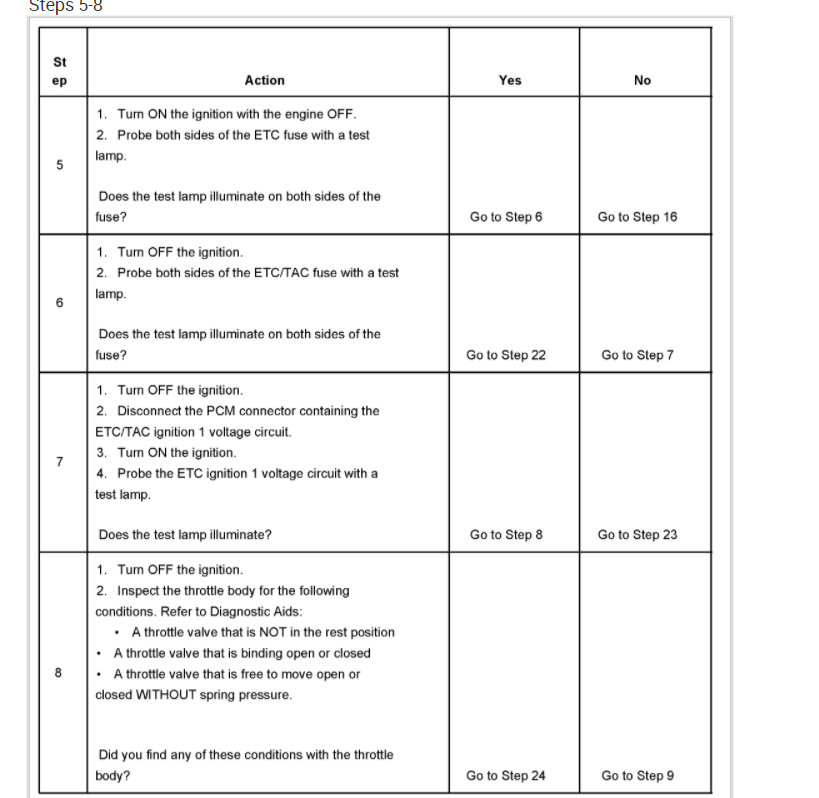

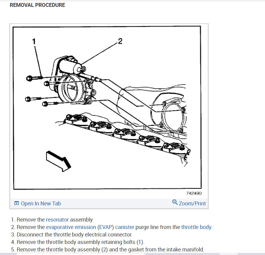

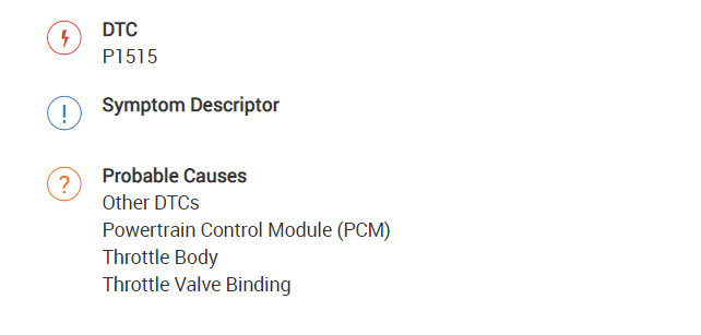

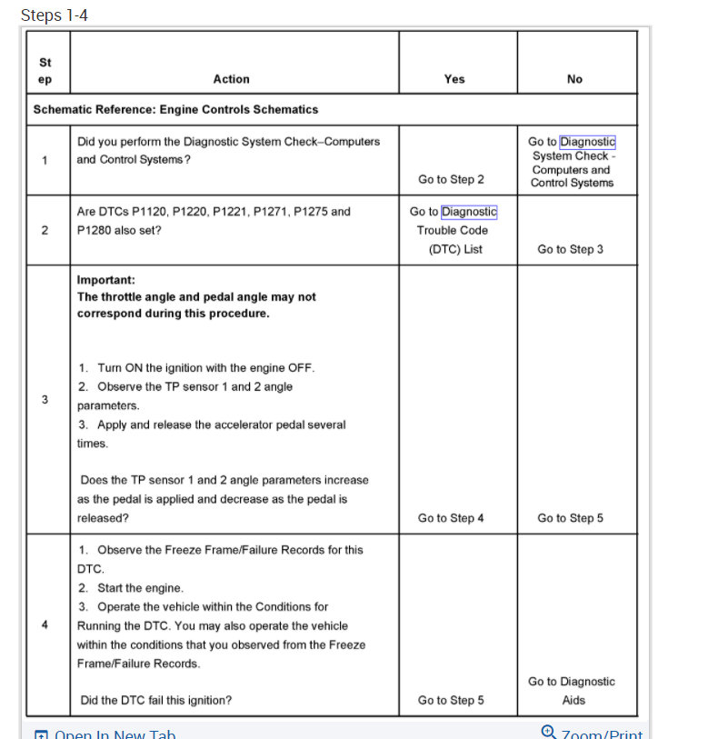

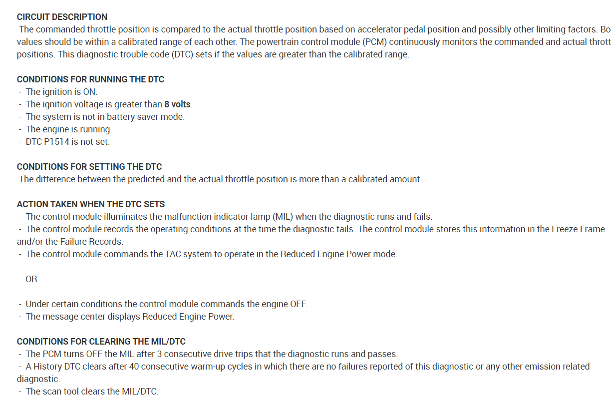

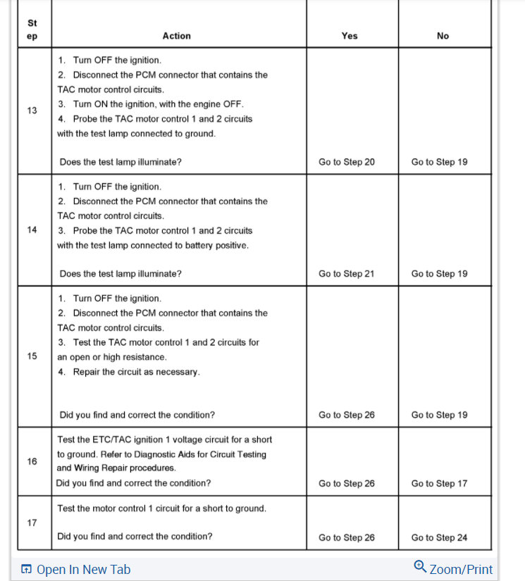

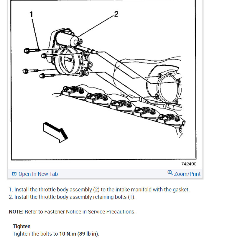

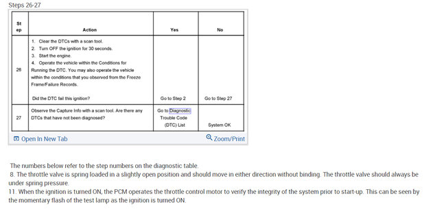

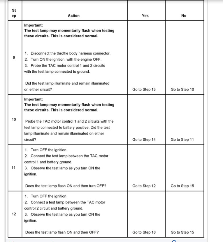

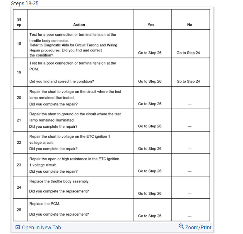

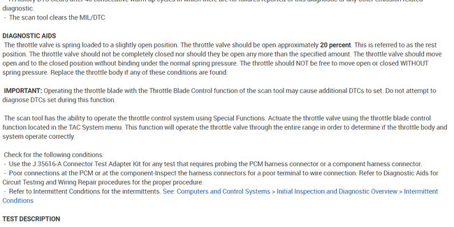

It shuts off while driving and won't start back up and has code p1515.
Apr 7, 2021 at 8:14 AM
Experienced Mechanic
52,796 POSTS
Good afternoon,
I attached the possibilities below for you. The most common issue is the throttle body itself.
I attached the flow chart and the procedures for you below.
