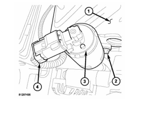

Check Engine Light came on. Engine runs normal. Read Code P1404 "Exhaust Gas Recirculation Close Position Performance" on scanner. How to replace EGR value if necessary??

this cold be an egr problem , wiring or a pcm problem. check to see if egr is clogged or the passages so try cleaning it first. removal of egr valave is a cople of bolts and electrical..see pic.
