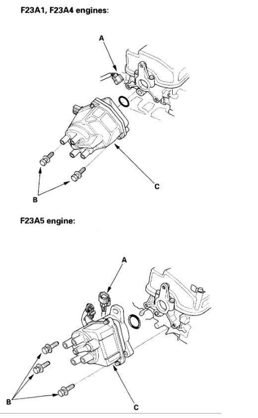

Car won't go past 3000 RPM is this the camshaft sensor?
I love this site
Oct 22, 2014 at 1:50 PM
  • 55,728 POSTS

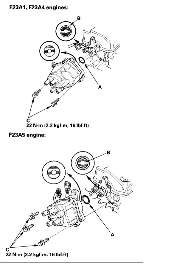

This problem has to do with the distributor and the sensor inside which is inside. What happens is the bearing goes bad due to lack of oiling and it takes out the sensor. We can see evidence of this when you remove the cap and see rust colored dust. Its best to get a rebuilt unit from Amazon and install it.
Here is the part for $90.00
https://www.amazon.com/gp/product/B074FJBNYH/ref=as_li_qf_asin_il_tl?ie=UTF8&tag=2carprcom-20&creative=9325&linkCode=as2&creativeASIN=B074FJBNYH&linkId=fabe1da354e5357178482e35738ceb44
Here are some guides below that will help you change it out.
