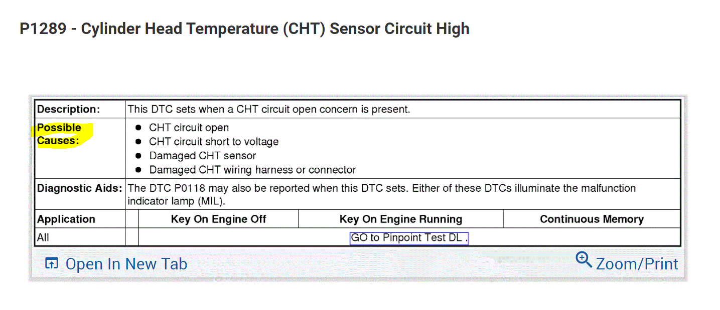

If the engine was cold and you got that code, either the sensor is bad or there is a wiring issue. If you look at the last pic below, it shows the possible causes.
We have two choices here. Chances are the sensor is bad, but if you want to be sure, I have the diagnostics for the system. It is very extensive. Here it is.
If you want to try replacing it, see directions after the diagnostics.

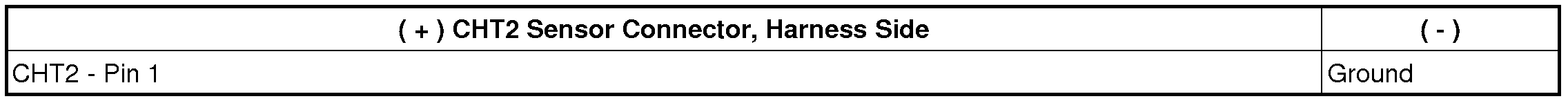

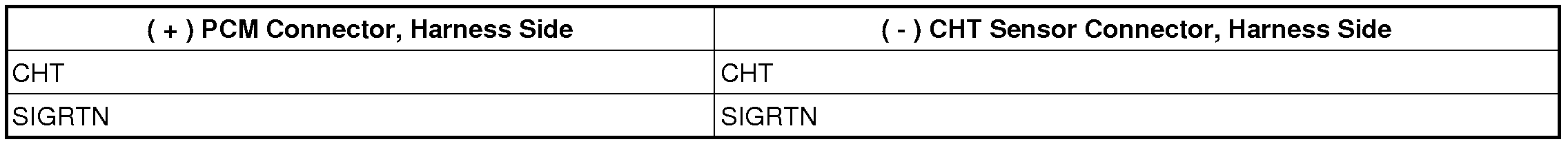

DL4 CHECK FOR AN OPEN CIRCUIT
- Ignition OFF.
- PCM connector disconnected.
- For the CHT2 sensor,
- Measure the resistance between:
pic 3
- For all others,
pic 4
Are the resistances less than 5 ohms?
- GO to DL5
- REPAIR the open circuit. Clear the PCM DTCs. REPEAT the self-test.

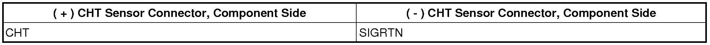

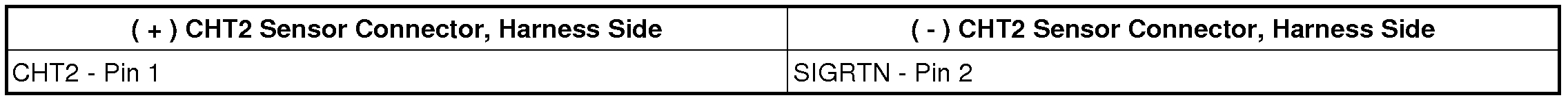

DL5 CHECK FOR A SHORT TO GROUND
pic 5
- For all others,
pic 6
Are the resistances greater than 10K ohms?
- GO to DL6
- REPAIR the short circuit. CLEAR the DTCs. REPEAT the self-test.

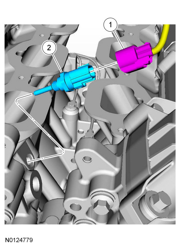

Here are the directions for replacement. Note: You must remove the lower intake manifold to access the sensor. I will provide the directions for manifold removal after this.
______________________
2015 Ford Truck Explorer 4WD V6-3.5L
Cylinder Head Temperature (CHT) Sensor - 3.5L Ti-VCT, 3.7L Ti-VCT
Repair Removal and Replacement Cylinder Head Temperature (CHT) Sensor - 3.5L Ti-VCT, Exploded View
pic 12
Item Service Part Number Description Tool Number Material Name Notes
1 - CHT sensor electrical connector (part of 12A581) - - -
2 6G004 CHT sensor - - 10 Nm (89 lb-in)
Removal
WARNING: Before beginning any service procedure in this section, refer to Safety Warnings in Section 100-00 . Failure to follow this instruction may result in serious personal injury.
Remove the lower intake manifold. For 3.5L Twin Independent Variable Cam Timing (Ti-VCT) engine, REFER to Section 303-01B, Lower Intake Manifold . For 3.7L Twin Independent Variable Cam Timing (Ti-VCT) engine, .
Disconnect the CHT sensor electrical connector.
Remove and discard the CHT sensor.
Installation
NOTE: Do not reuse the CHT sensor. Install a new sensor.
Install a new CHT sensor.
Tighten to 10 Nm (89 lb-in).
Connect the CHT sensor electrical connector.
Install the lower intake manifold. For 3.5L Twin Independent Variable Cam Timing (Ti-VCT) engine, REFER to Section 303-01B, Lower Intake Manifold . For 3.7L Twin Independent Variable Cam Timing (Ti-VCT) engine,
