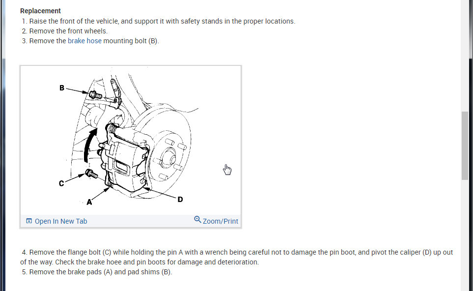

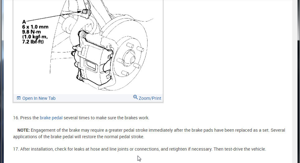

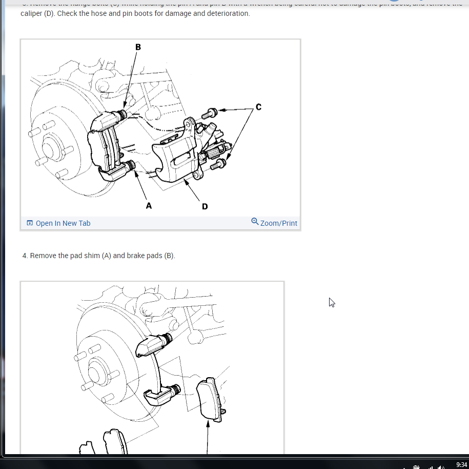

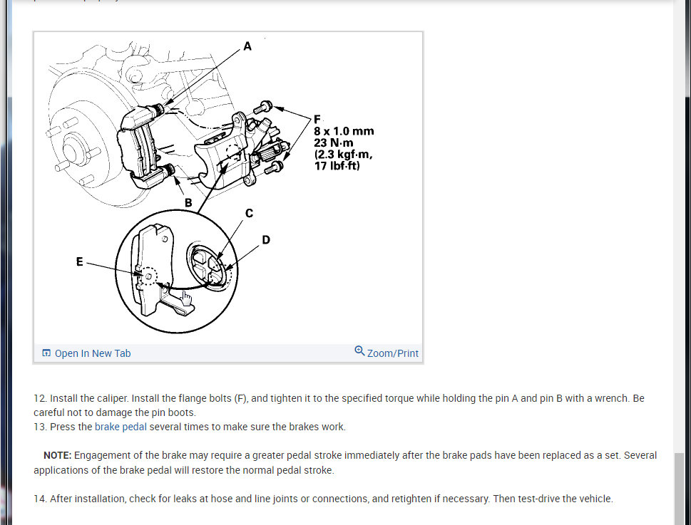

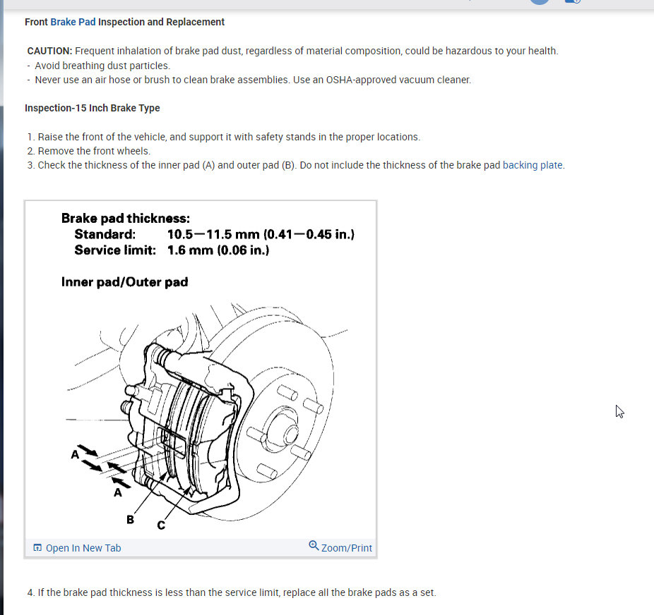

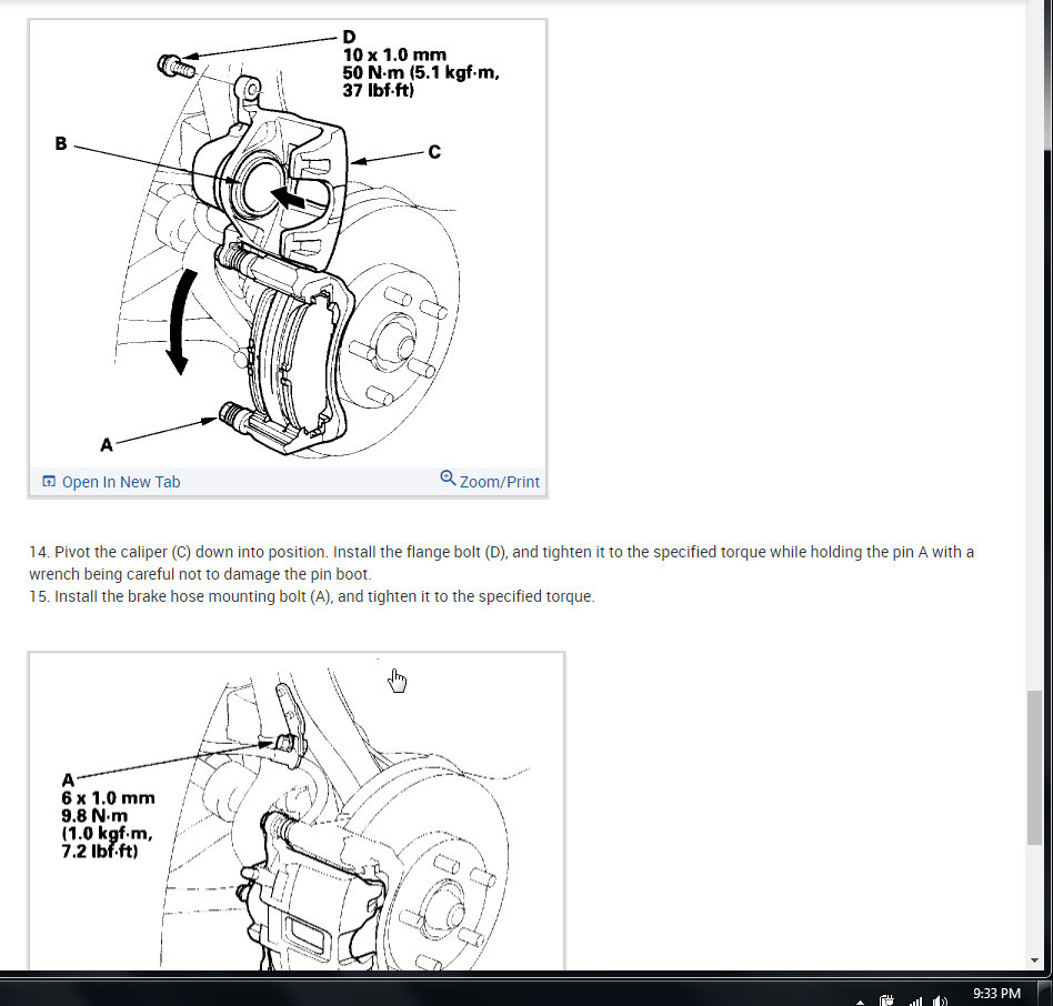

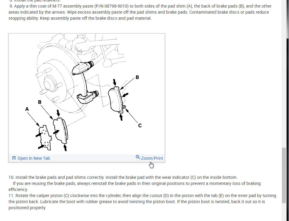

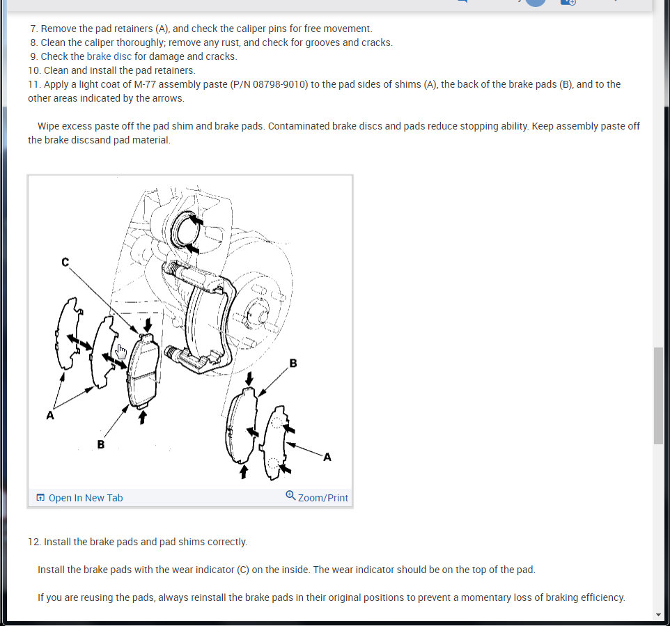

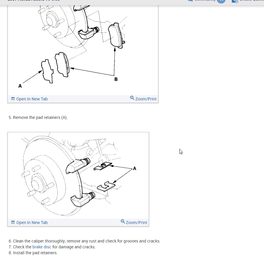

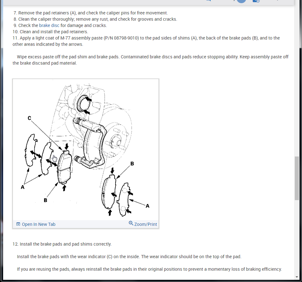

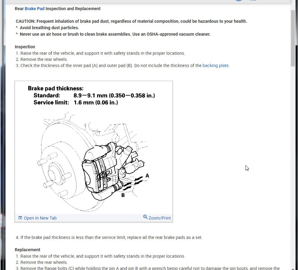

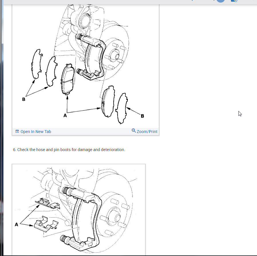

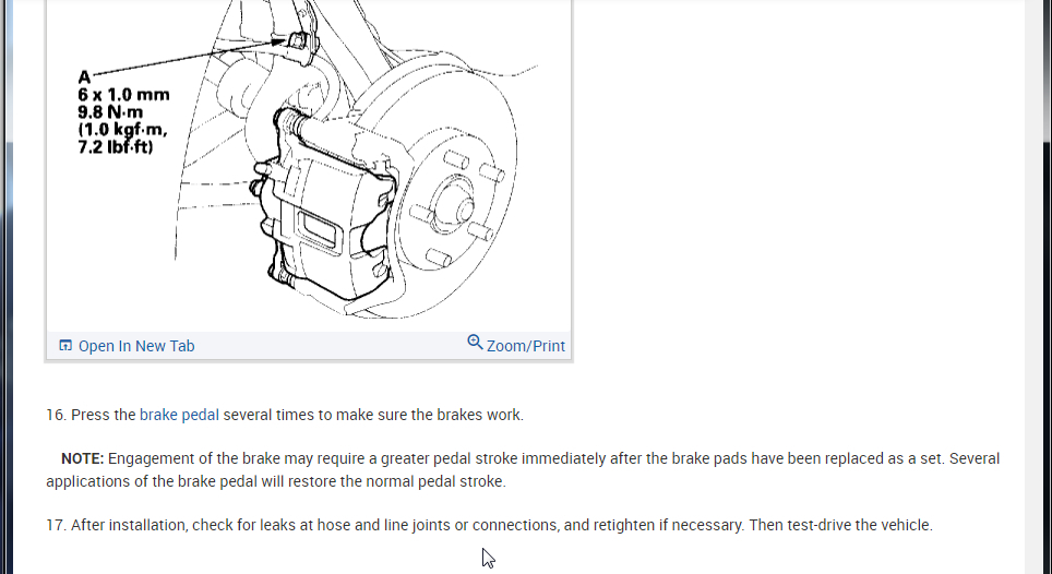

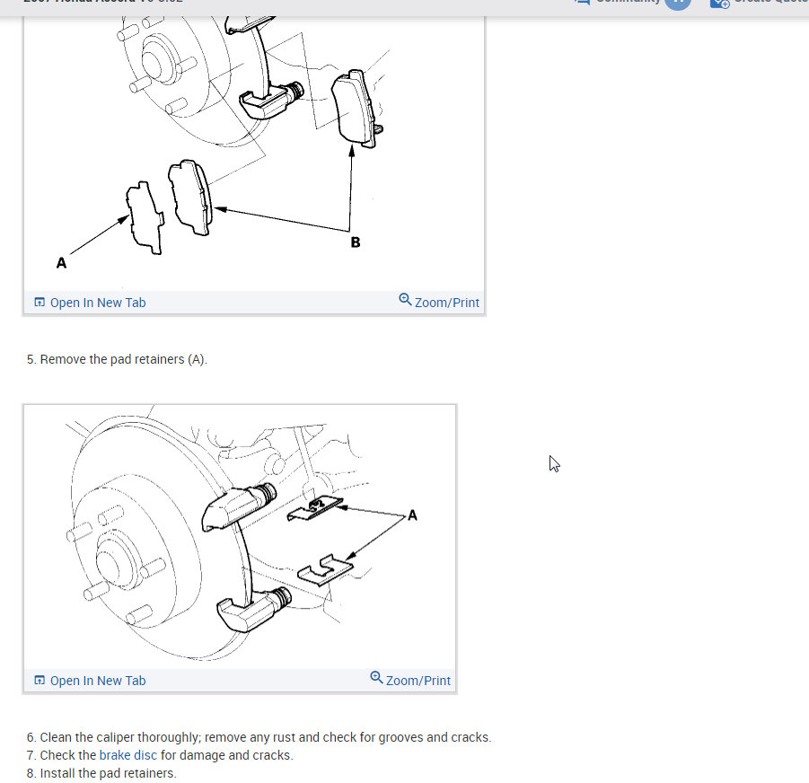

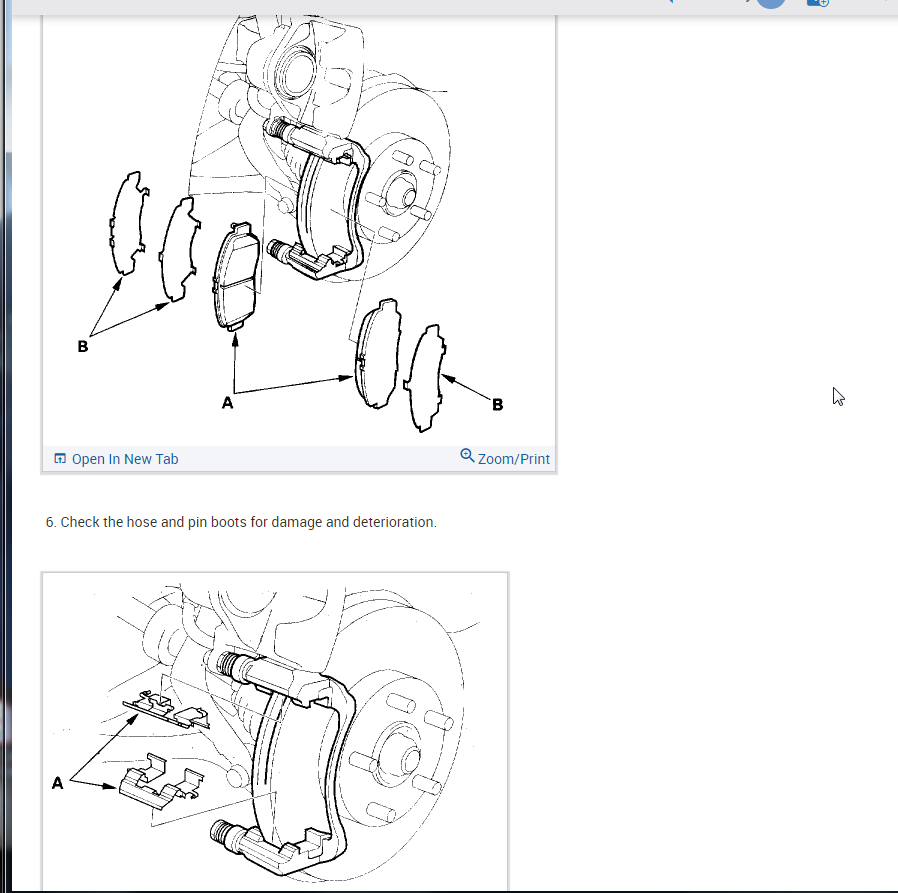

feels like the brakes are bad I need to replace them can you give me instructions
Dec 30, 2016 at 8:16 AM
Experienced Mechanic
18,907 POSTS
Here are a couple guides that will help with this. Plus a video of how to replace the brakes on a civic which is pretty similar to your vehicle.
https://www.2carpros.com/articles/how-to-replace-rear-brake-pads-and-rotors
https://www.youtube.com/watch?v=_HrWXRdD2ug
Lastly I attached the process below from the manual on how to replace these. Let us know if you have questions. Thanks
