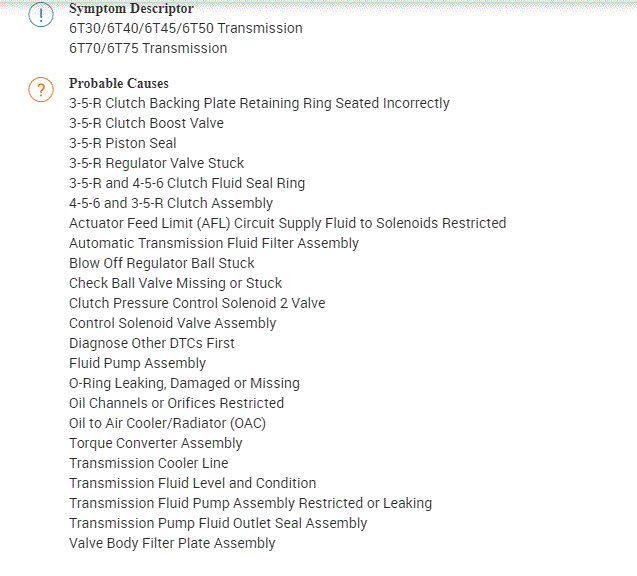

Car coded P0776 and I’ve been told by the mechanic that it requires a new transmission. Looking to know if that is the only solution or if there are solutions like changing solenoid and flushing fluid would remedy the issue?
Aug 19, 2020 at 5:40 AM
Good afternoon,
The code is pointing directly to an internal issue inside the transmission.
It would require removal of the transmission and rebuilding it.
A lot of shops just want to replace it with new but there are other options. You could have it rebuilt or install a used one to keep the price down.
From the looks of the issues, I doubt changing the fluid and filter will fix it at all.
I attached the possible issues but they are are pointing to inside failure.
Aug 19, 2020 at 6:30 AM
BRYANDIRKS
Okay. Shop said GM transmission to replace with $3,950.00 parts and labor. 3 years 100,000 mile warranty will have to go that way. Shops I talked to said they don’t rebuild that particular 6 speed.
Aug 19, 2020 at 7:56 AM
Okay, that sounds like a good price as well.
