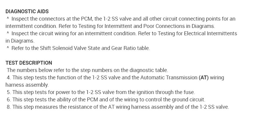

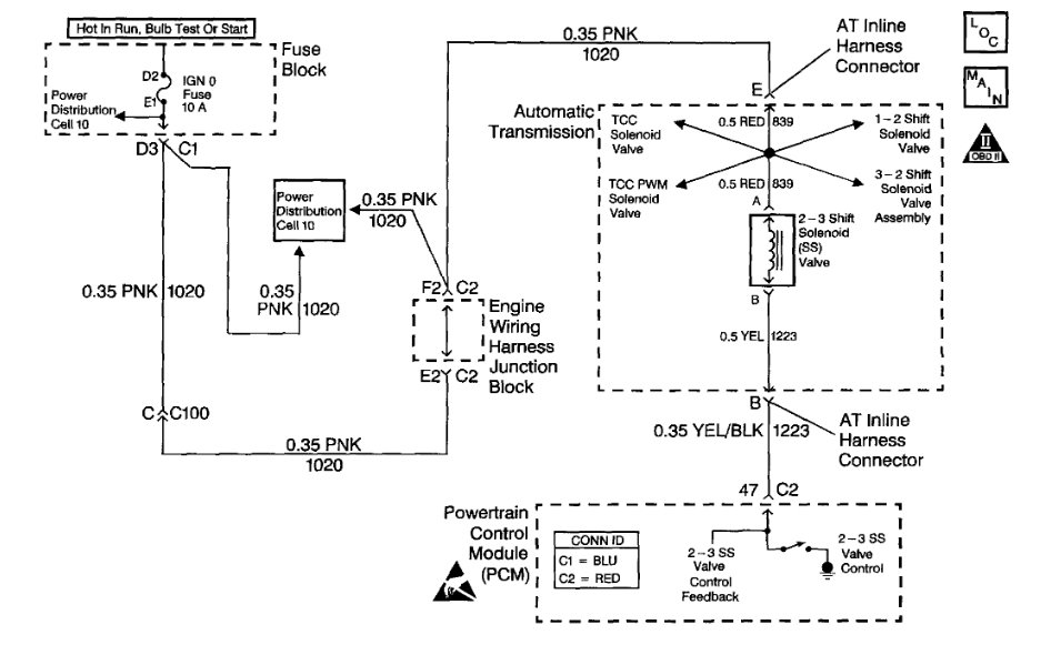

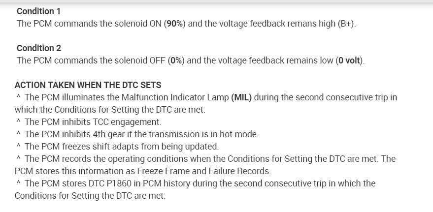

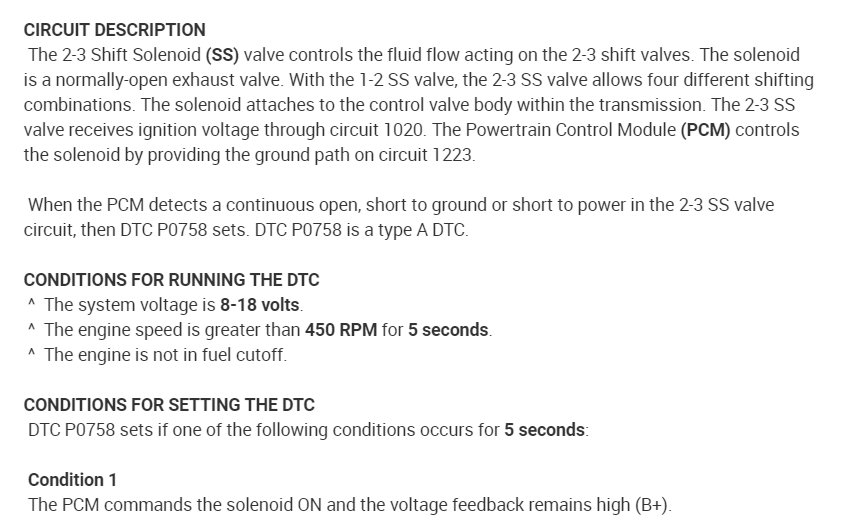

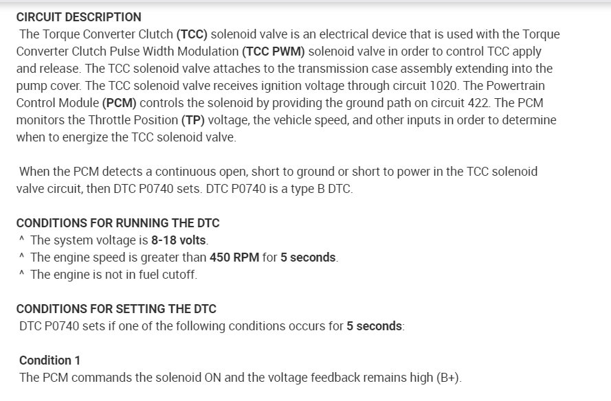

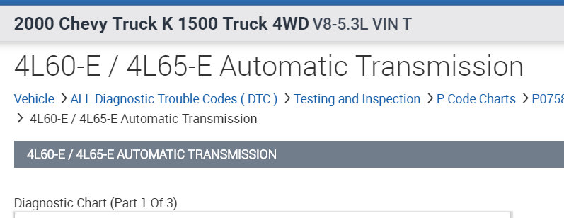

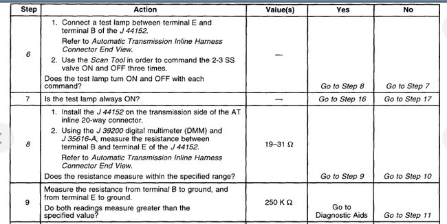

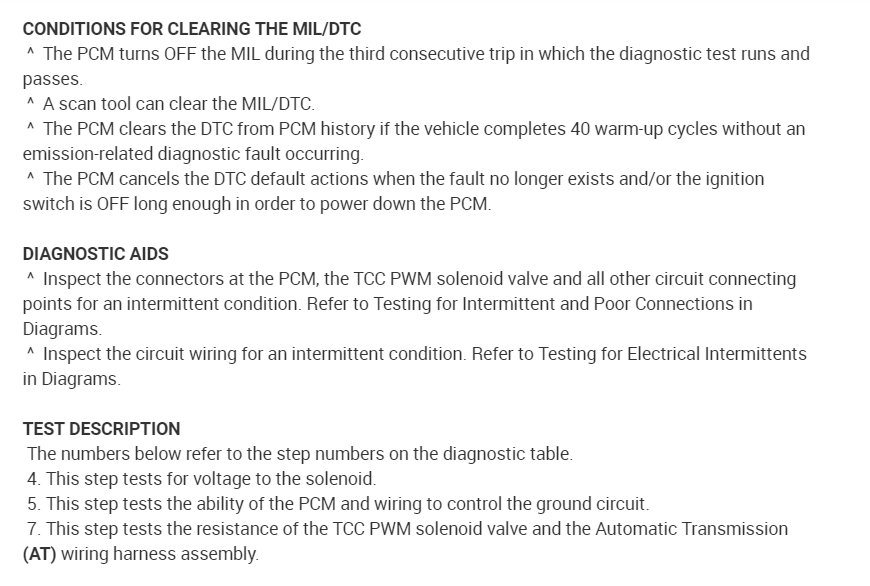

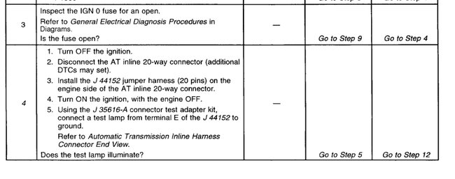

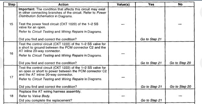

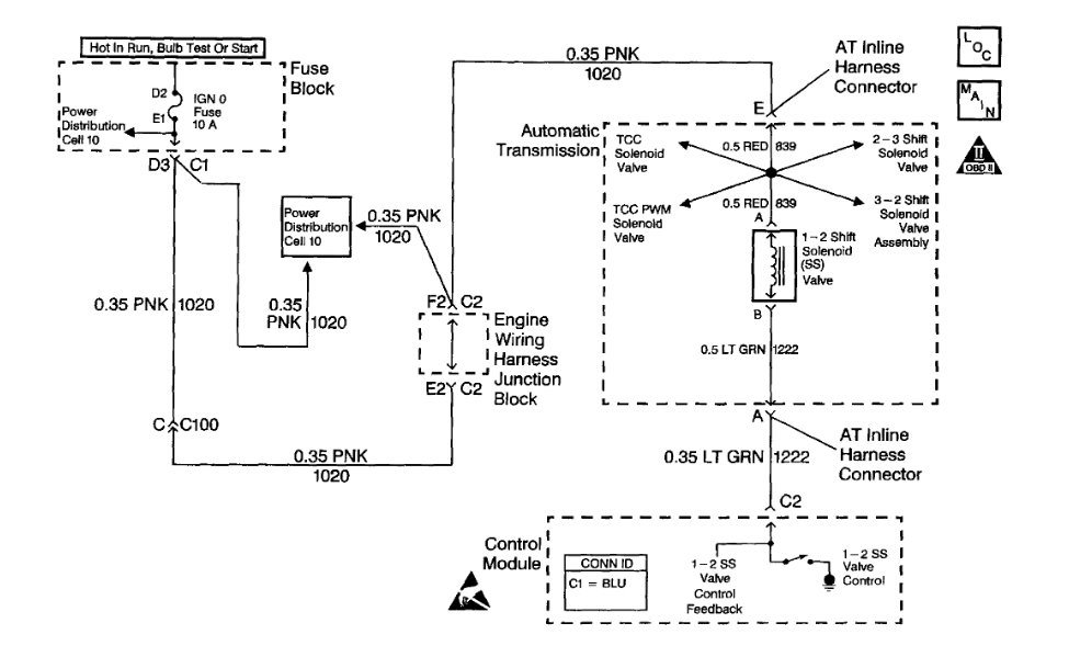

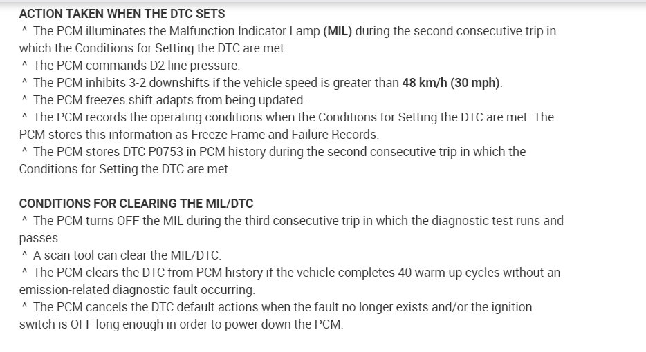

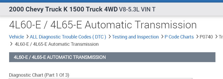

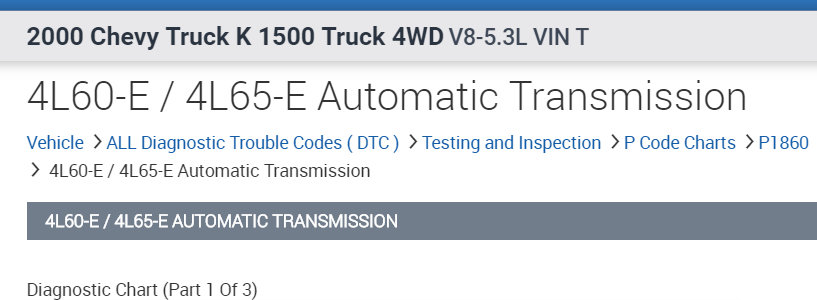

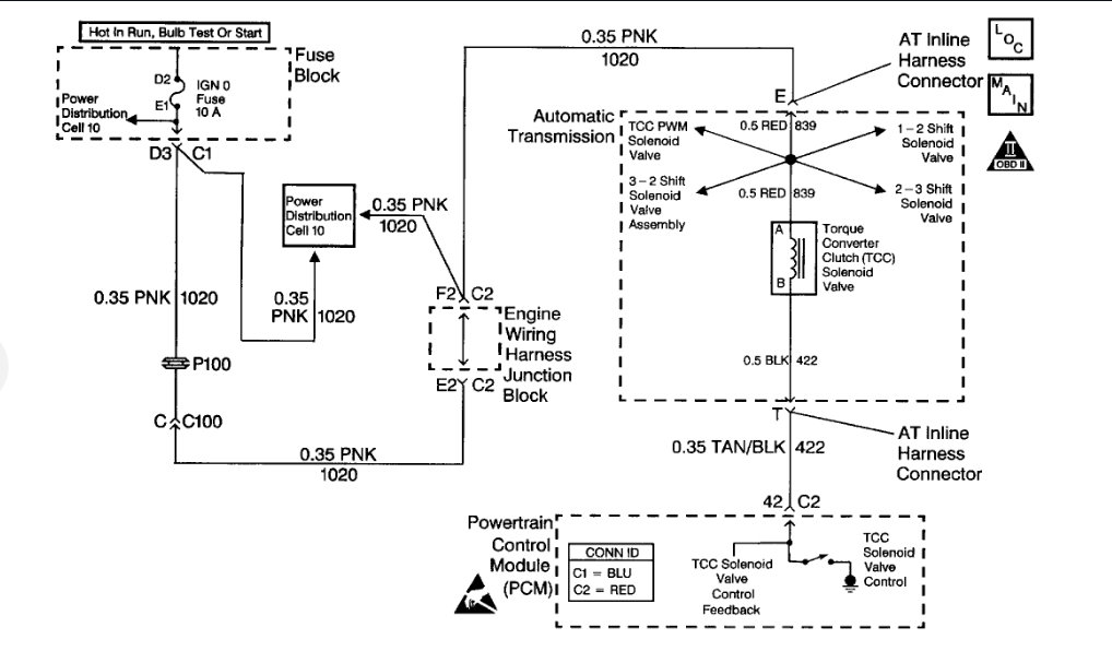

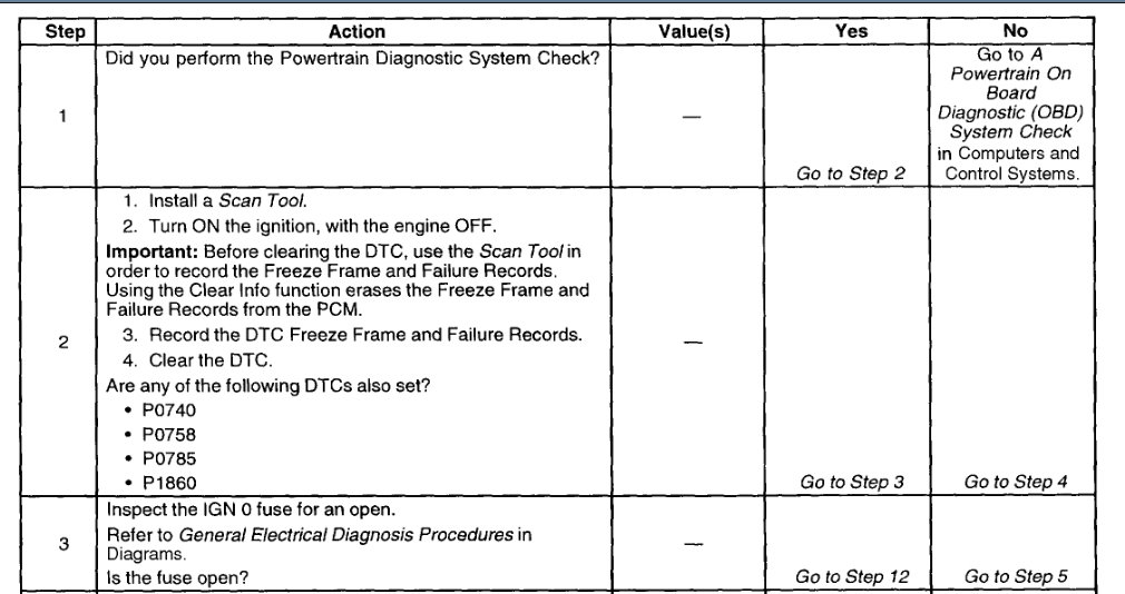

Codes p0758, p0740, p0753, p0785 and p1860
150,000 MILES • 5.3L • V8 • 4WD • AUTOMATIC
MEPHIDROSS

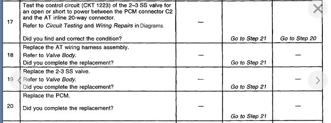

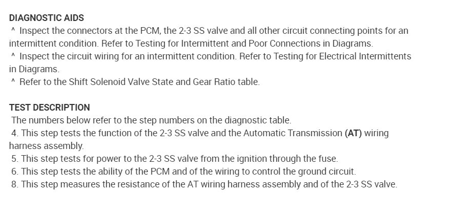

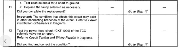

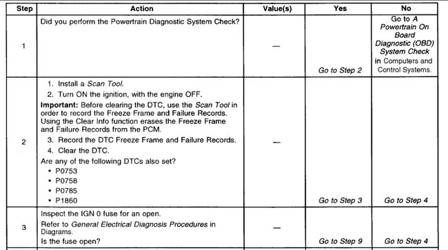

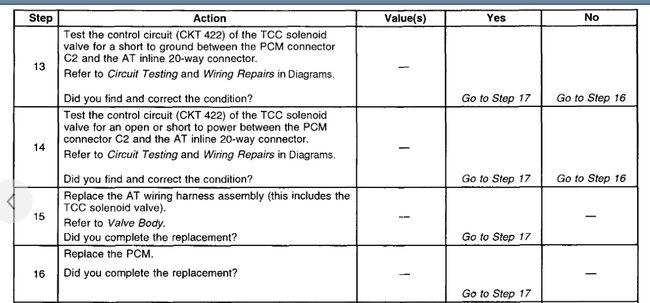

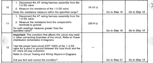

I have changed the switch because there was no power at fuse. That got power to the fuse but it still pops up those codes. It's on limp mode starts in third unless started in first manually the instrument clay works. I'm stuck and would like some advise.
Apr 27, 2019 at 3:54 AM
SCGRANTURISMO
  • 4,897 POSTS

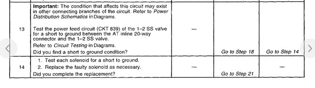

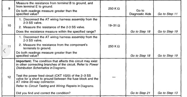

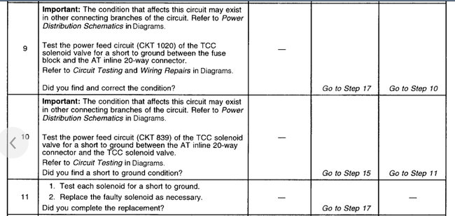

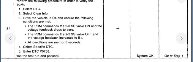

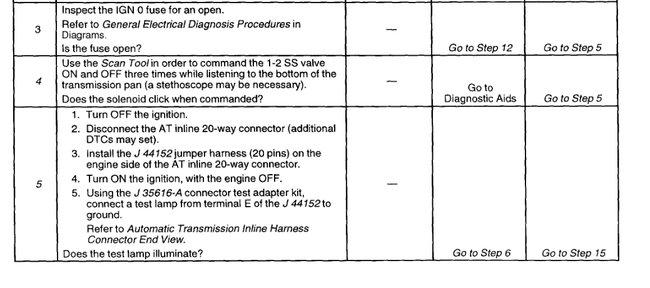

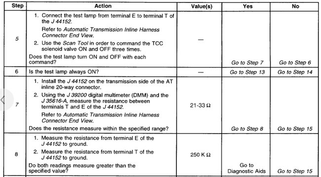

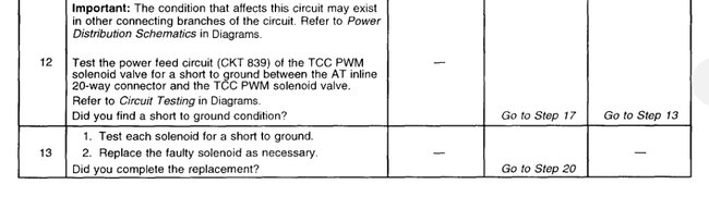

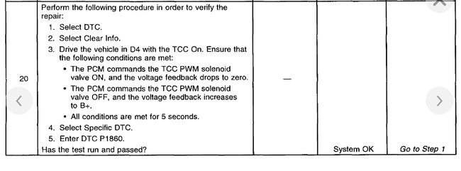

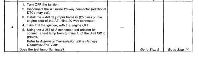

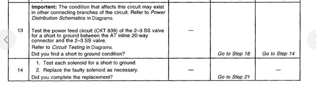

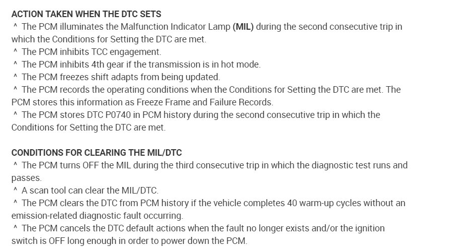

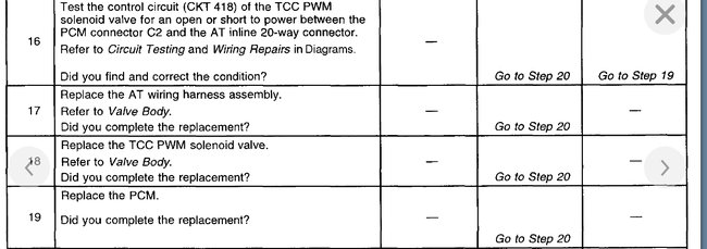

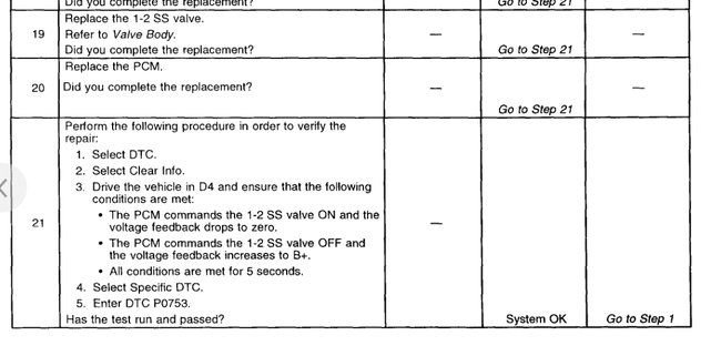

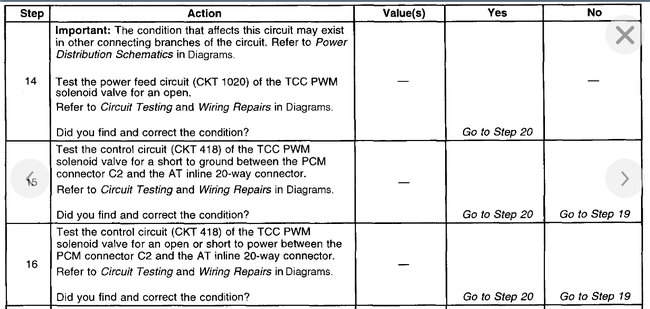

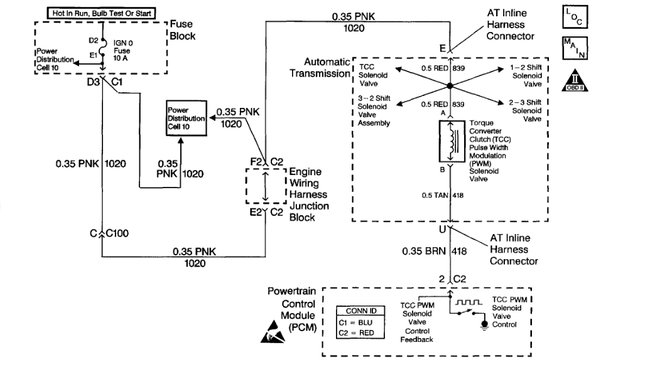

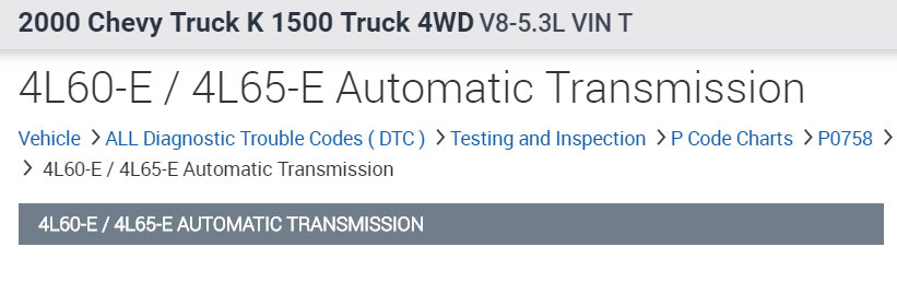

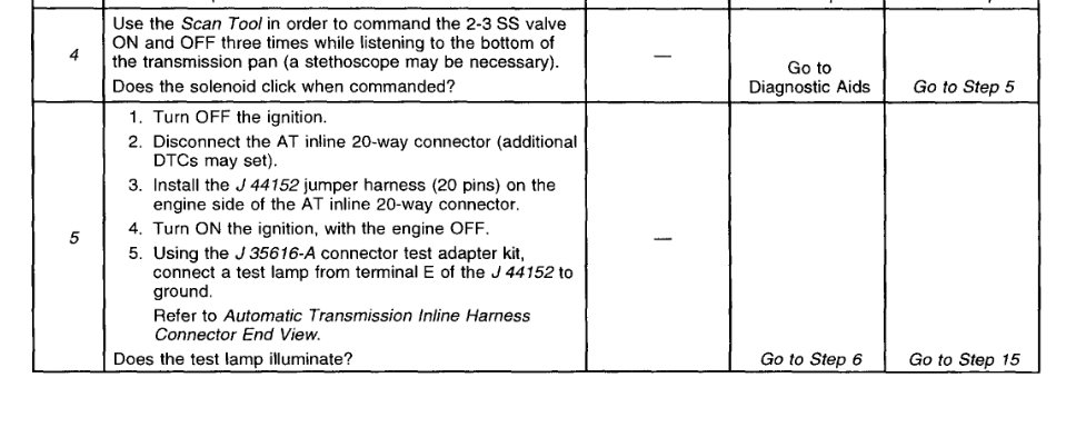

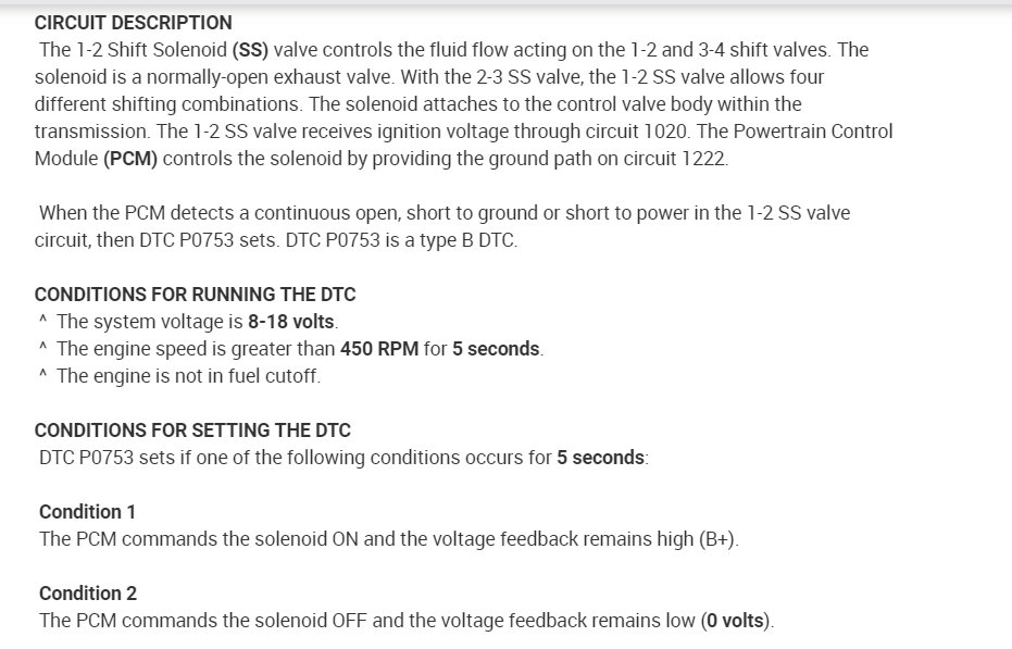

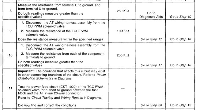

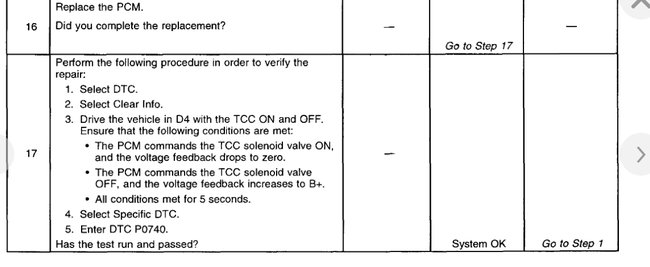

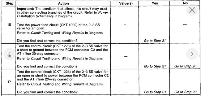

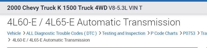

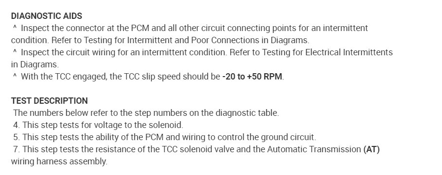

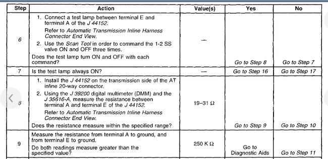

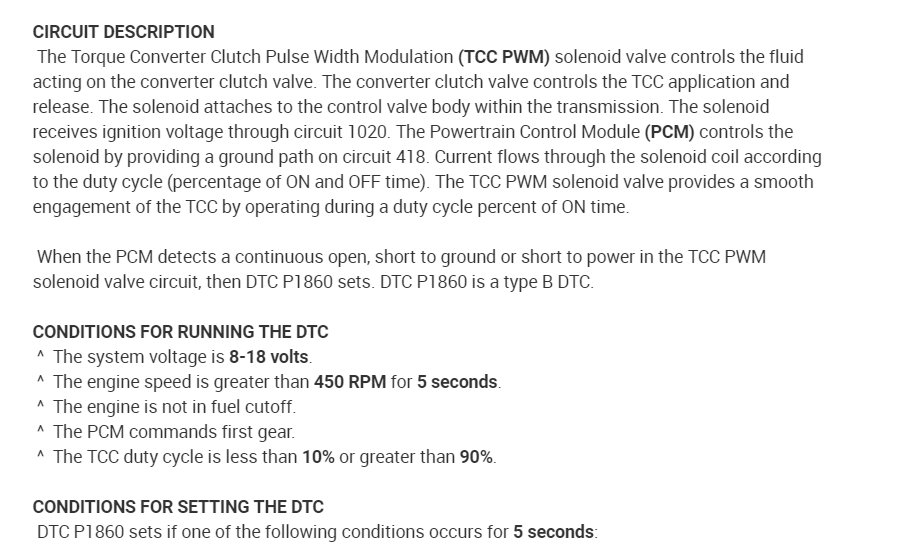

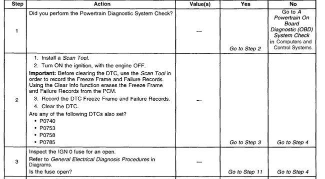

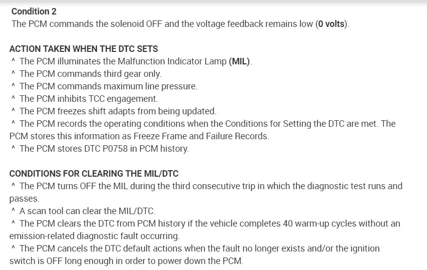

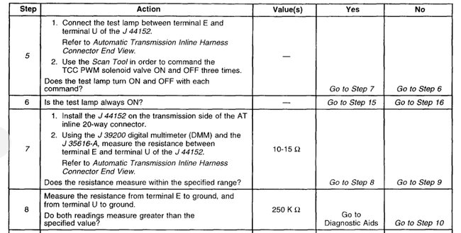

I have included all the information that you requested in the diagrams down below. I have factory diagnostic troubleshooting flowcharts for each of the Direct Trouble Codes (DTC)(s) that you listed in your question. Please go through each flowchart and get back to us with what you are able to find out, please.
Thanks,
Alex
2CarPros
Apr 27, 2019 at 6:18 AM
