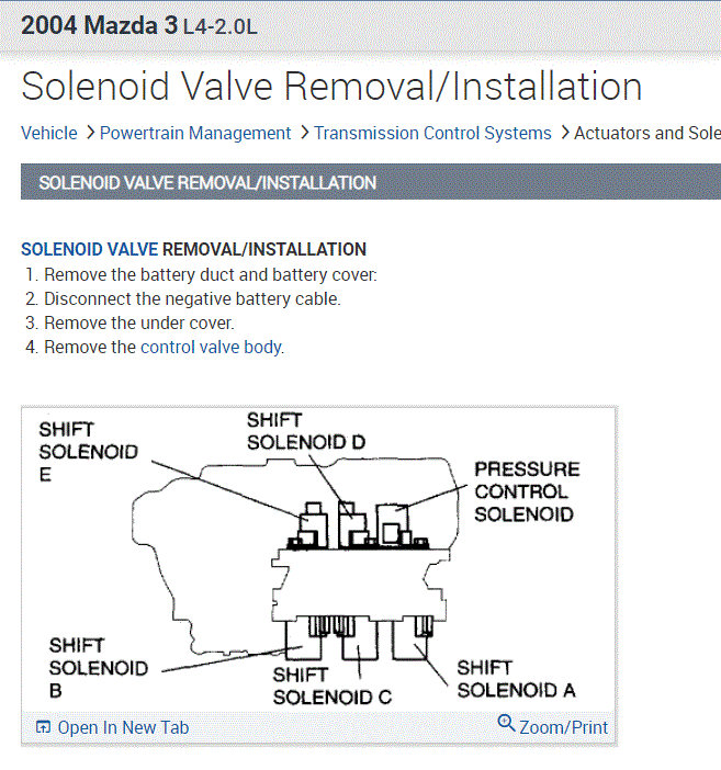

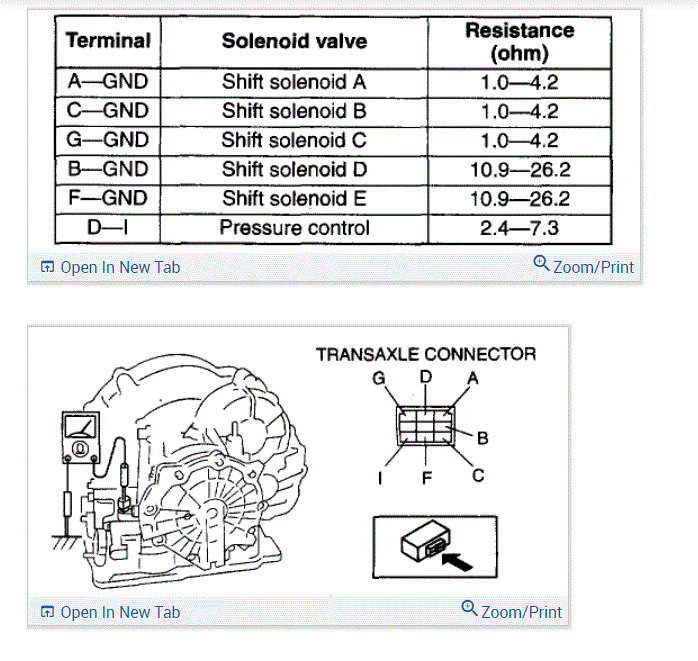

As far as shift solenoid A, you will need to remove the valve body to access it. Therefore, you need to drain the transmission again and remove the pan.

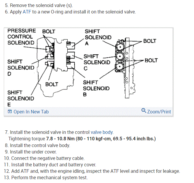

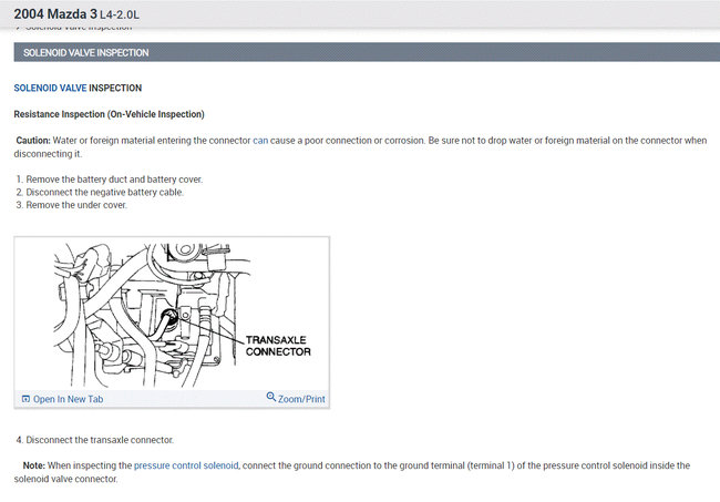

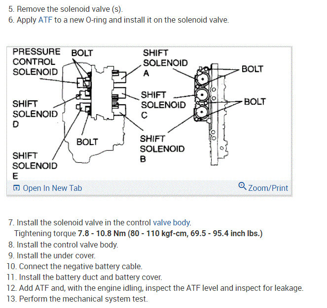

If you look at pic 1 below, it shows the SS A location in relation to the filter. Pics 2 and 3 are the directions for replacement.

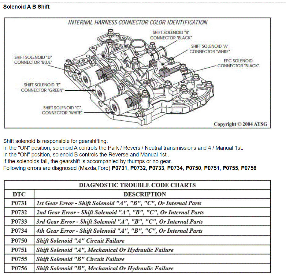

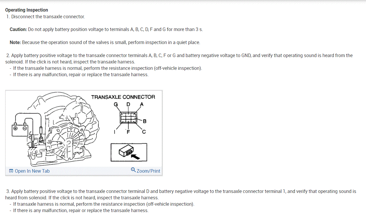

However, before you go to the trouble of replacing it, check to make sure it is actually bad. The remaining pics show the diagnostics.
As far as the part, I believe the shift solenoids are the same. It should be Mazda part number FN01-21-1F1. Check that out and let me know if it helps.

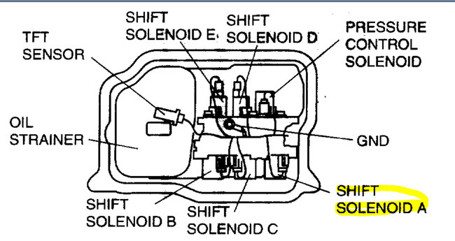

See pics below. Also, the very last pic may be helpful as well.

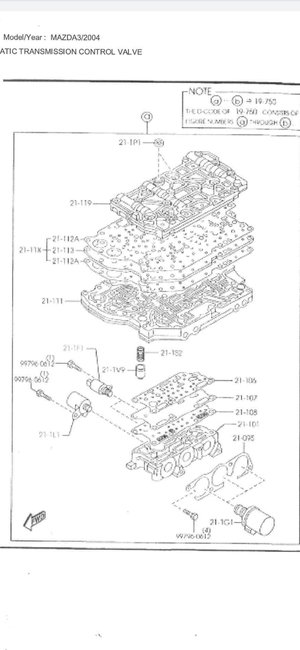

I finally had them send me their diagram for how they are seeing my transmission and solenoid placement
And after comparing a few other diagrams of my car I figured out it was 21-1g1 on their diagram at least I'm almost 100 percent positive!
The image below is the diagram they sent me so no wonder they couldn't figure out which one I was talking about, but I just feel like if you're a master mechanic at a dealership you should know what I'm telling you especially after explaining it numerous times!!!

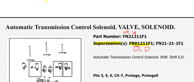

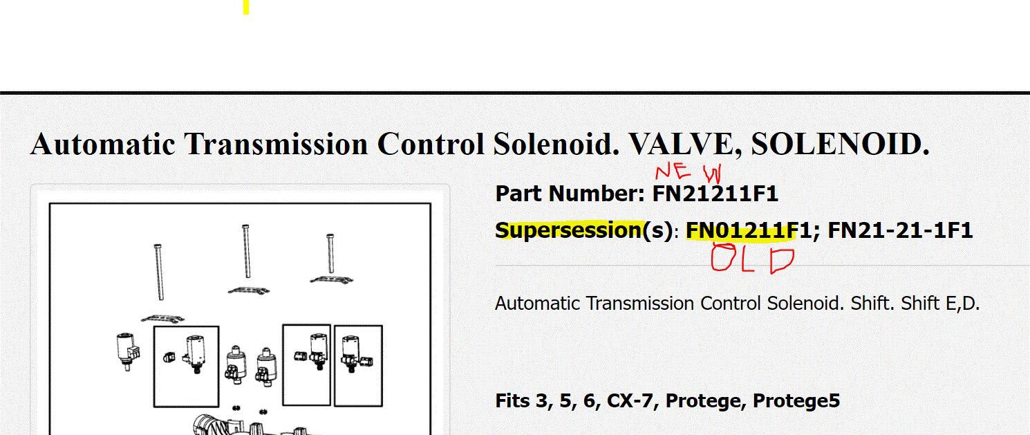

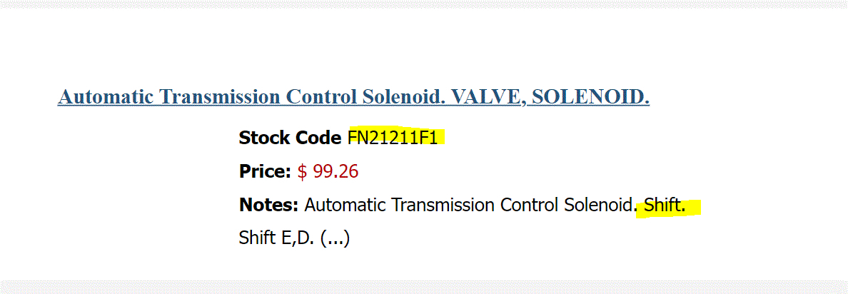

The one I found isn't listed, but there may be a new number superseding the original number. So, they don't know which one you need?
I looked up the number I sent you originally. It has a new number. See pics below. I got the pics off a Mazda website. I am waiting for a reply if Part Number: FN21211F1 is the replacement for shift solenoid A. I'll let you know as soon as I get a reply.
Hang in there. We'll figure it out. From what I am seeing, the differences seem to be how the connector is located.
Let me know if you have made any additional progress.
