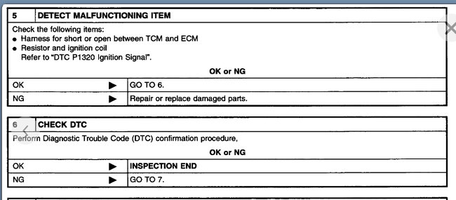

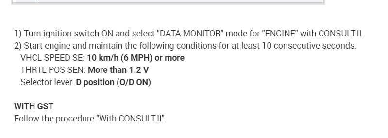

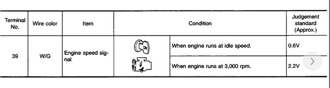

I got this code and it the only one i change the crankshaft sensors and the VSS sensor or revolution sensor. took it to a mechanic and he said the have to check the ECU or TCM for maybe bad wiring. is this true? They want $450.00 just to do that. he also said that the RPM's are showing even though my dash does not show me my rRPM's.
Apr 22, 2019 at 10:41 AM
SCGRANTURISMO
  • 4,897 POSTS

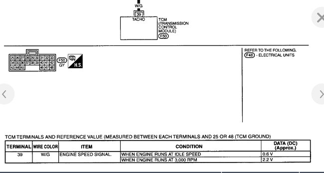

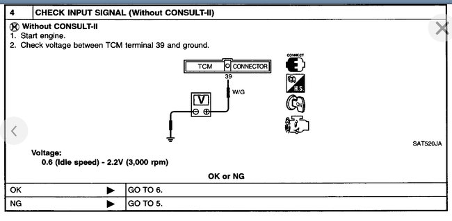

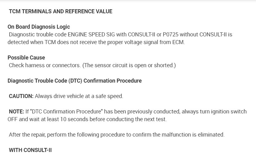

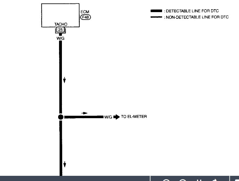

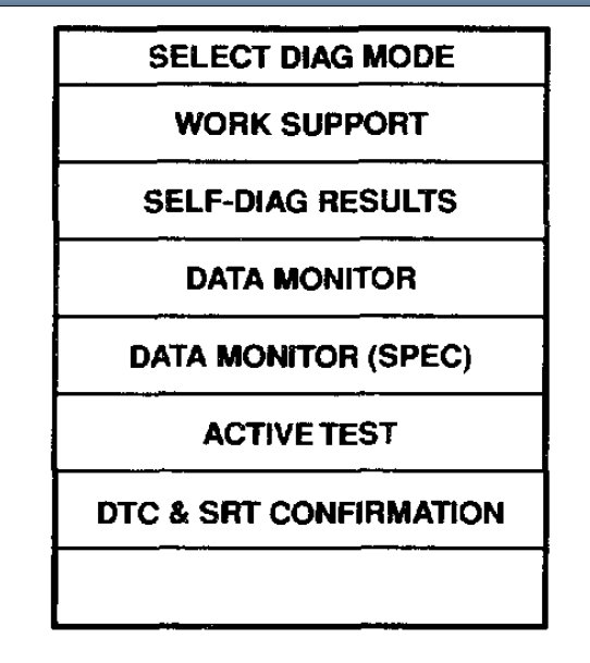

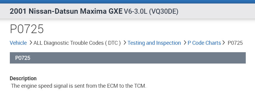

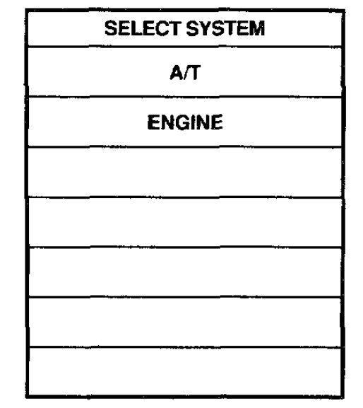

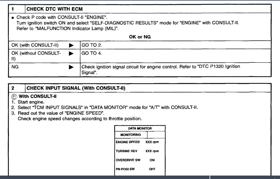

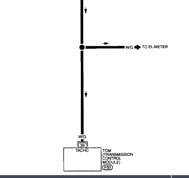

This Direct Trouble Code (DTC) is dealing with the engine speed signal that your vehicle's Power-train Control Module (PCM) sends to your vehicle's Transmission Control Module (TCM). I have included the factory's diagnostic troubleshooting guide for you to go through in the diagrams down below. Please go through this guide and get back to us with what you are able to find out, please.
