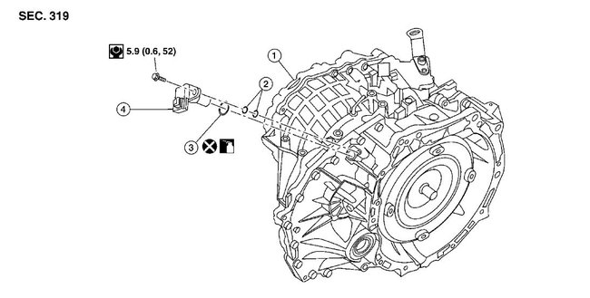

I scanned my car and the code p0720 came up. It says the transmission speed sensor. I would like to know where is the transmission speed sensor is located? Would you happen to have a diagram of it?

This code indicates the output speed sensor reading is missing. I would verify there is power and that the connector is not damaged.

Secondary Speed Sensor
P0720 OUTPUT SPEED SENSOR
Description
The secondary speed sensor detects the revolution of the CVT output shaft and emits a pulse signal. The pulse signal is sent to the TCM, which converts it into vehicle speed.
