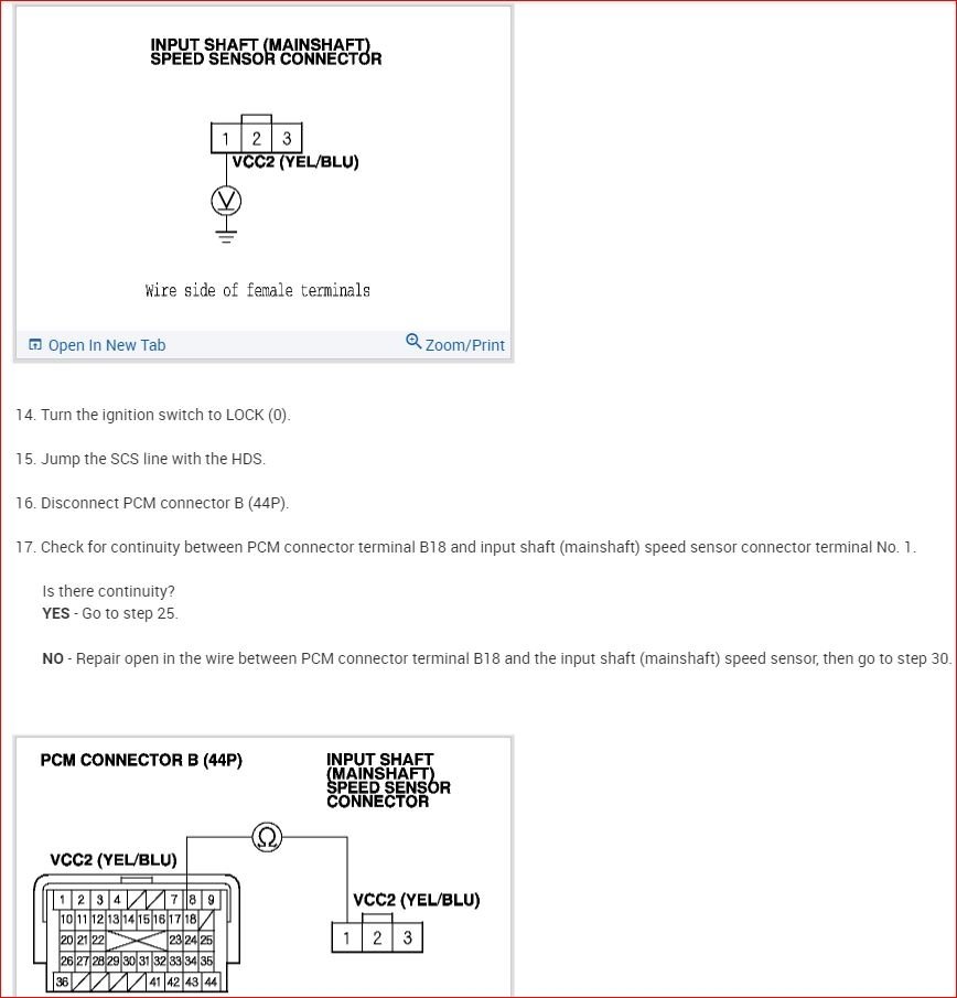

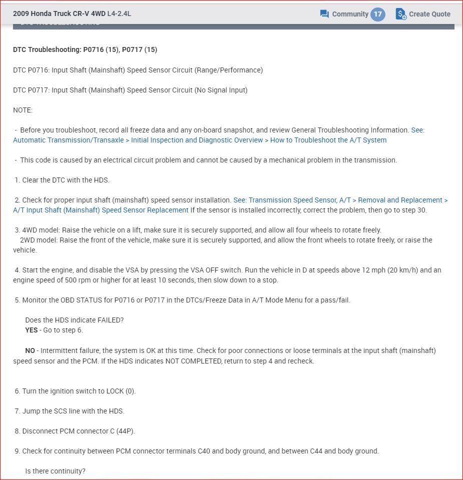

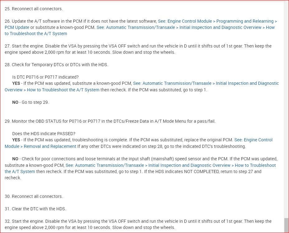

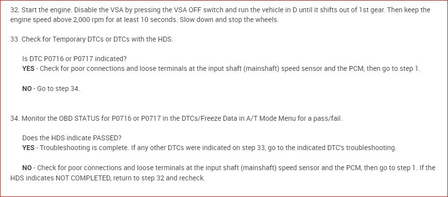

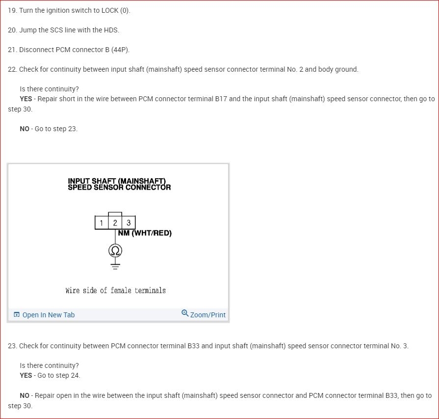

Car starts fine and shifts normal up to 20 miles per hour. Instead of continuing to accelerate it disengages from transmission and revs engine as if in neutral until the speed drops below 20 mph then it's normal again until it reaches 20 mph. It's showing a P0717 code followed by 61-1 and 83-1.
Jun 12, 2019 at 6:53 AM

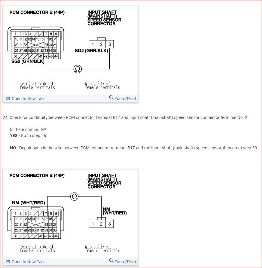

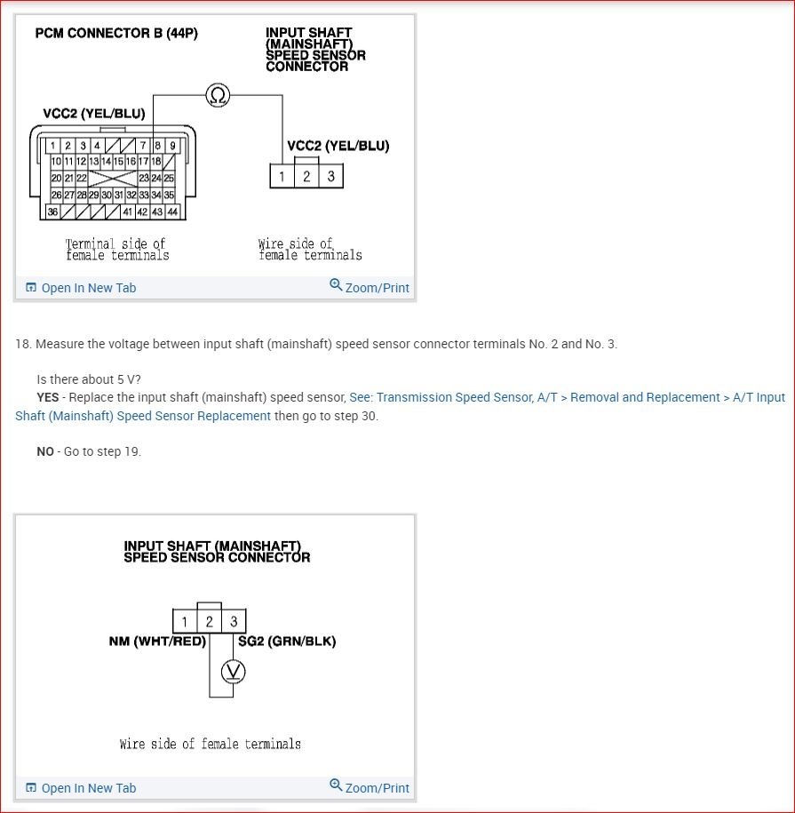

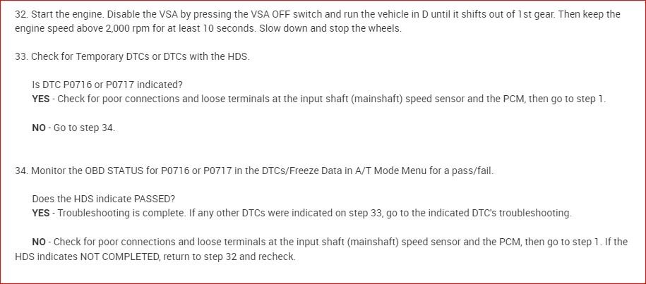

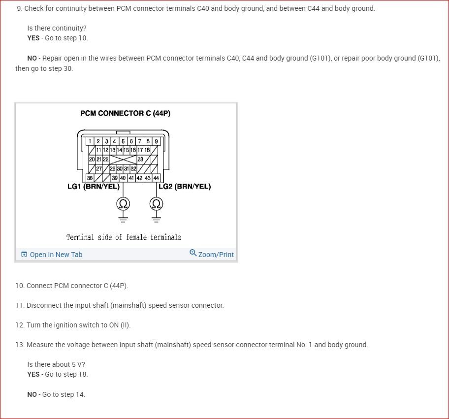

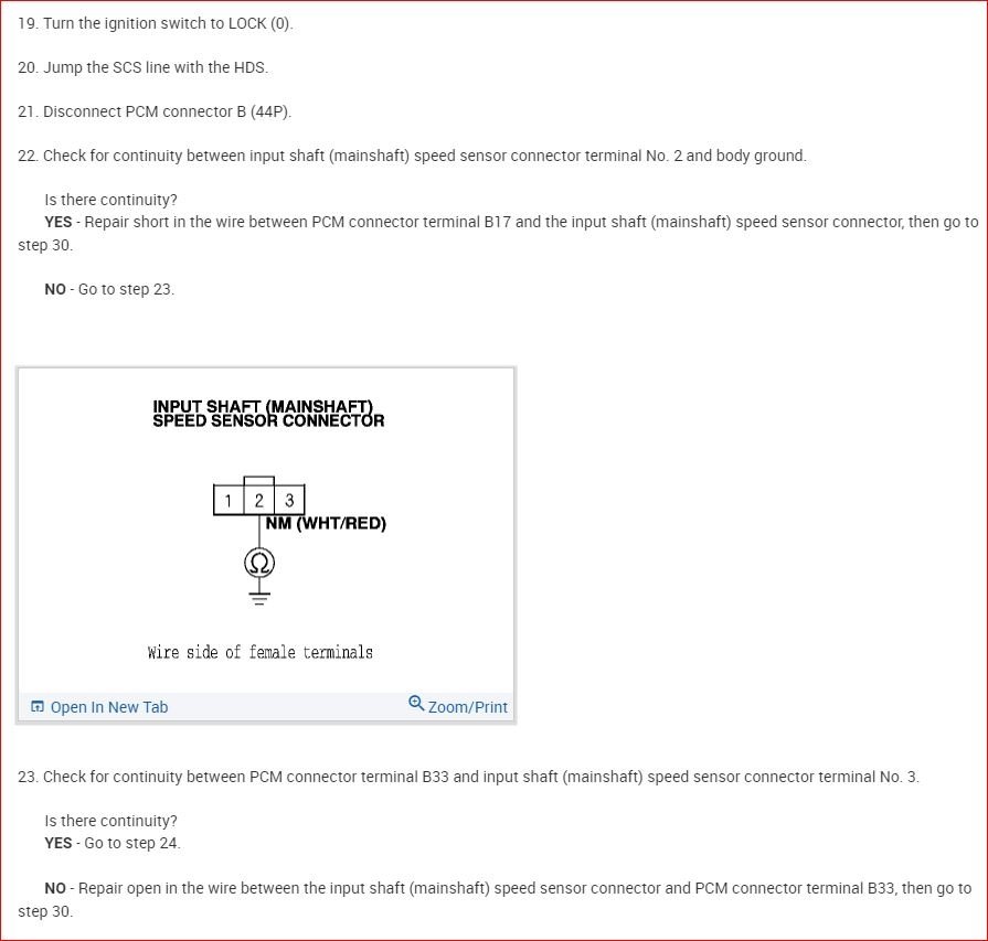

Hi Pickone,
The vehicle is shifting like this because it is losing the speed sensor signal so it does not know which gear to shift into.
I attached the test to determine what is causing the speed sensor issue. Please let me know if you need any more assistance as you work through this.

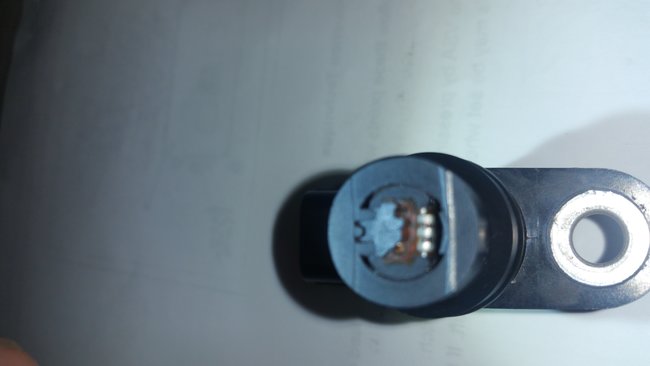

Thanks for the test parameters. The picture is the pickp end of the bad sensor. My concern is the potential amount of material that seems to have rubbed or broke off the end. I could hear a faint noise that sounded like a heat shield rattling but inside the tranny near where this sensor came out. Any recommendation as to dealing with any plastic or metal that may have gotten inside. When I find the correct sensor I'll have a better idea how much was missing off the old one. I'm also drawing a blank on how it broke the end like that. It's not supposed to touch.
Jun 17, 2019 at 7:11 PM
You are correct that they are not to touch but when you get the new one, you will want to see how it compares to this one. Normally this happens when they install the wrong sensor and it is a bit to long and it wears against the trigger wheel. If it is the same, they may require a spacer ring and the last person didn't install one so it was too close to the trigger wheel.
As for the plastic that may be left inside, normally this will make its way to the pan and remain there. If it is a material that is softer then metal, then it is normally ok. If it is metal then it could cause issues. Unfortunately, there is no way to know unless there is an issue. The only way to get it out is to go in and remove it. I would not recommend this unless there is an issue after you get it back on the road.

Well I put a new sensor in and the car started normal and as soon as I put it in gear the tinny sounding rattle stopped. I drove it and it shifted from first to second gear but as soon as it hit 20 plus mph it disengaged and the engine revved. Below 20 and it would pull it down the road. After test drive I pulled the new sensor and it was destroyed like the original one.
I got a used one from another transmission and put it in with maximum amount of spacers and it didn't read it. I dropped it down one spacer and it wanted to run better (almost 30 plus mph) but wouldn't shift into third gear. At 30 it disengaged. At that point I pulled both speed sensors and found the input sensor (short one) still physically in good shape but on the output sensor (long one) now had a slight scrape mark across it. Also there was a bit of metal shavings on both. More on the input sensor. My daughter and I looked at eleven CRV's before we bought her this one (it's her second one) and we both thought it seemed to shift smoother than all the others. Do I need to replace this transmission after she's only drove it 3,000 miles in the three months she's had it?
Jun 23, 2019 at 6:38 AM
The metal in the sensors is the only thing that concerns me to point to a new unit. This metal is coming from somewhere and it doesn’t repair itself.
As for the damaged sensors. The only way that happens is either the sensor is wrong, installed wrong, or there is something on the tone wheel causing damage to the sensor.
Where are you getting them from and do you have a part number they are giving you for each one? I want to try and check to see if they are giving you one for the wrong unit or something silly like that.
