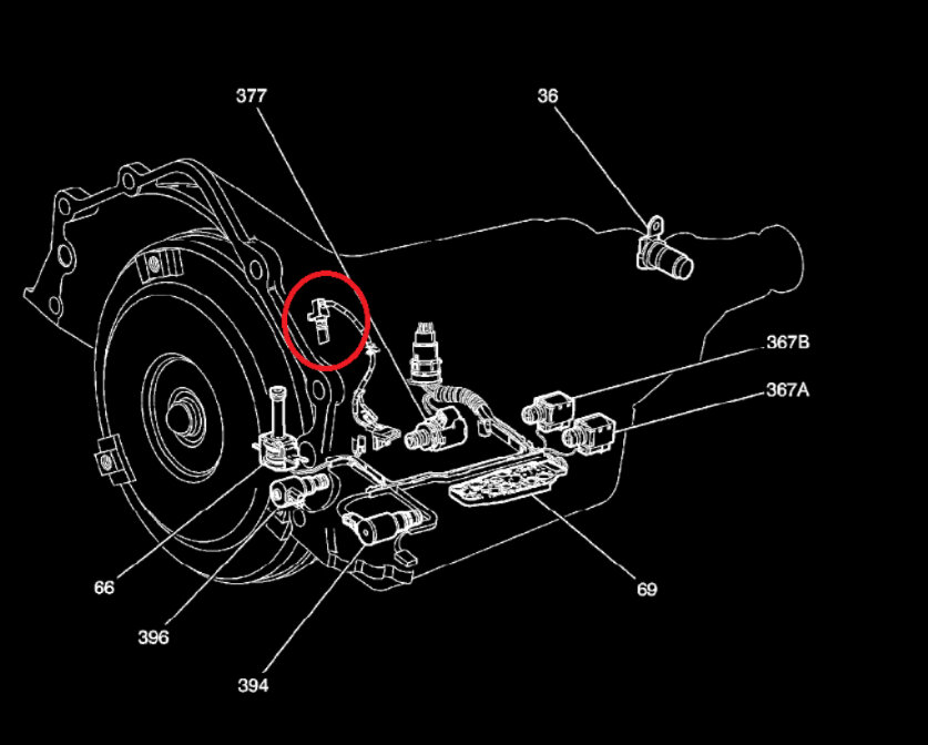

I am trying to find the transmission input speed sensor on a the truck listed above 1500. Can anyone show me where it is in a photo or diagram and describe how to access it? I have been trying to locate it for 2 days now. I cannot find anything on Google images or YouTube that helps locate it. Thanks in advance.
Oct 12, 2022 at 8:56 PM
BORIS K
  • 836 POSTS

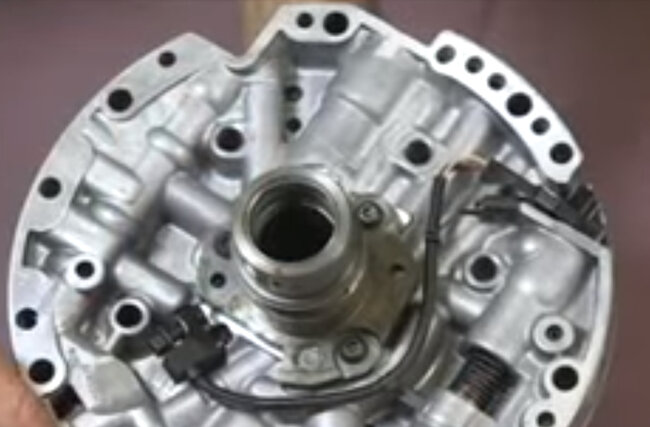

On the 4L60E transmission (4 speed) the input speed sensor is located in the pump stator housing, see pictures below. To access this sensor the transmission requires a strip down.
A good video:
https://youtu.be/dbVYrR1xoCc

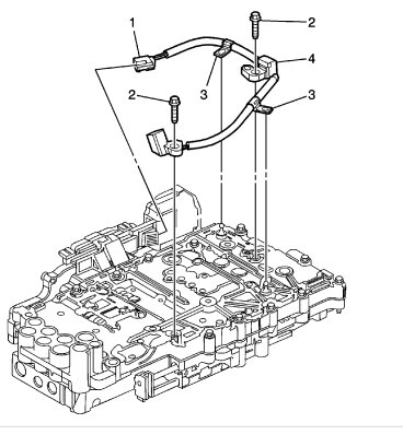

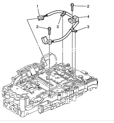

On the 6L80E(6 speed) the speed sensors are located above the valve body
See image 3.

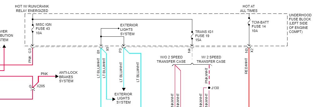

A quick follow up question. Since a strip down of the transmission is required to replace this sensor I have been looking at other potential causes in the off chance there is another solution. I noticed that in the fuse box under the hood there is a spot for a tcm batt fuse. There is no fuse present in this spot. Should there be a fuse here or is it not used.? It's spot #14 and it's empty.
Thanks in advance.
Oct 15, 2022 at 10:59 PM
BORIS K
  • 836 POSTS
Fuse 14 should have a 10A fuse fitted, see image below.
