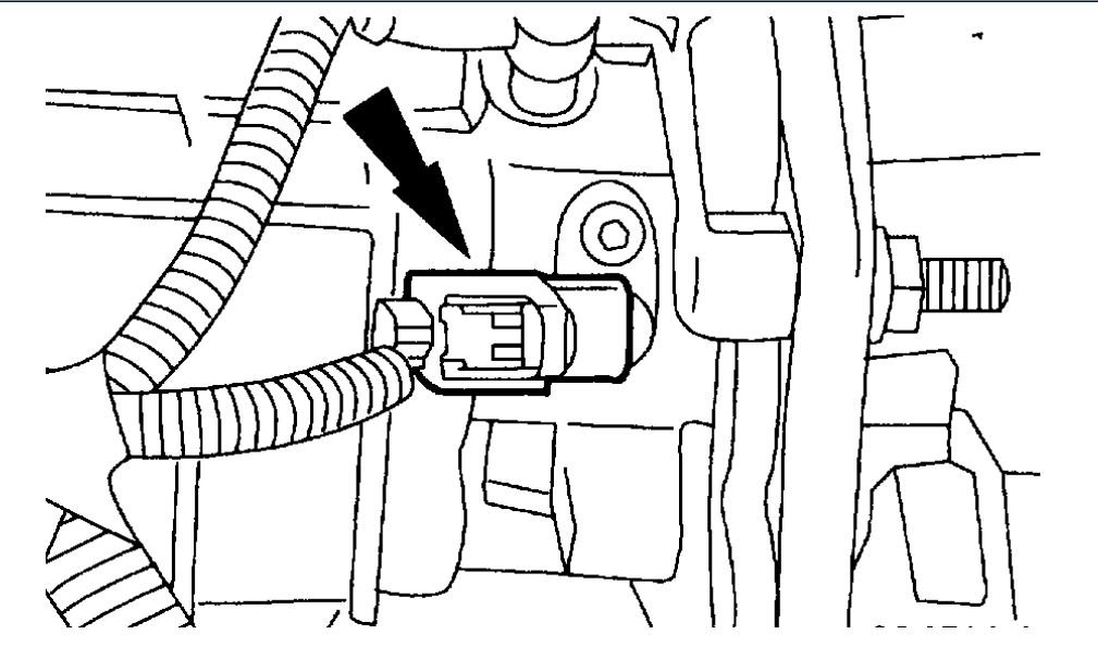

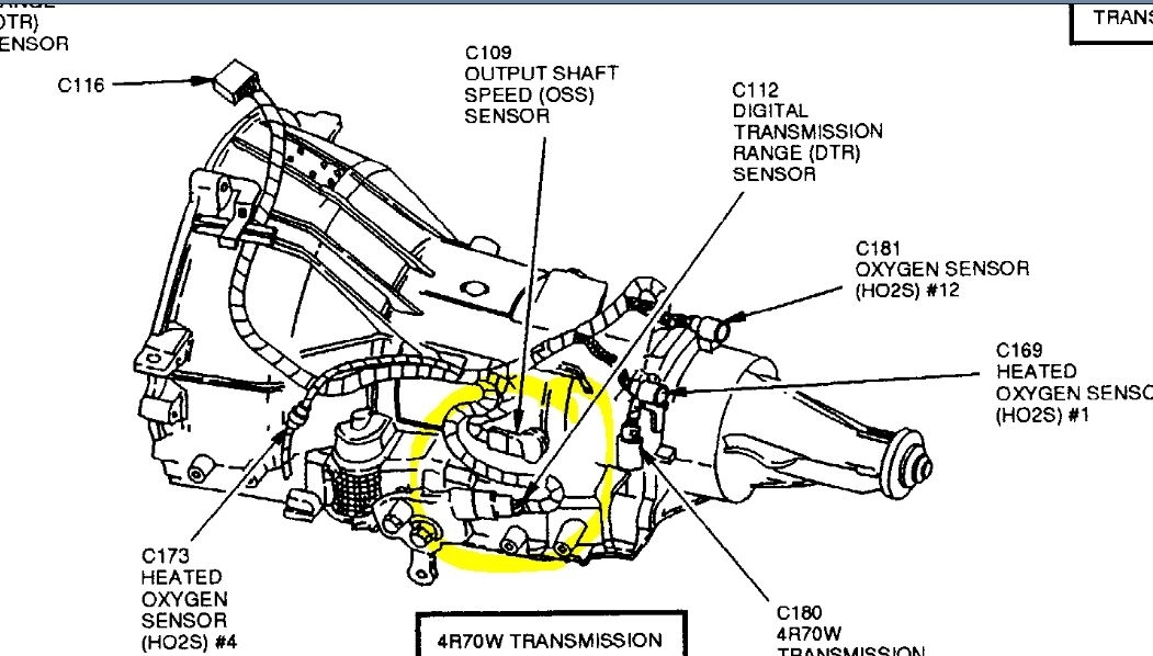

Got code P0715 - speed sensor
where is it located and how can it be replaced?

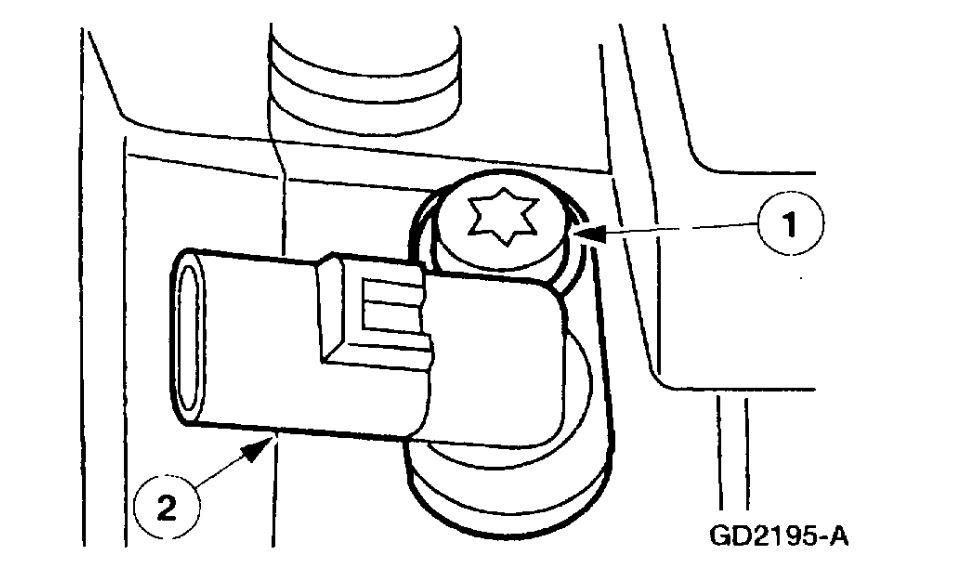

The procedure is below and pictures as well.
What symptoms do you have with the transmission?
REMOVAL
1. If equipped, turn the air suspension switch off.
2. Disconnect the battery ground cable.
3. Raise the vehicle on a hoist.
4. Disconnect Output Shaft Speed (OSS) sensor electrical connector.
5. Remove OSS sensor.
1 Remove the screw.
2 Remove the OSS sensor from the transmission.
- Inspect the OSS sensor O-ring for damage. If damaged, replace the O-ring.
