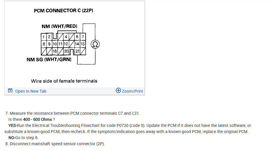

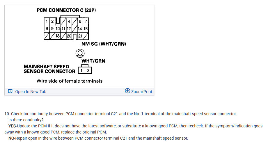

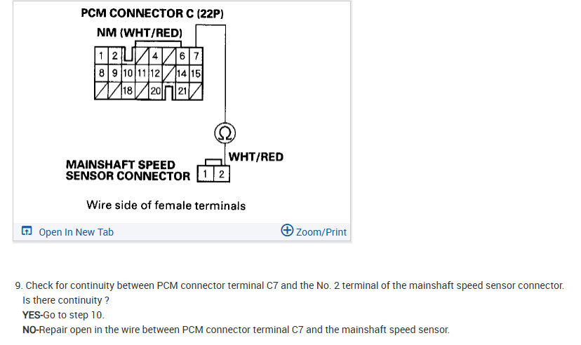

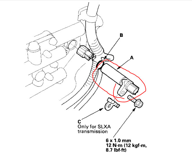

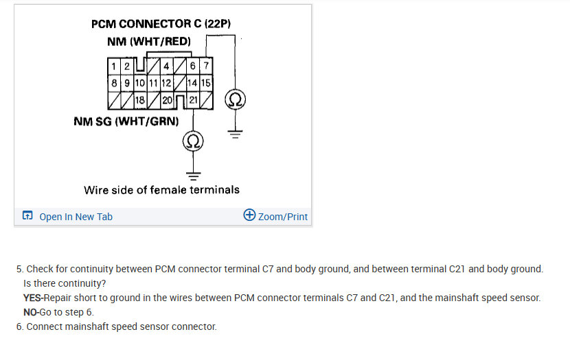

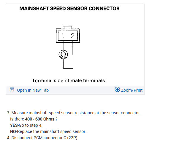

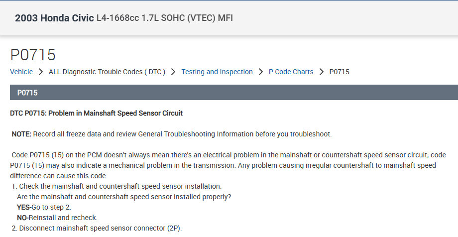

I have the car listed above Ex model coupe. I got a P0715 code with the following description: "Cvt Input Shaft (Drive Pulley) Speed Sensor Malfunction". I am wondering what it could be.
Jun 23, 2025 at 5:00 AM
  • 110,248 POSTS
As far as the code is concerned, it is related to the transmission's main shaft speed sensor. Chances are it is the sensor, but it could also be a wiring related issue.
I attached the diagnostics below. I'm not familiar with your abilities, so you may look at them and not want to attempt it. However, I wanted to add them in the event you are comfortable.
The last pic I attached shows the sensor. It is on the side of the transmission.

Sorry for the late reply, I did get the main shaft speed sensor installed. I seem to have clear the code. I am wondering if I should just continue with my regular maintenance with a peace of mind or get it full inspection since the vehicle is extremely old?

I would change the transmission fluid and use the Type Honda ATF-Z1 fluid only, some of these cars have an external filter, please go over this video so you can see what I am talking about.
https://www.youtube.com/watch?v=pHPkHP4m0SM&pp=0gcJCb4JAYcqIYzv
If everything works good and you have no warning lights, you should be good to go :)
