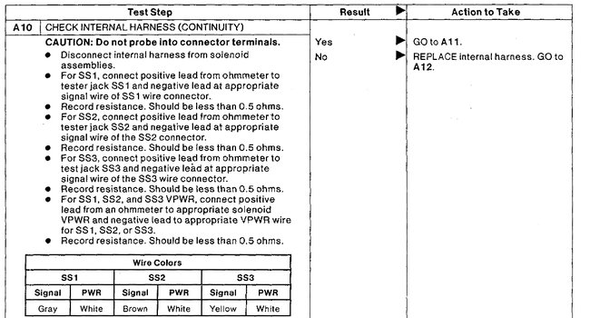

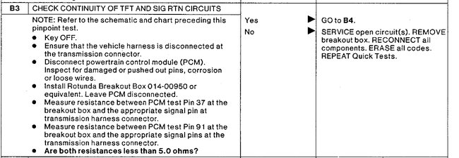

My truck started shifting strangely so ran a test on it, got code P0709. Replaced transmission position sensor and still acted up. I took it to Ford and had a friend run a test and he said it was the neutral switch sensor so I replaced that and it still acts up. it only acts up sometimes and only when slowing down or taking off, not in higher speeds. Could it be the wiring?

SCGRANTURISMO
  • 4,897 POSTS
Hello again,

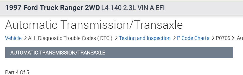

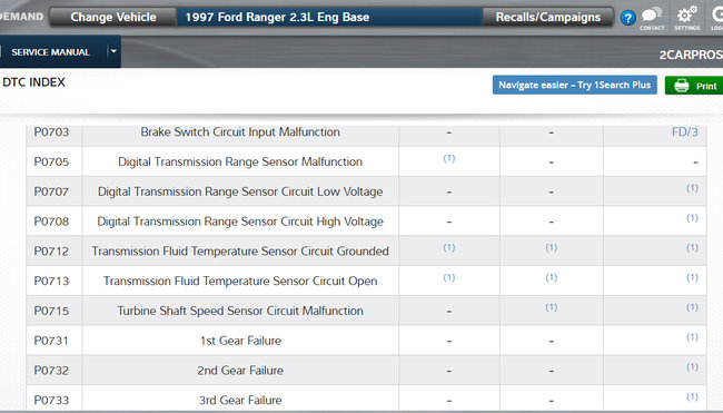

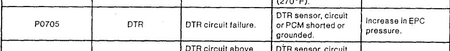

I have included in the diagrams down below the Direct Trouble Code (DTC) list from The Ford Motor Company for your vehicle from DTC P0703 - DTC P0733. I do not show DTC P0709. Please double check for me again. I would love to help, but if I don't know what's wrong, I can't fix it.
Thanks,
Alex
2CarPros
Apr 10, 2019 at 7:06 AM

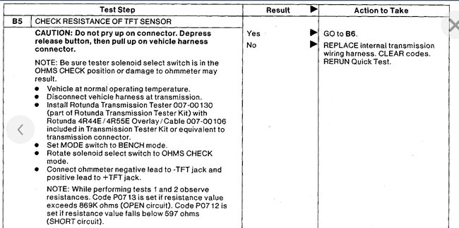

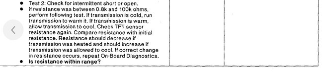

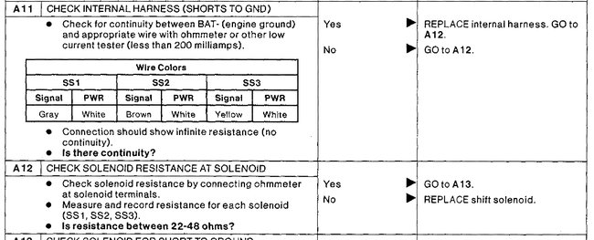

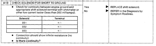

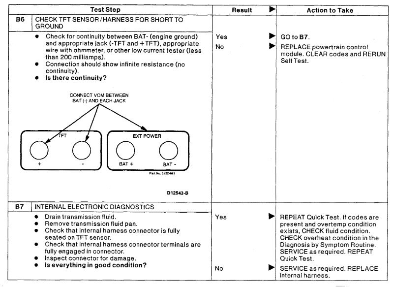

LUDOO2818
It's P0705.
Apr 10, 2019 at 7:39 AM
LUDOO2818
Transmission position sensor, which was replaced and the neutral safety switch was replaced also.
Apr 10, 2019 at 7:41 AM
SCGRANTURISMO
  • 4,897 POSTS

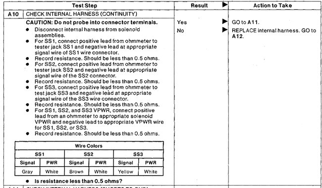

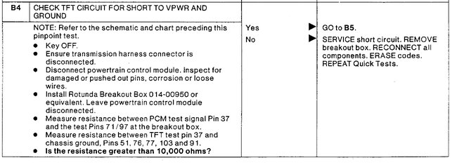

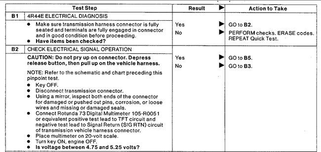

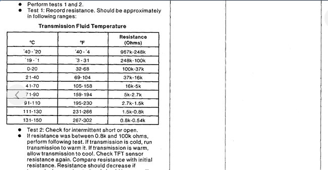

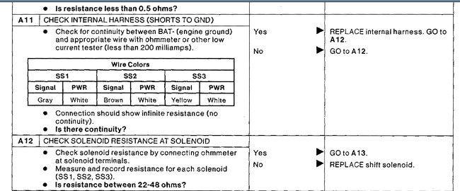

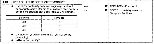

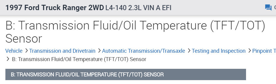

I have included in the diagrams down below the Ford factory diagnostic troubleshooting flowchart for this DTC. Please go through this flowchart and get to us with what you are able to find out please.
