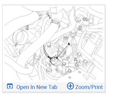

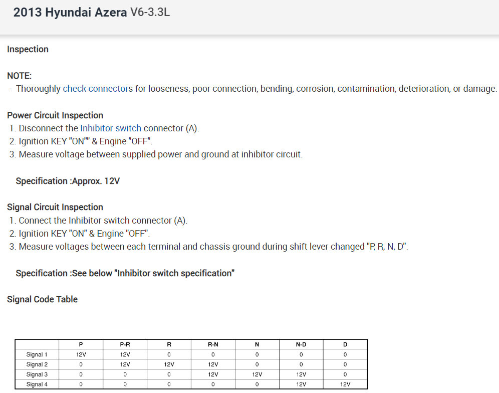

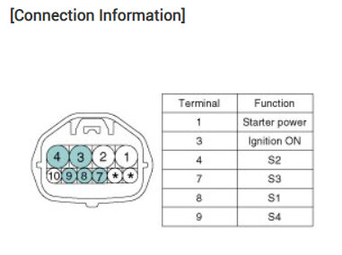

So, with these codes it can make it so the transmission will not work, especially the first code.
P0705 - Transmission Range Sensor Circuit Malfunction (PRNDL Input)
P0685 - ECM/PCM Power Relay Control Circuit /Open

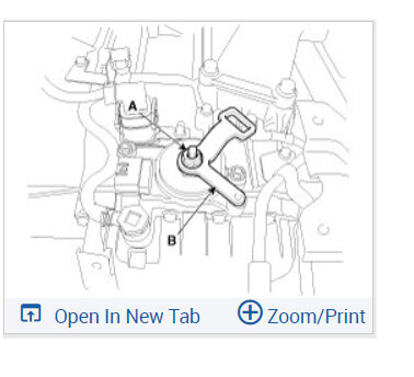

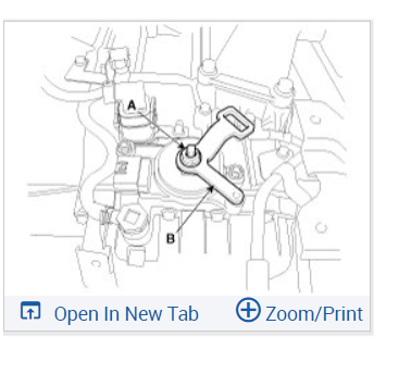

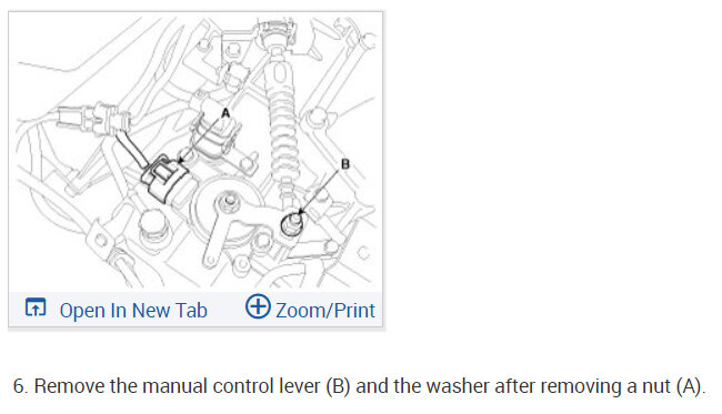

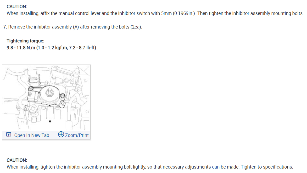

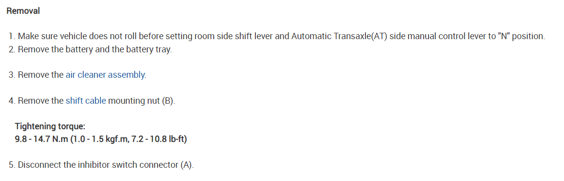

The first thing I would do is make sure the system grounds are connected and the gear range sensor is plugged in, here is the location so you can check it out. Check out the images (below). Please let us know what happens.
Jun 25, 2024 at 6:57 AM

Thanks for your answer, i changed the Transmission Range Sensor but the problem still. When i checked the oil in AT i don't found oil!!!

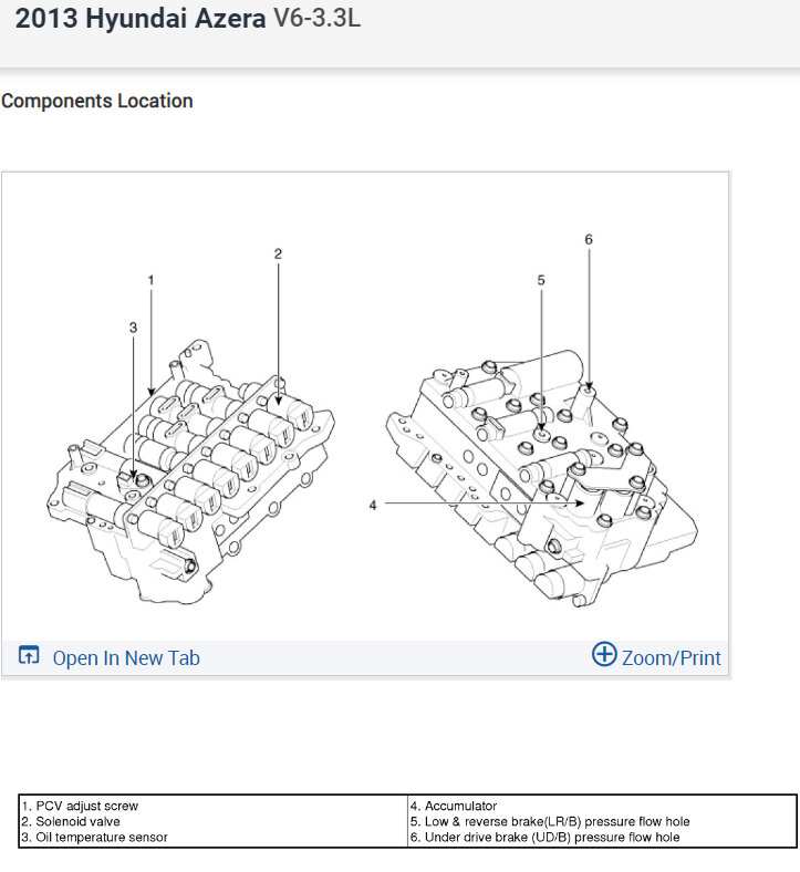

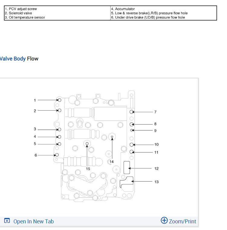

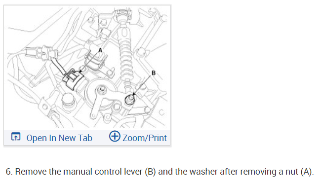

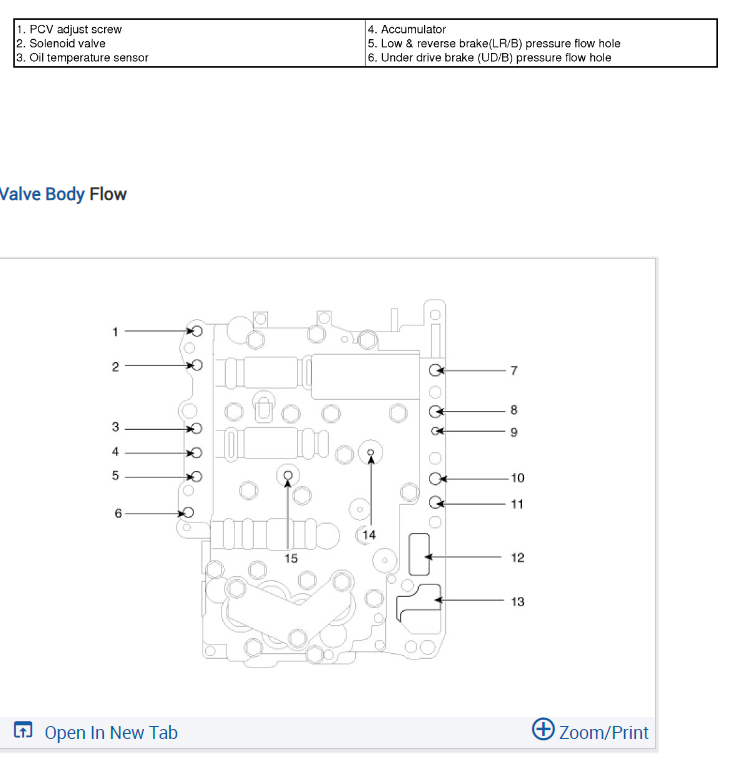

It sounds like the torque converter has fallen apart internally. But we can try the replace the valve body solenoids to see if that helps. Can you upload a short video of what the problem is? Check out the images (below). Please let us know what happens.
