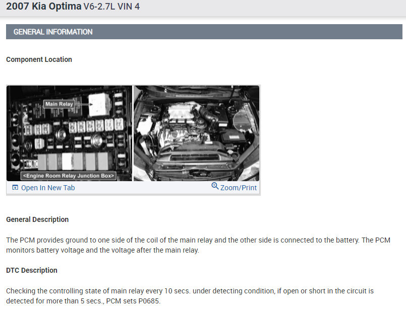

Have you already checked the main relay under the hood (see picture below)?

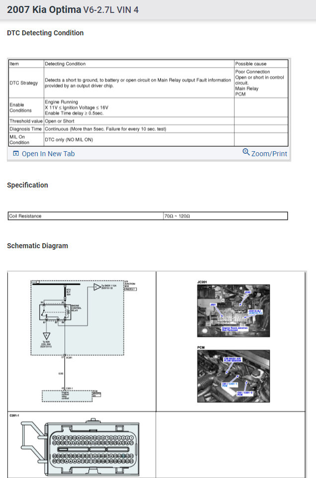

I have also attached the basic diagnostics for the code P0685.
Please note that code can be also for having bad wiring for that circuit, corrosion or having a short.
Please let me know what you got.

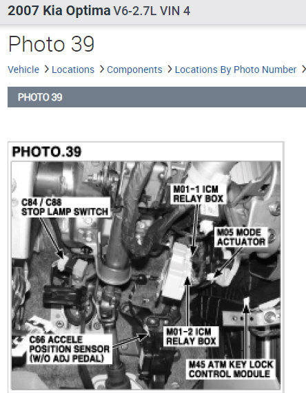

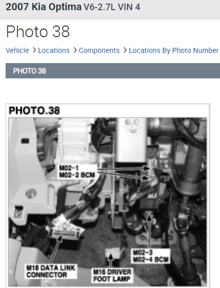

I’ve tried everything diagnostics says it’s the relay underneath the dashboard but I’ve tore my whole car apart and still can’t find where the second relay inside the car is.

I called Kia dealership and they say there are two. one behind the dashboard and one underneath the hood.
Sep 12, 2021 at 9:46 PM
SQM
  • 6,383 POSTS
Interestingly I do not see the one under the dash on Alldata.
