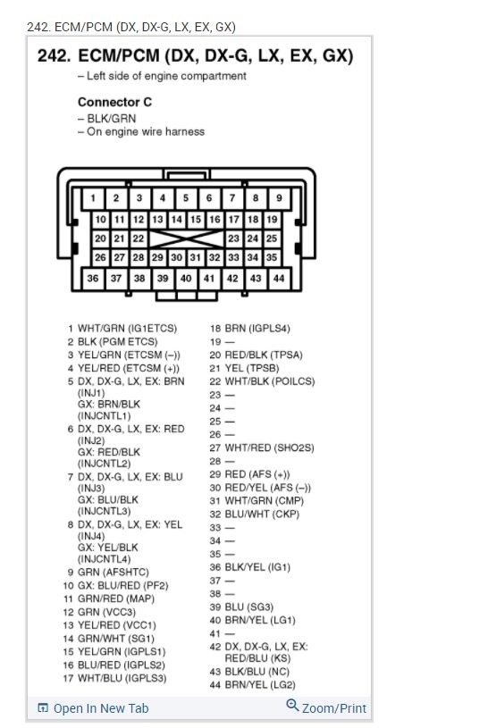

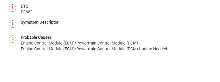

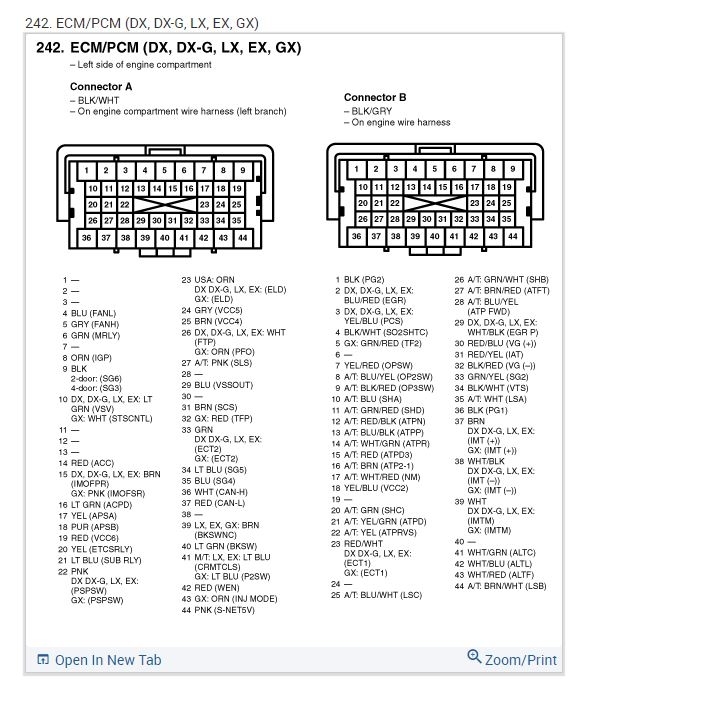

Hi, just want to know where to start a troubleshooting, i got a code P0685 PCM/ECM power relay control circuit/open.
Apr 3, 2021 at 2:09 AM
Good afternoon,

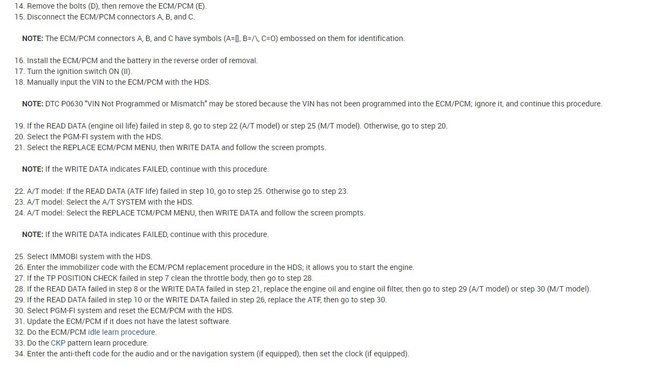

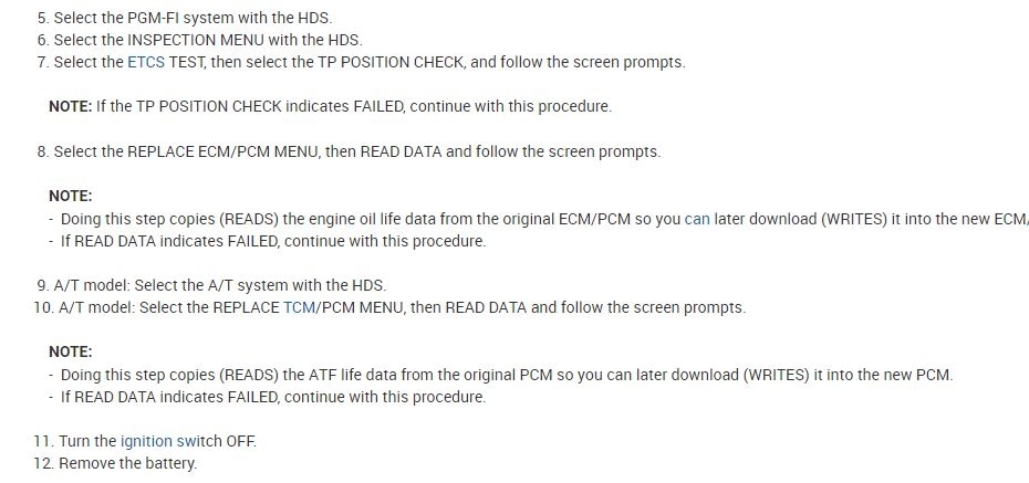

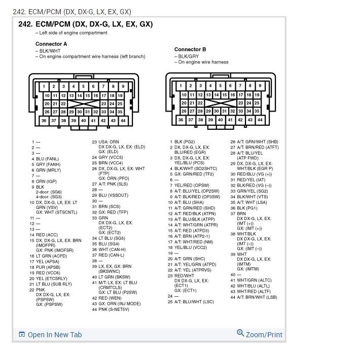

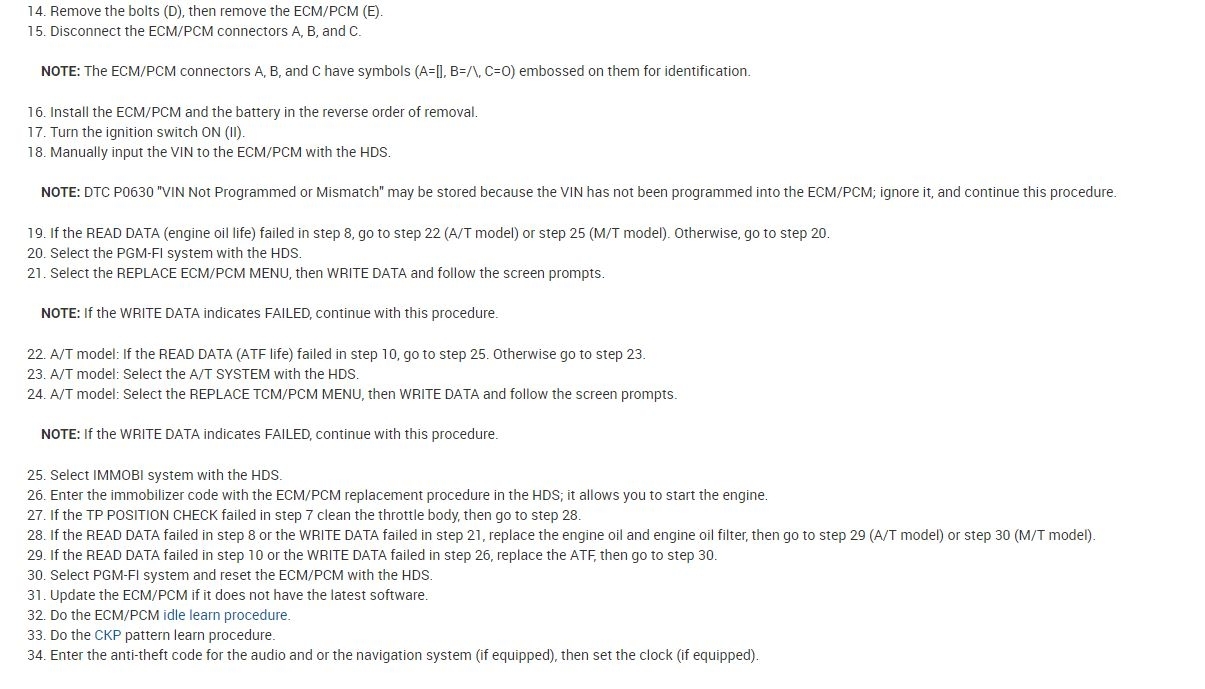

Does the check engine light come on with the key on? If the light comes on, then most likely you have power to the ECM. I attached the connector diagram for you to view to verify power to the ECM.
The code indicates an ECM failure.
Apr 4, 2021 at 6:15 AM
MARK87
  • 61 POSTS
Yes, the check engine light comes on with the key on.
Apr 4, 2021 at 1:40 PM
Okay, then most likely the ECM has failed since the light comes on and you can communicate with it.
