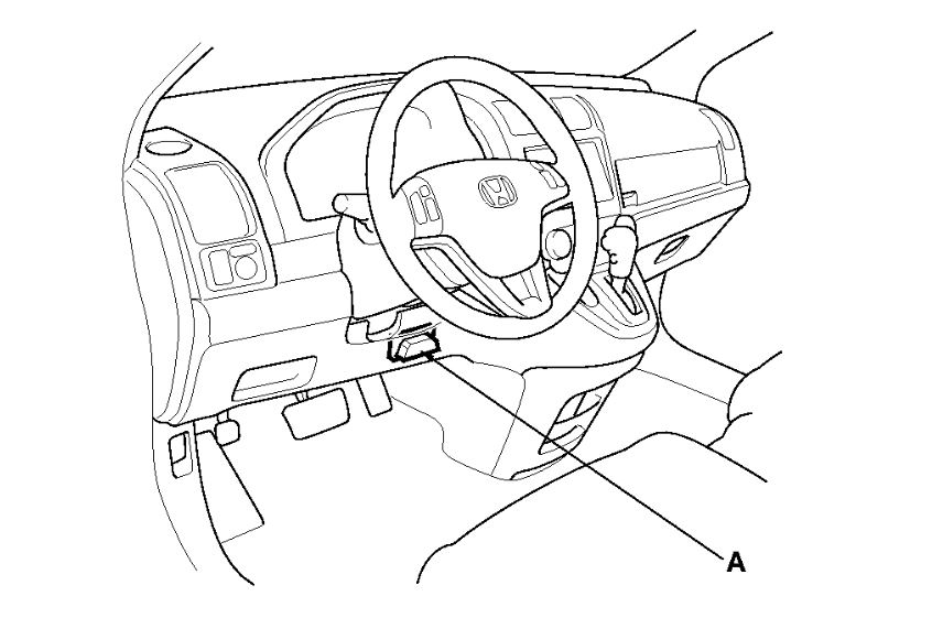

1. Connect the HDS to the data link connector (DLC) (A) located under the driver's side of the dashboard.
2. Turn the ignition switch to ON (II).
3. Make sure the HDS communicates with the PCM and other vehicles systems. If it doesn't, go to the DLC circuit troubleshooting. See: Data Link Connector > Component Tests and General Diagnostics > DLC Circuit Troubleshooting If you are returning from DLC circuit troubleshooting, skip steps 4 through 9, 19 through 25, and 28 through 30, and do the this after replacing the PCM;

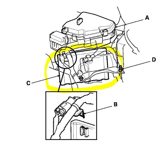

11. Remove the under-hood fuse/relay box (A).
12. Remove the harness bracket (B).
13. Loosen the battery hold down bolt (D), and reposition the battery away from the PCM.
14. Remove the PCM cover (C).

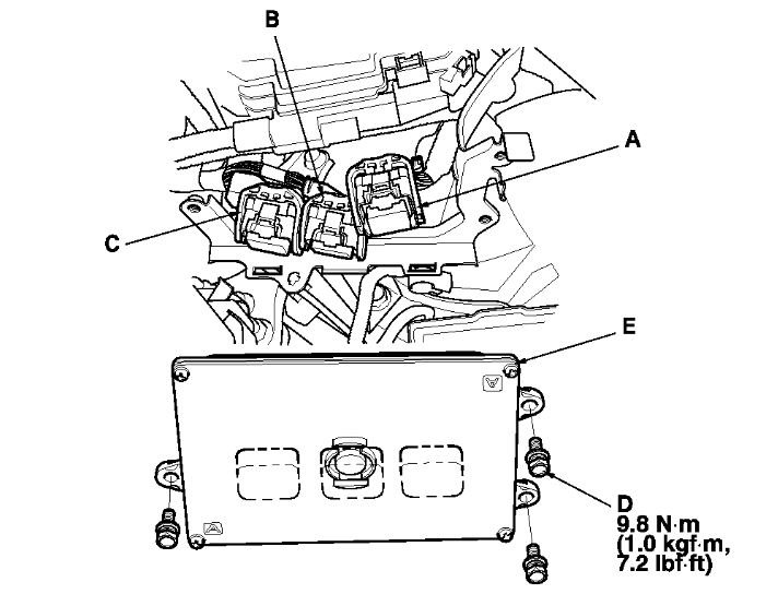

15. Remove the bolts (D), then remove the PCM (E).
16. Disconnect PCM connectors A, B, and C.
NOTE: PCM connectors A, B, and C have symbols (A=(square), B=(triangle) , C=(circle)) embossed on them for identification.
