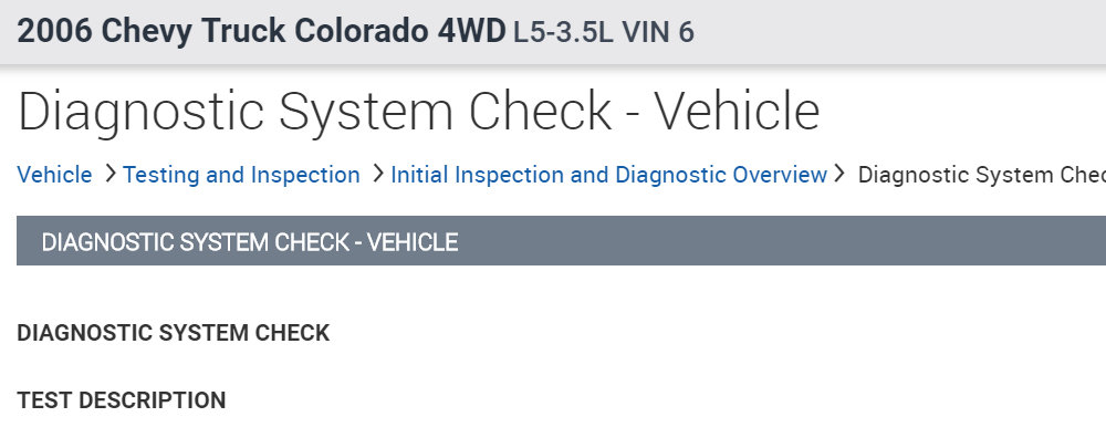

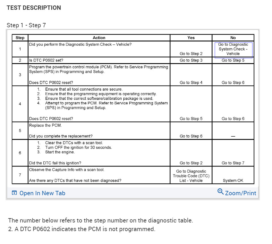

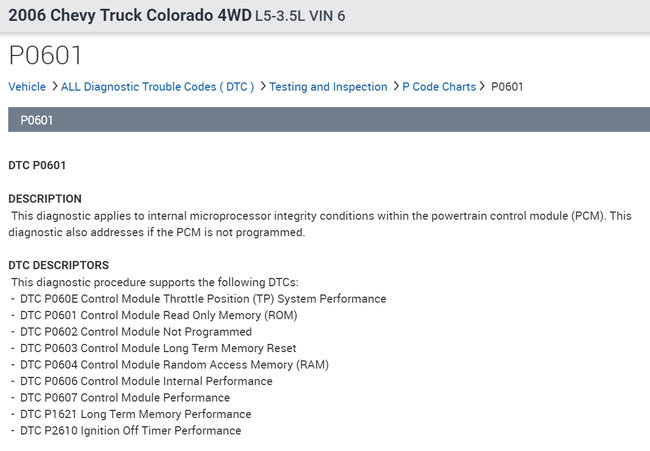

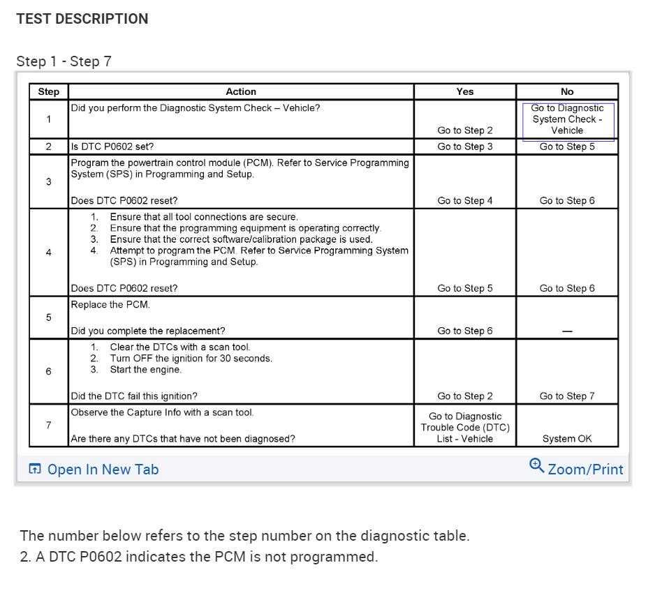

Intermittent stall/no start condition, cluster says reduced power. only code is P0601. Have cleaned all ground points, as well as both battery connections, both sides of fuse to main relay box. runs well when she will start and run. Other notes are vehicle will start run approximately five minutes. stall and not restart. Theft light in cluster does not come on, only says reduced power.
Feb 17, 2019 at 4:55 AM
SCGRANTURISMO
  • 4,897 POSTS

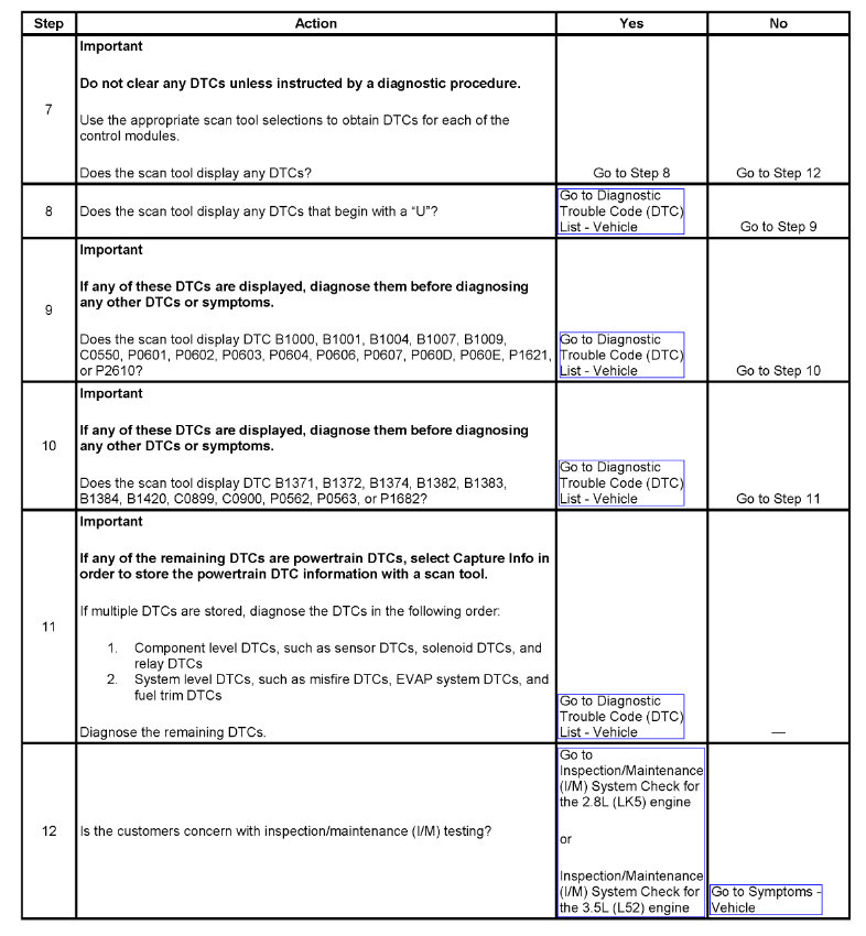

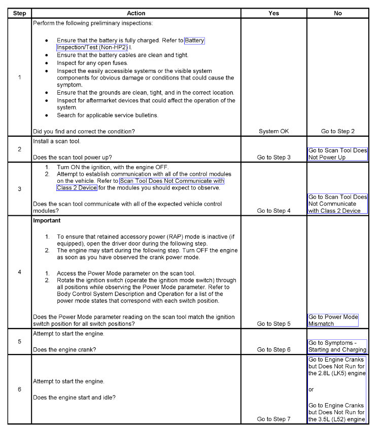

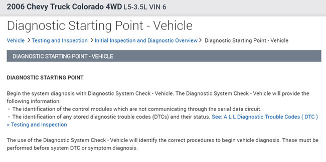

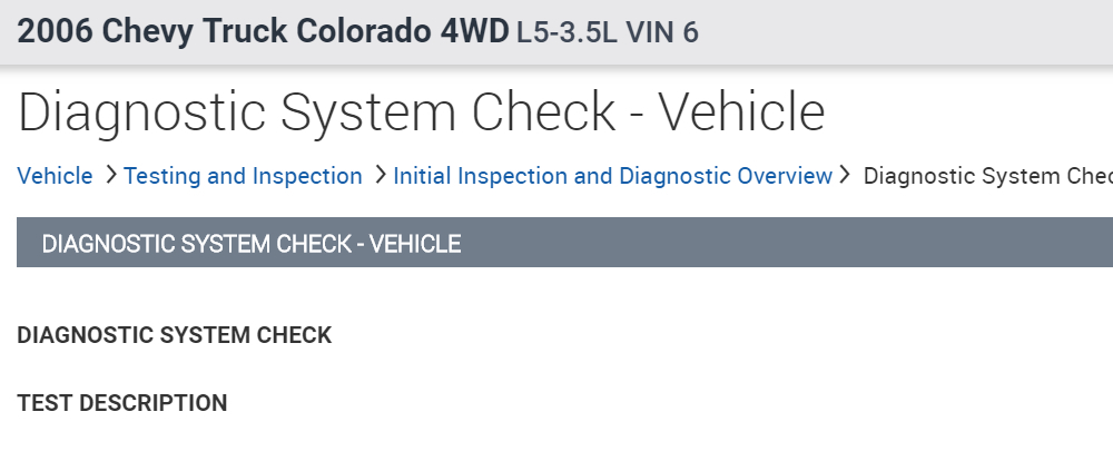

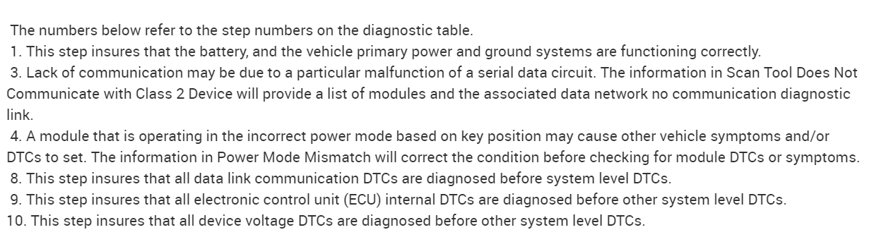

This might be a problem with your Power-train Control Module(PCM), AKA, your vehicle's "computer". I have included for you in the diagrams below a step by step troubleshooting flowchart for you to go through. Please let us know what you find out

Will have to wait for access to a diagnostic tool, all I have is the Blue driver on my ipad.

Tuesday, tried to start her to go to work . No crank no start, back to the same issue but worse now. Am I on the right track ?
Mar 7, 2019 at 10:40 AM
SCGRANTURISMO
  • 4,897 POSTS
Hello again,
You might want to go through the troubleshooting flowchart that was sent with the first reply to you. Go through it and get back to us with what you find out please.

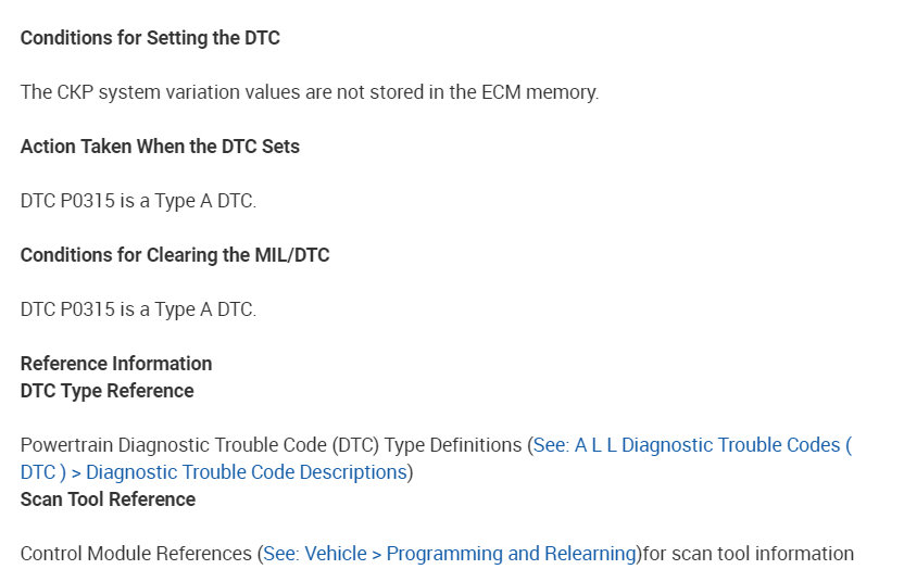

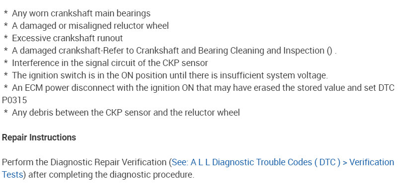

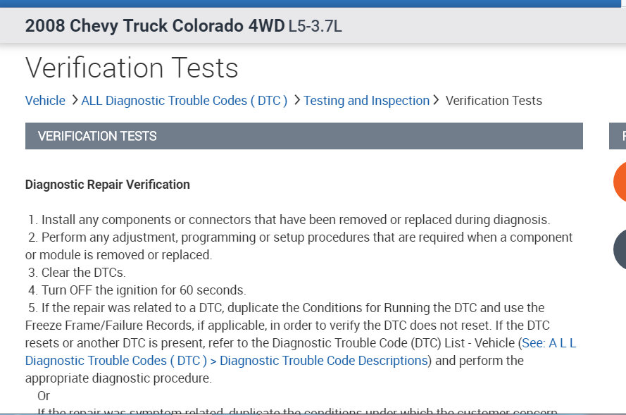

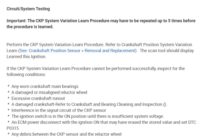

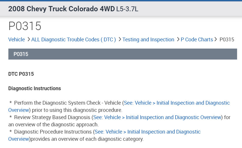

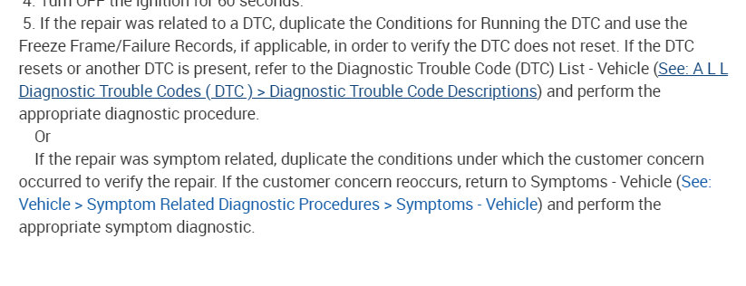

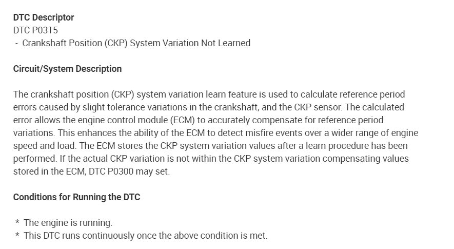

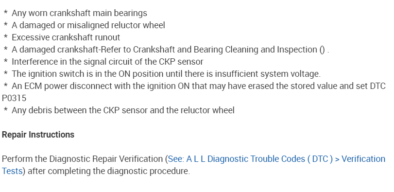

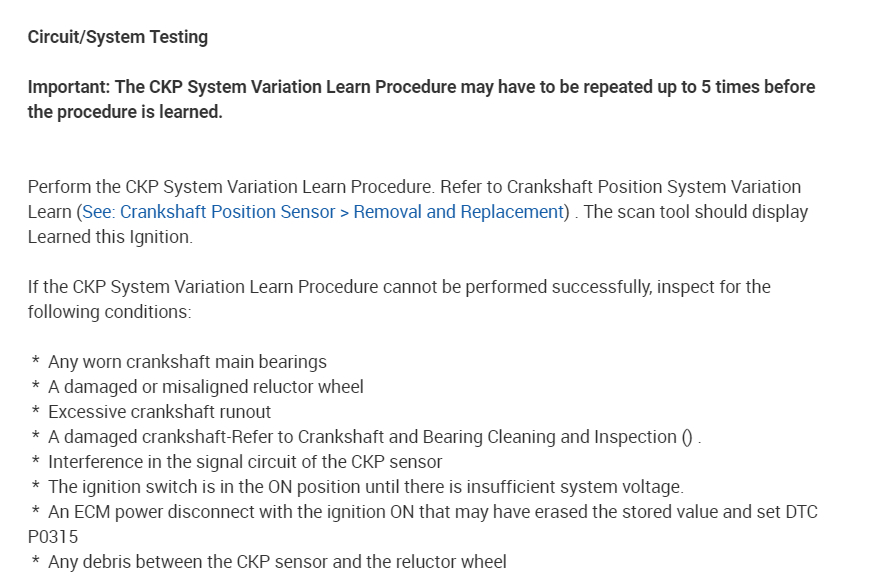

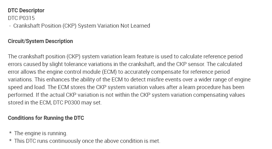

I was finally able to get a computer that makes the truck run correctly, but now have code P0315 which is crank position not learned. It's alive and runs as it did before. but worried about driving it.
Apr 17, 2019 at 7:39 AM
SCGRANTURISMO
  • 4,897 POSTS
Here is the information from the factory on DTC P0315 and how to fix it. I have included it in the diagrams down below. Please go through it and get back to us with what you find out, please.
