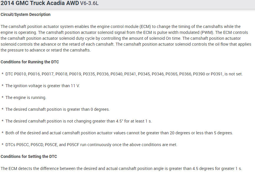

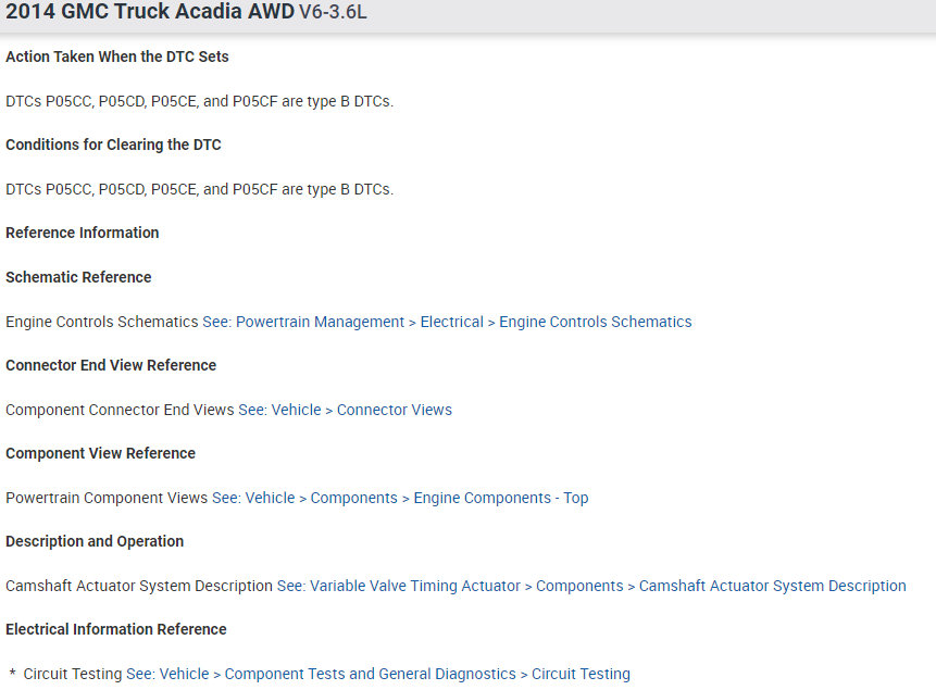

Check engine light on with code P05CC
2014 GMC ACADIA
152,000 MILES • 4WD • AUTOMATIC

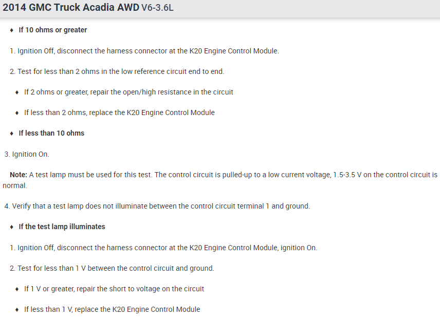

MAGICHELLBOY

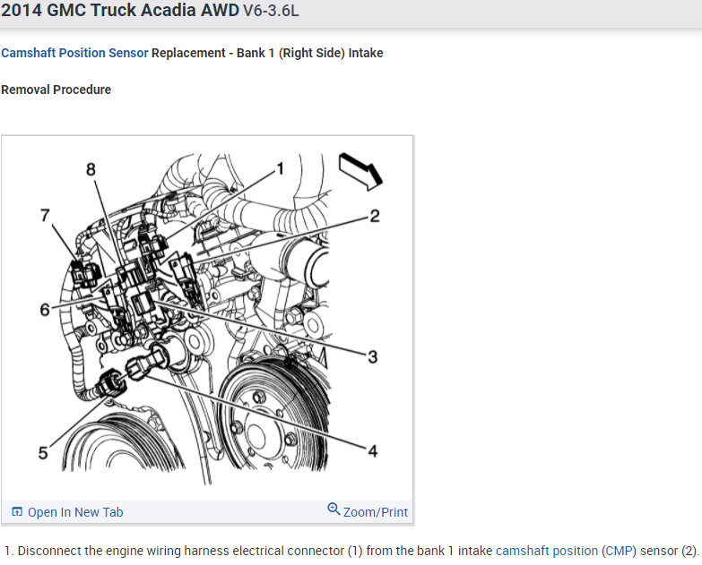

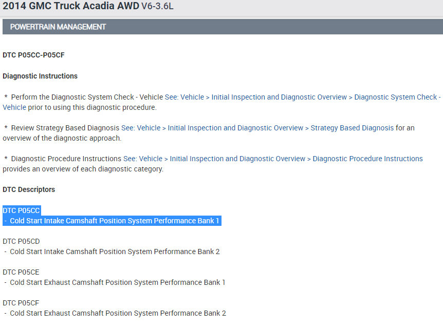

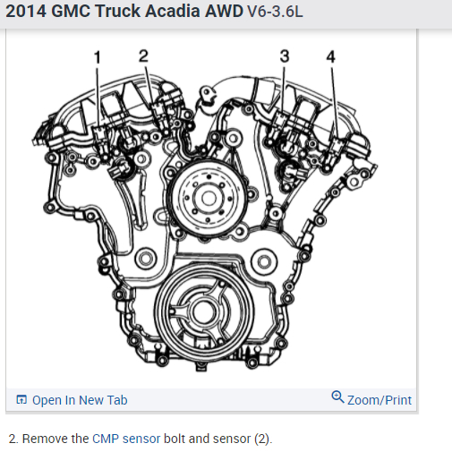

Cold start A camshaft position timing performance bank 1.

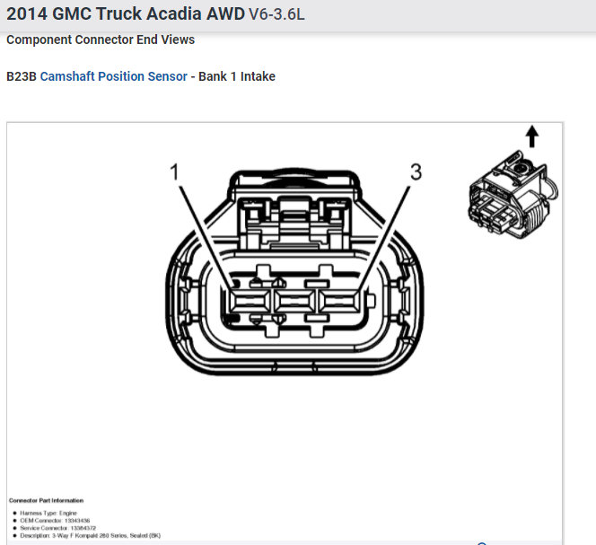

Where’s the location of this?
Jul 19, 2021 at 12:22 AM
SQM
  • 6,383 POSTS

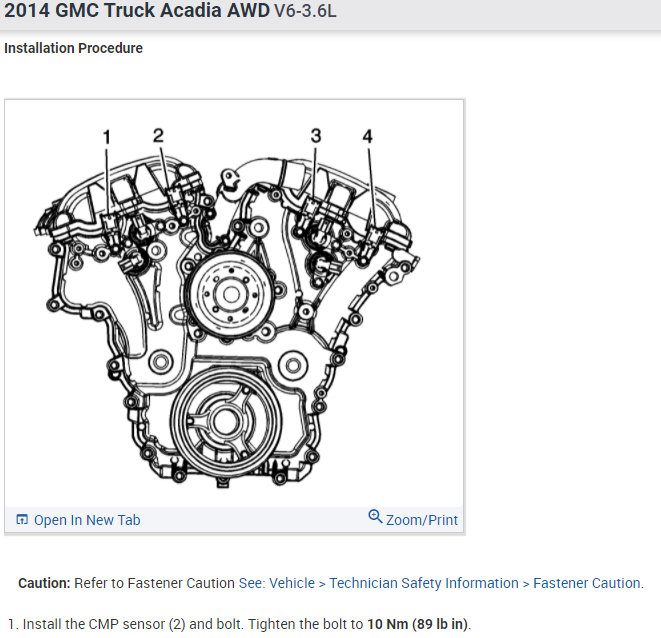

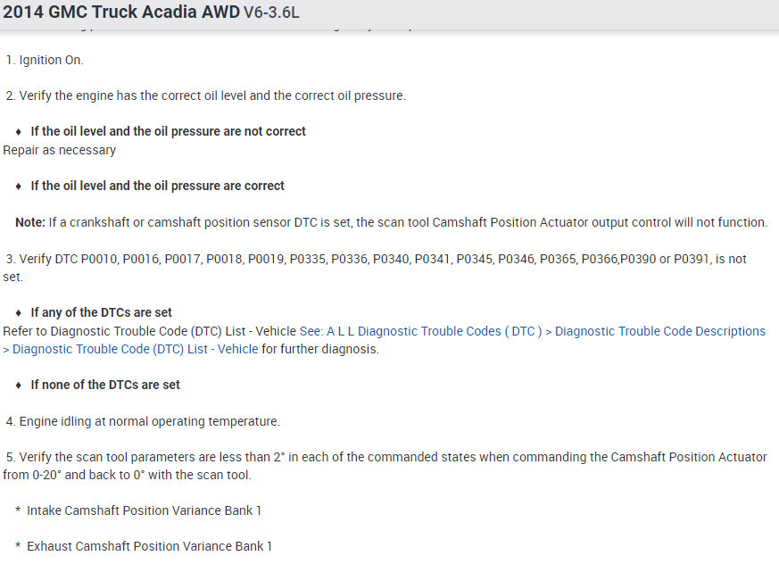

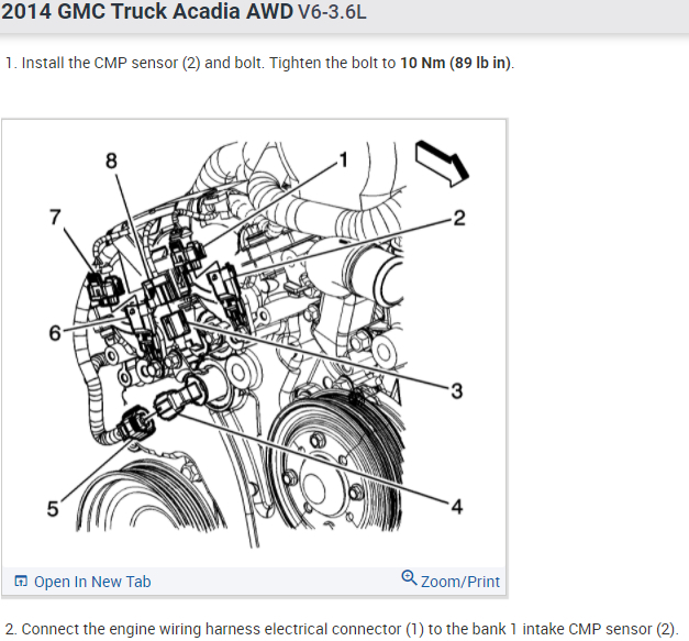

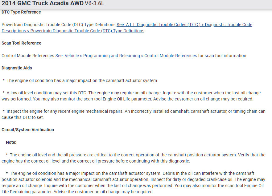

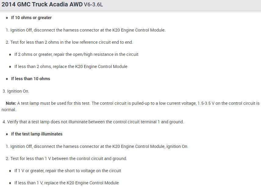

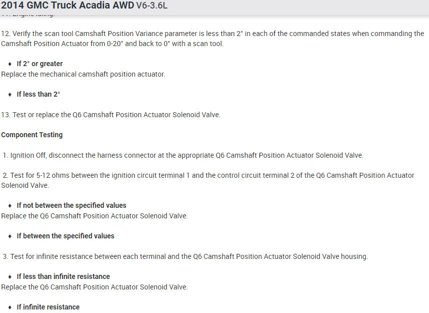

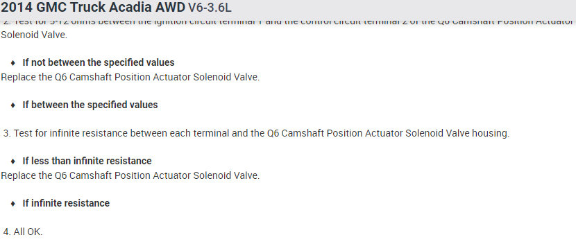

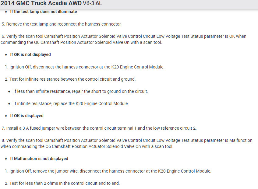

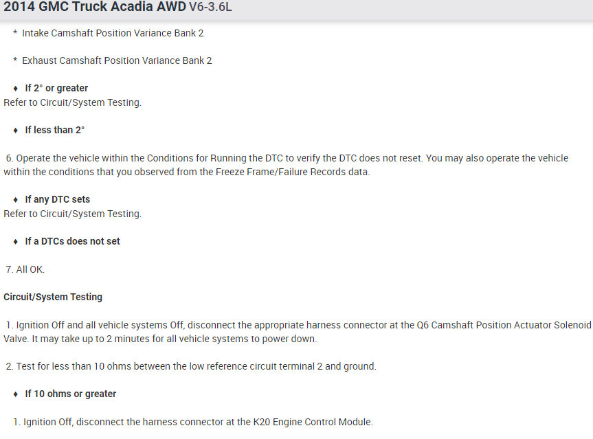

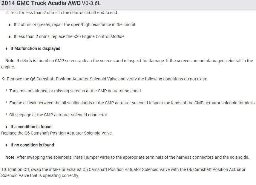

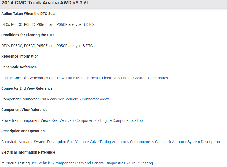

Here is a guide to help you step by step with instructions in the diagrams below to show you how on your car. I have attached the replacement procedure for the cam sensor as well as diagnostics procedure.
You might find this article helpful:
https://www.2carpros.com/articles/camshaft-angle-sensor-replacement
