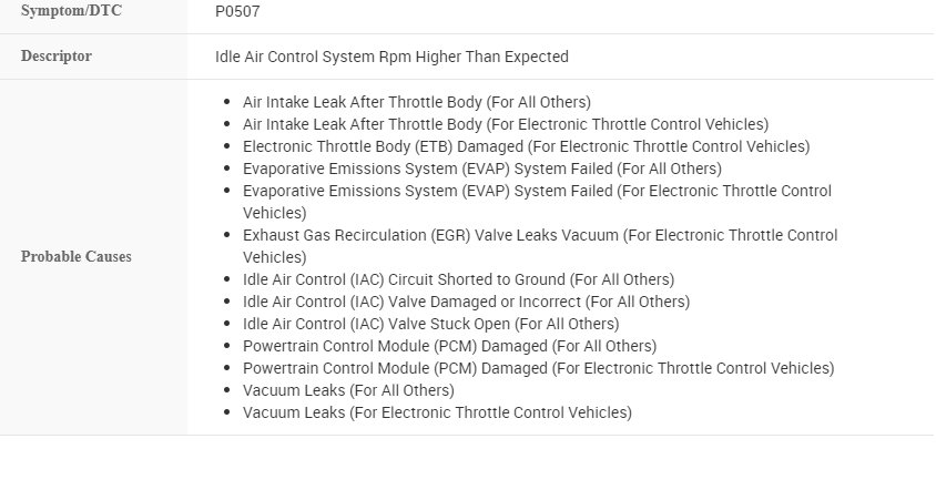

My car is idling high. we have replaced the hoses IAC and cleaned the throttle body but still idling high. what else could it be?

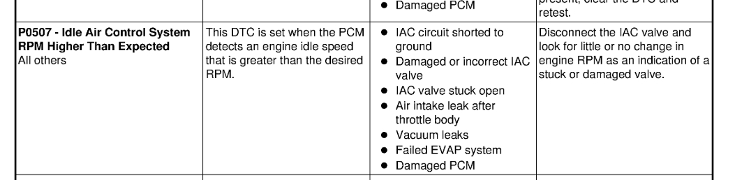

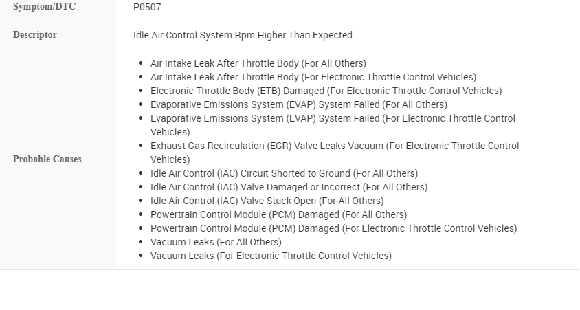

Good afternoon,
If you disconnect the IAC motor with the engine running. does the idle drop to normal or stall?
https://www.2carpros.com/articles/engine-idles-too-high
I attached the possibilities for you. Do the test I suggested and let me know what happens.
