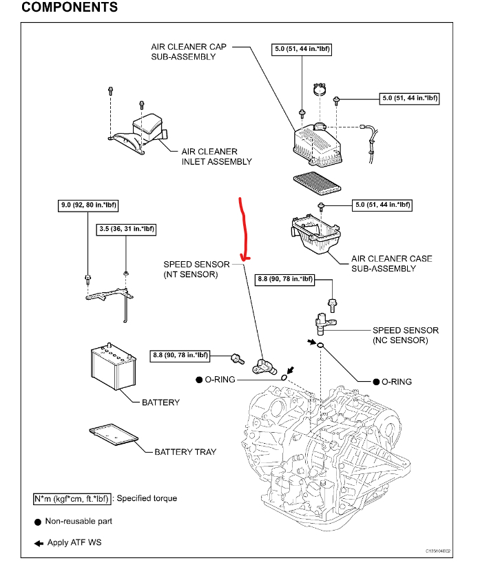

The code popped up P0500 is the VSS, and I would like to know where it's located. Can I fix it myself?

The diagnostic trouble code (DTC) P0500 stands for "Vehicle Speed Sensor Malfunction."
Here is the location of the sensor. Check out the images (below). Please let us know if you need anything else to get the problem fixed.
