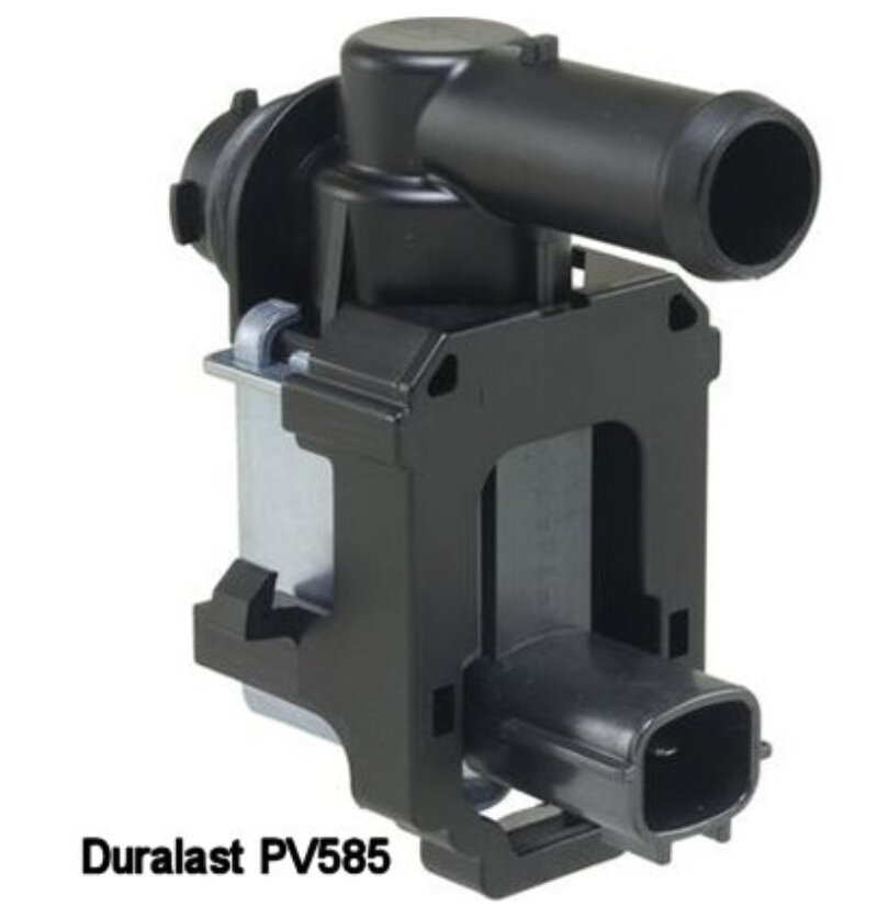

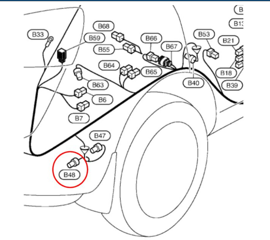

Hi, please show me where the Evap vent valve (purge valve) is located on my car, part replacement (ie: part number) and trick to fix them if available. I need both location of the vent valve and the purge valve.

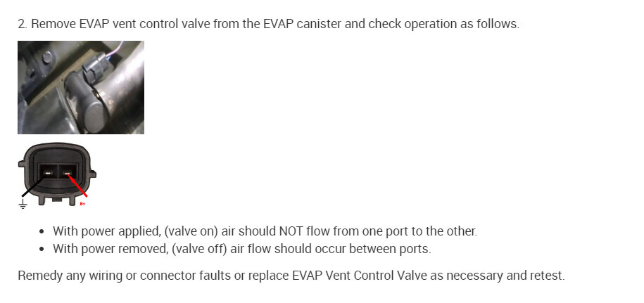

I would check the hoses going into the EVAP Vent Control Solenoid Valve which is located in the lower front fender on the driver's side. Here are images of the repair needed in the diagrams below. Please let us know how it goes and upload images of the problem would be good.
