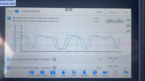

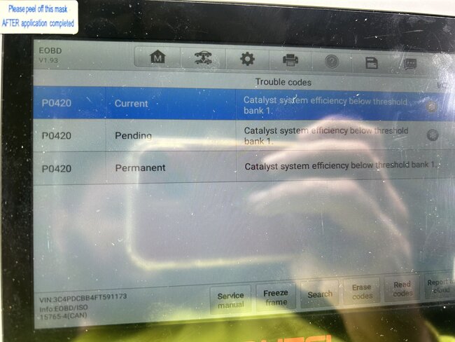

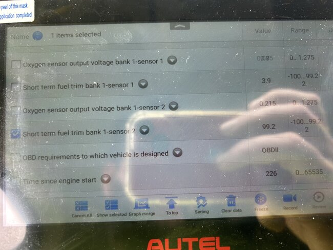

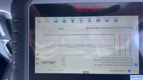

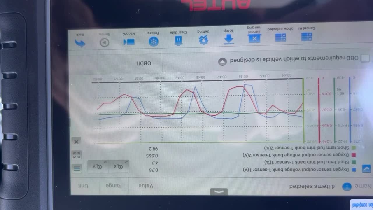

Hello, I am getting a P0420 code, and I took a picture of the oxygen sensor information and I’m wondering if you could help me interpret it. I’m not very good with the information. Is sensor number two bad?
I’m hoping I don’t have to replace the entire catalytic converter.
Apr 18, 2025 at 2:22 AM
STEVE W.
  • 15,345 POSTS
Pull up the bank one sensor 1 voltage. Then the bank one sensor 2 volts, select those and switch to graphing mode. Now look at the data. Sensor 1 should be switching rich lean rapidly. Sensor 2 should be an almost flat line with small changes. If it looks like the data from sensor one the converter isn't working. With the codes you have I would say the converter is bad.

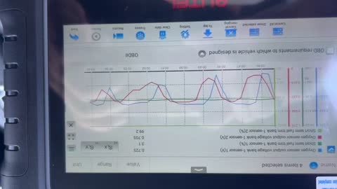

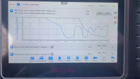

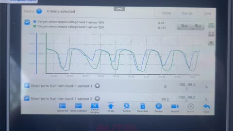

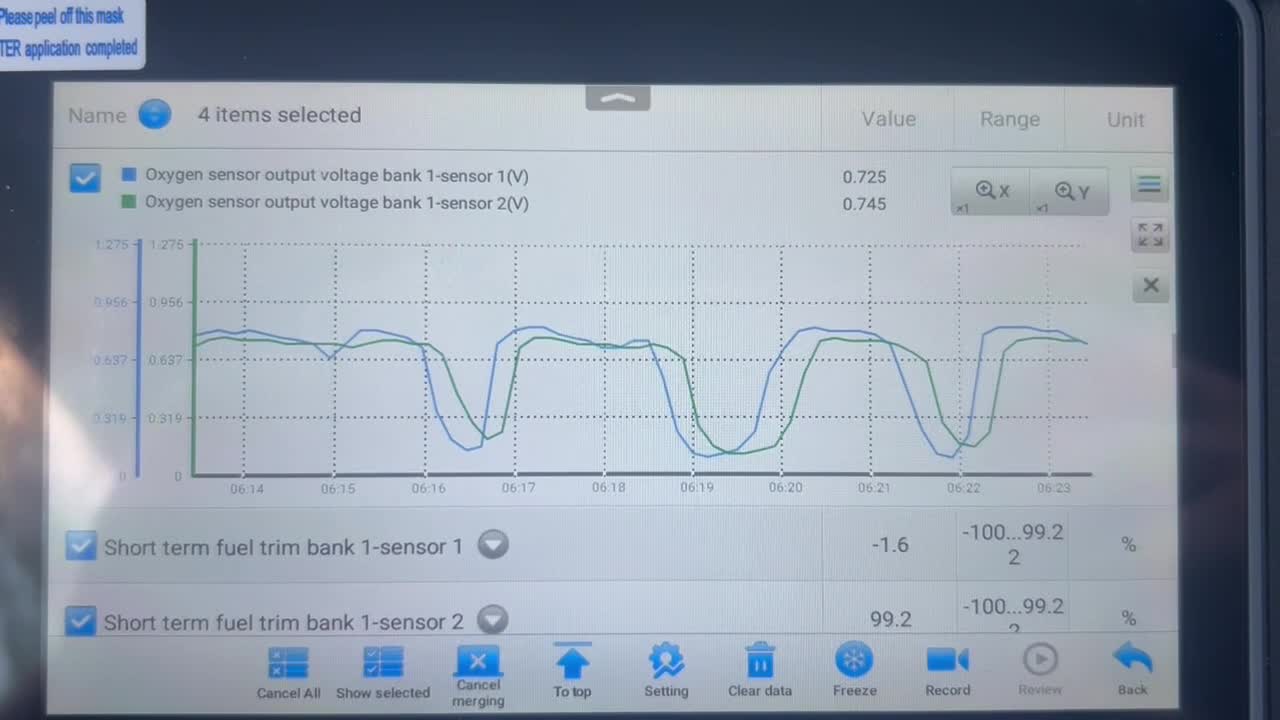

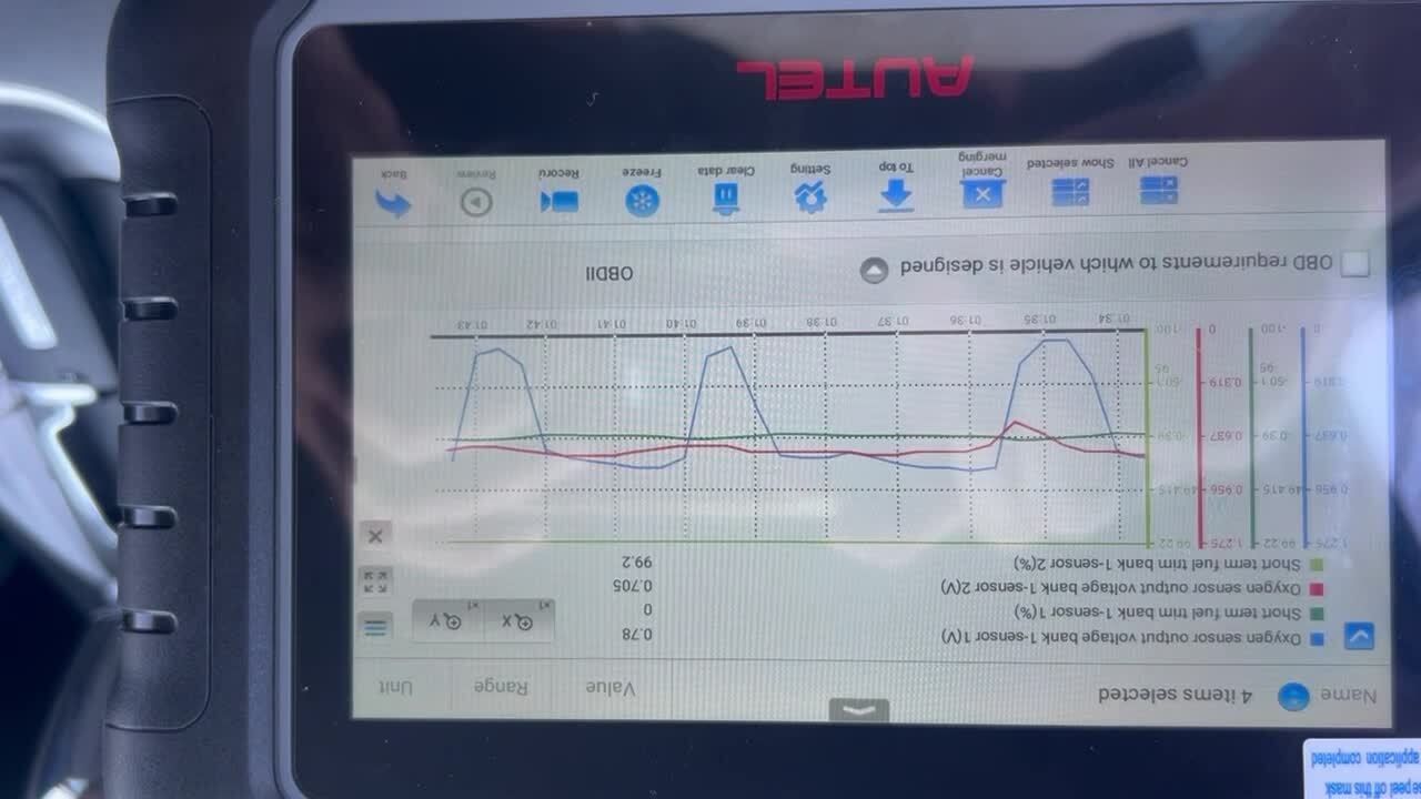

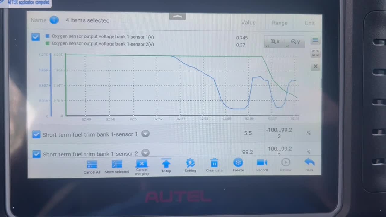

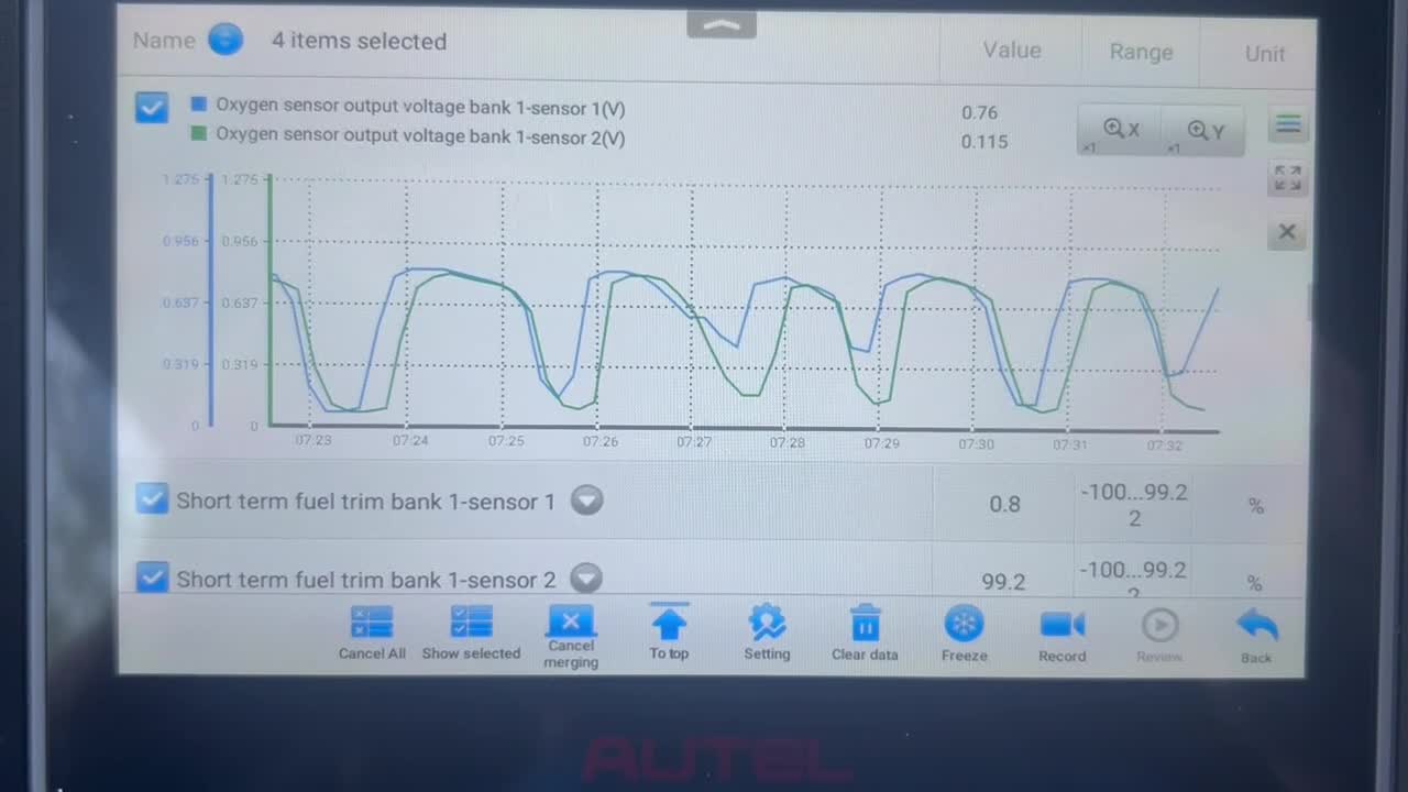

This is like the third time I am trying to upload these videos. For some reason it’s not going through. I might just have to try to load them separately each time.
Apr 20, 2025 at 9:33 PM
BEETLEPUNK21
  • 127 POSTS
It looks good at the start but then at the last video it looks like sensor number two is doing what sensor number one is doing.
Apr 20, 2025 at 9:34 PM
BEETLEPUNK21
  • 127 POSTS
Video 2

Video 3
Apr 20, 2025 at 9:37 PM
BEETLEPUNK21
  • 127 POSTS
Video 4 (last video)
Apr 20, 2025 at 9:38 PM
STEVE W.
  • 15,345 POSTS
Yeah that looks like the converter isn't working at all once it warms up. It also looks like sensor 1 is sluggish. Unfortunately, the repair would be a new converter and sensor 1.

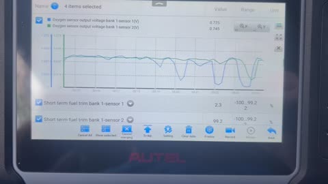

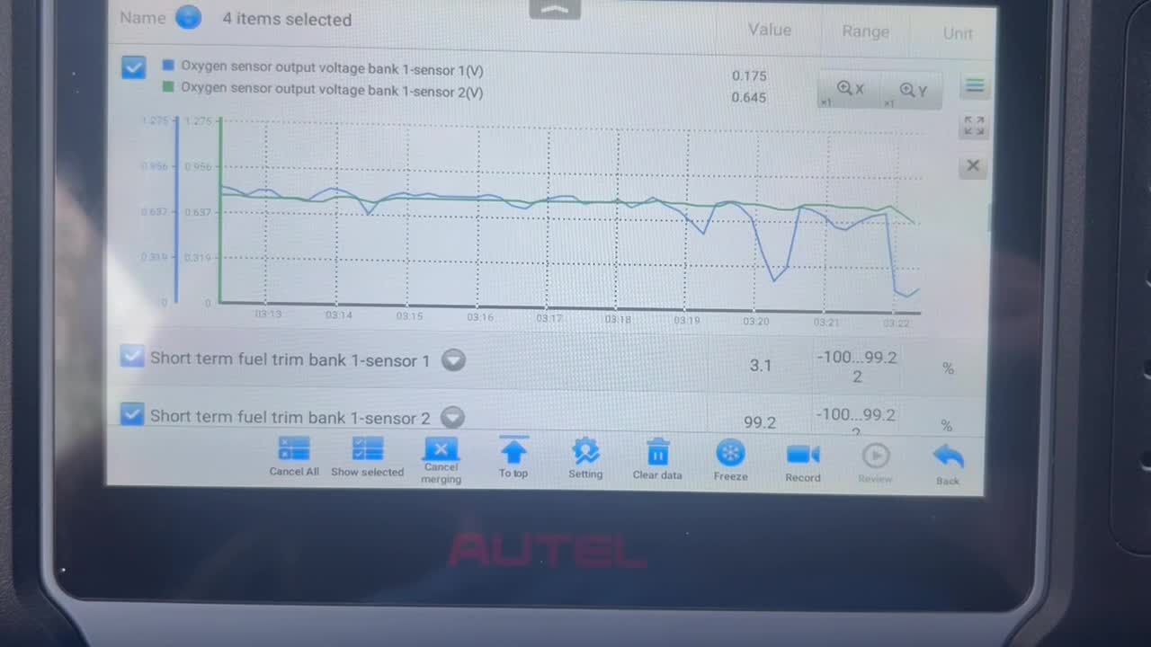

I bought a new converter from rock auto for $200 and installed it. I kept the same oxygen sensors from the old converter. Here is the new information from the scan tool.
How does it look? The engine is already at operating temperature.
I just noticed that the image is uploaded upside down. I don’t know why it’s doing that. Hopefully you can still read it properly.
May 4, 2025 at 10:16 AM
STEVE W.
  • 15,345 POSTS
You must not be in a C.A.R.B. state, lucky you. I just did one on a 2.4 last week, $1,160.00 from the dealer!! In the first video you can see the sensor voltage for S1 and S2 don't track with each other, that is a good thing. Look at the difference between that and the videos you posted earlier where they were almost in sync with each other. With the mileage you might want to change the upstream sensor just to get better control but if it isn't using oil and the sensor didn't look like a charcoal briquet when you had it out it could be okay.
