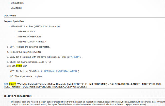

Need help please. Don't know if it's the downstream sensor ar catalystic. Thanks
Mar 4, 2016 at 2:39 AM
DRCRANKNWRENCH
  • 3,380 POSTS

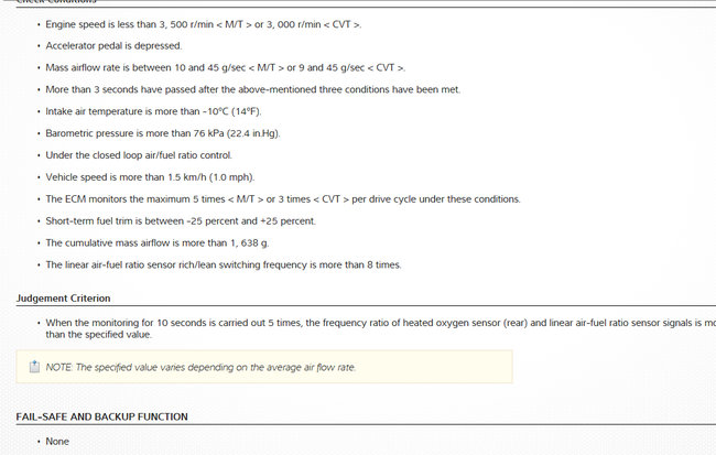

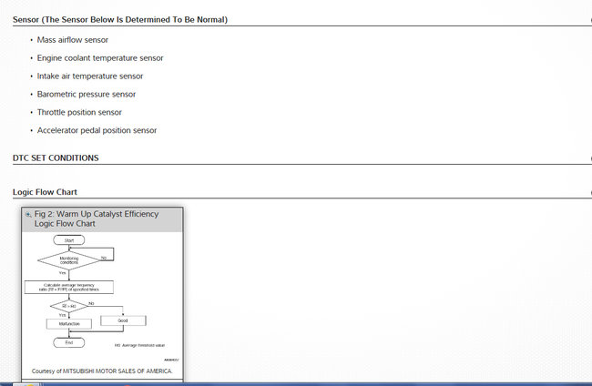

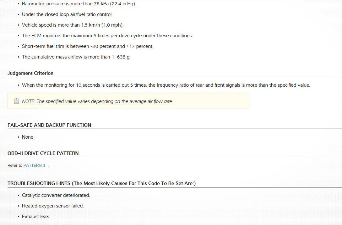

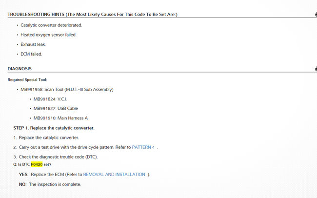

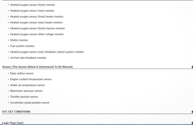

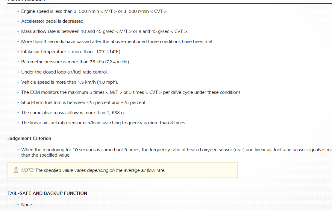

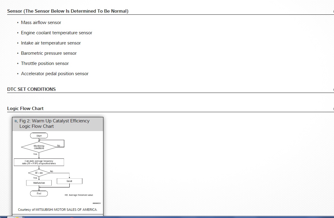

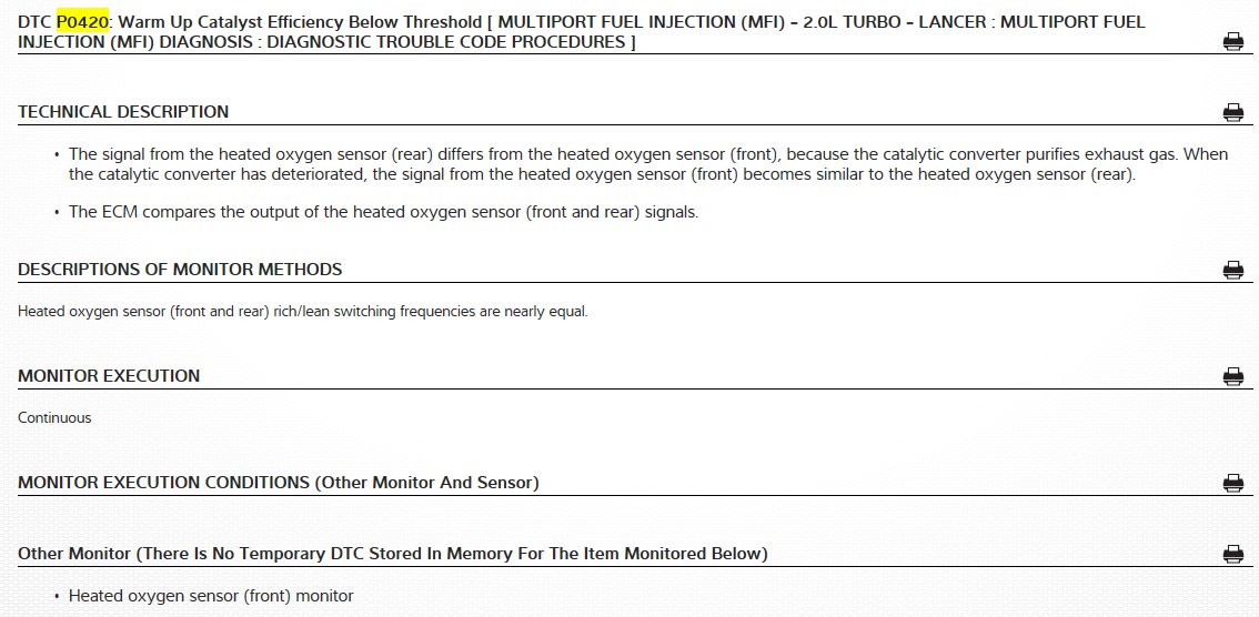

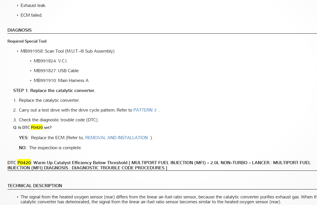

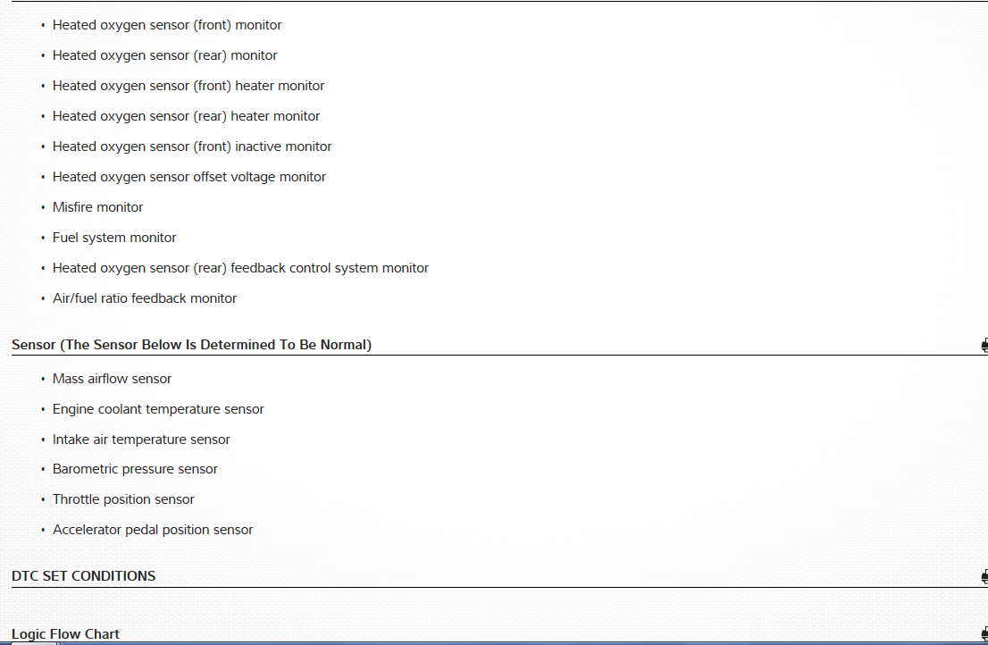

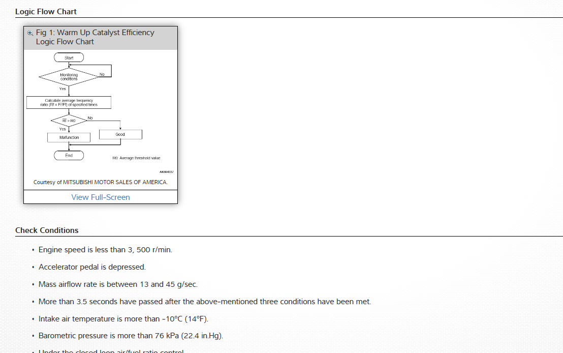

I looked up the code in our online guide. Attached are the notes from said code. Let me know if you need more information. One of the sensors probably needs replacement.
Mar 4, 2016 at 3:18 AM
