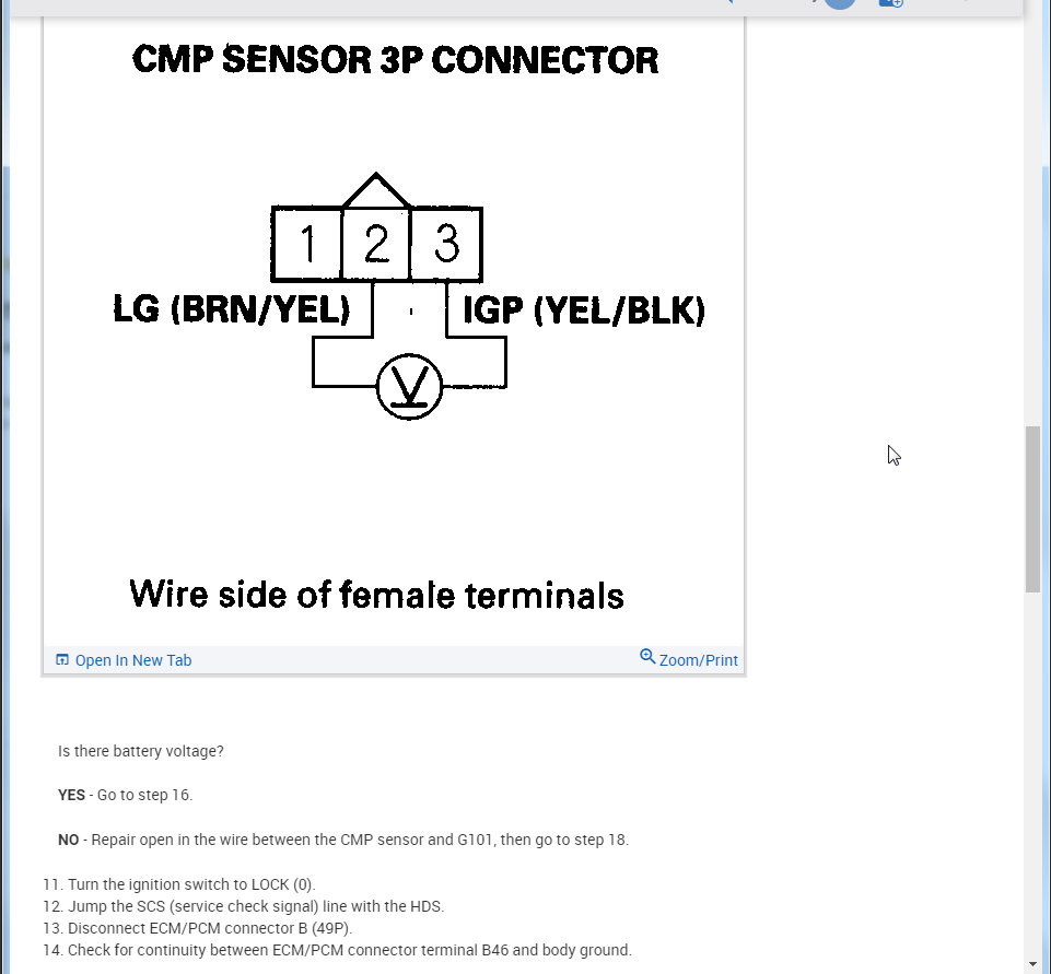

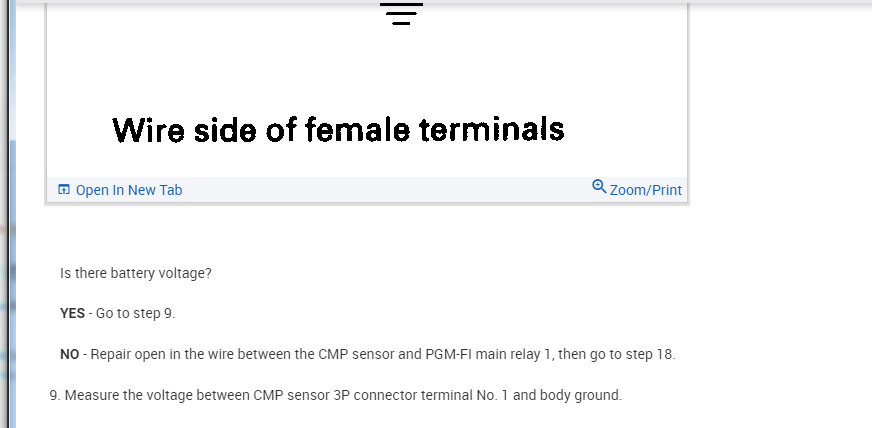

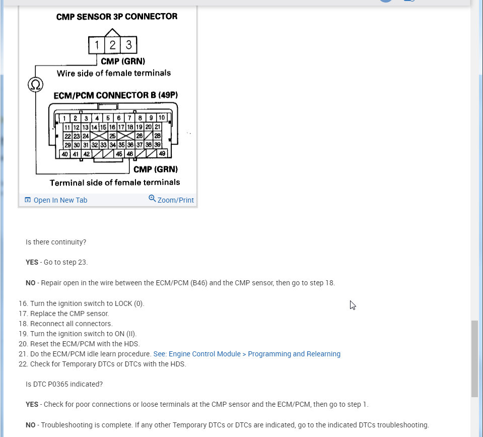

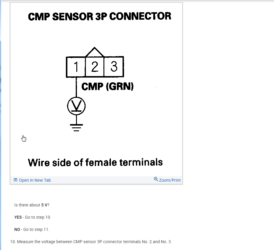

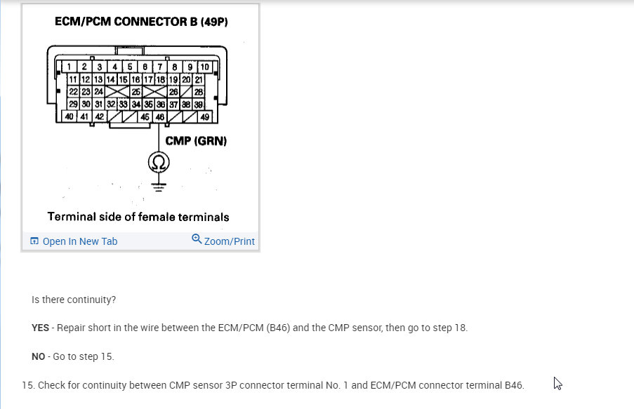

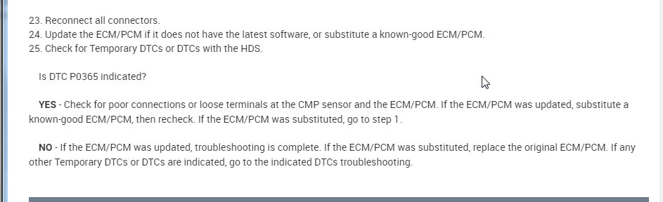

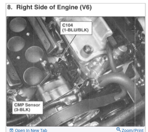

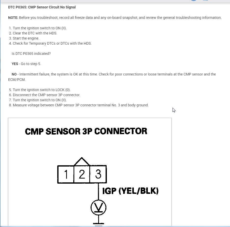

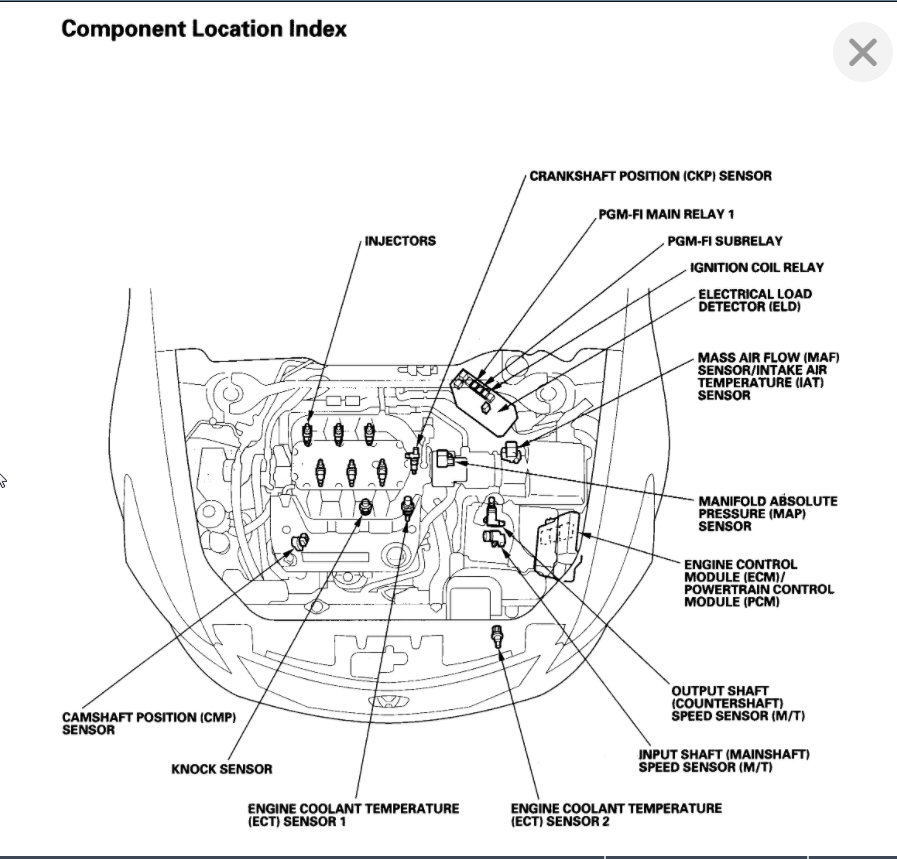

Code P0365 Permanent DTC CMP Sensor (B) circuit no signal Trying to locate the sensors.
Aug 22, 2020 at 7:54 AM

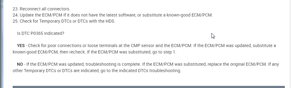

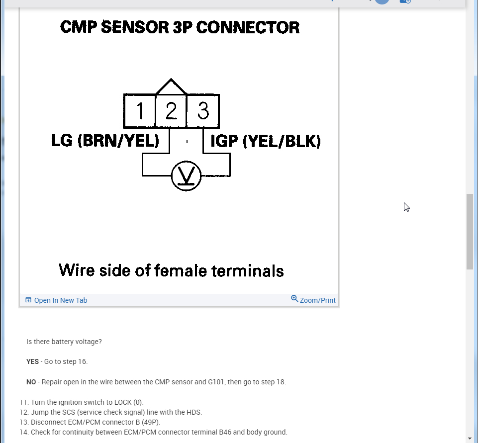

I attached the info plus the testing for this code. Let us know if there is anything else you need. Check out the diagrams (Below). Please let us know if you need anything else to get the problem fixed. Thanks
