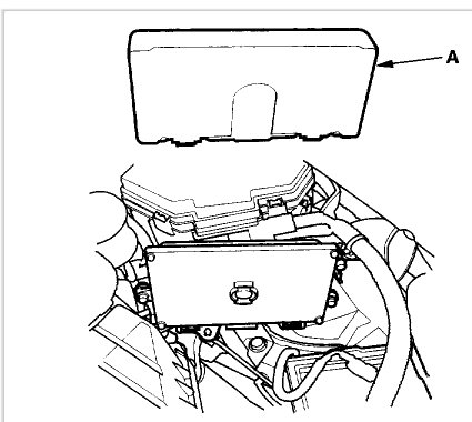

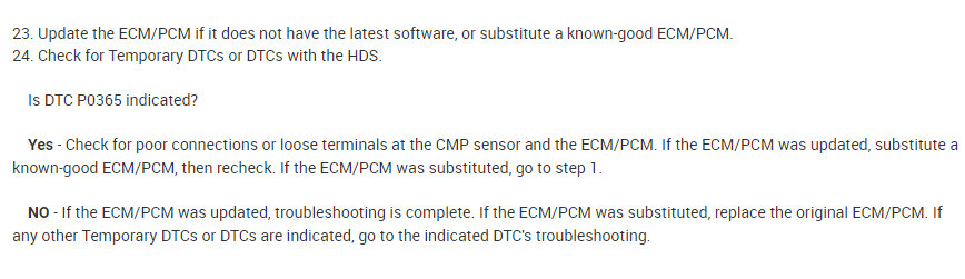

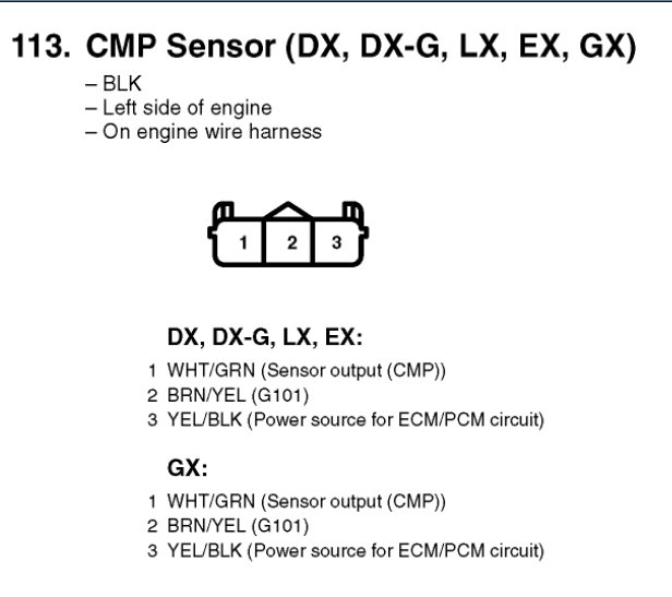

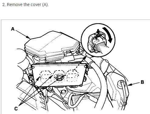

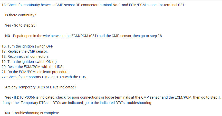

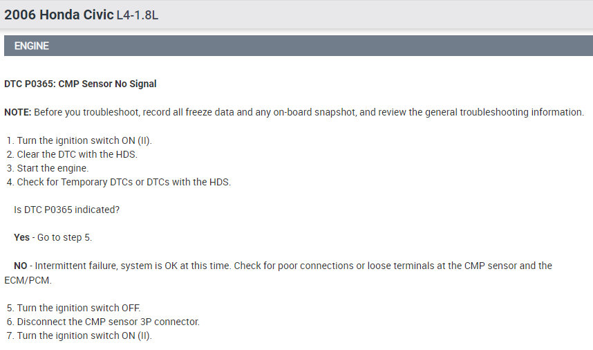

Bought this car INOP, the guy at the auction told me it was running fine when they brought it in, I trust him, been dealing with him for years. Battery was drained and she wasn't even cranking.. got another decent battery I had around, volts are good, also put a jumper box on it. It started to turn but the RPM needle isn't moving. And doesn't sound normal, made sure camshaft and rocker arms turning by taking a peek in the valve cover cap. Only code I have is p0365, for a camshaft sensor. Would this sensor prevent it you think from starting? Could crankshaft sensor on these trigger this code without having a code? Where is it located? This has the 1.8L and if am not mistaken since it is not a Civic SI has the SOHC.
Jan 29, 2021 at 5:02 AM
DANNY L
  • 5,648 POSTS
Hello, I'm Danny.

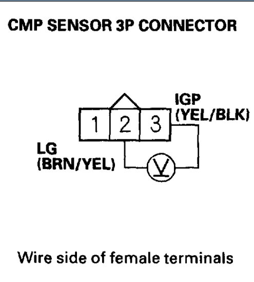

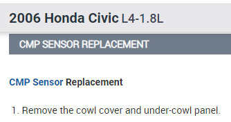

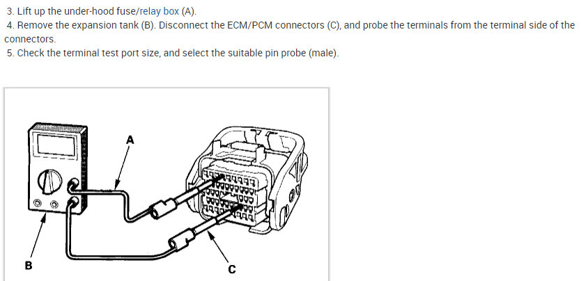

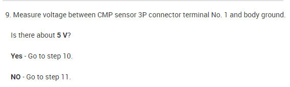

Yes, the camshaft position sensor faults will cause the car to not start. You will need to test the circuit as well. Here are tutorials for you to view for wiring testing and sensor replacement:
https://www.2carpros.com/articles/camshaft-angle-sensor-replacement
I've attached picture diagnostic steps below relating to the code you provided as well as replacement steps. Hope this helps and thanks for using 2CarPros.
Jan 29, 2021 at 6:37 AM

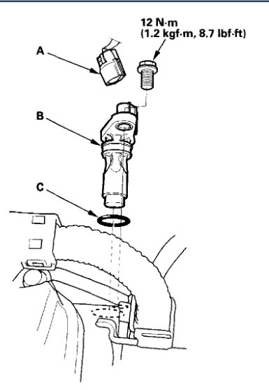

NASER NASER
  • 836 POSTS

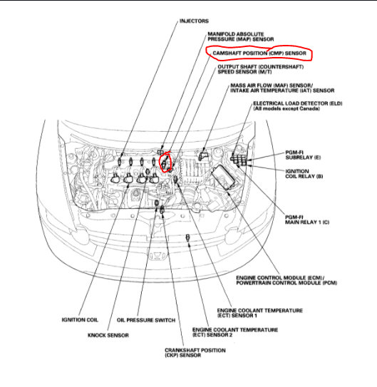

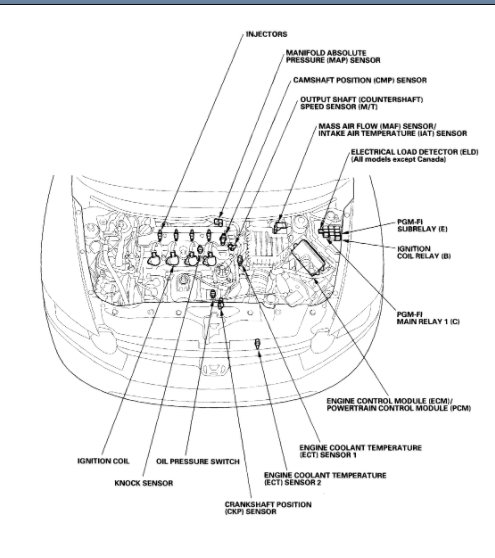

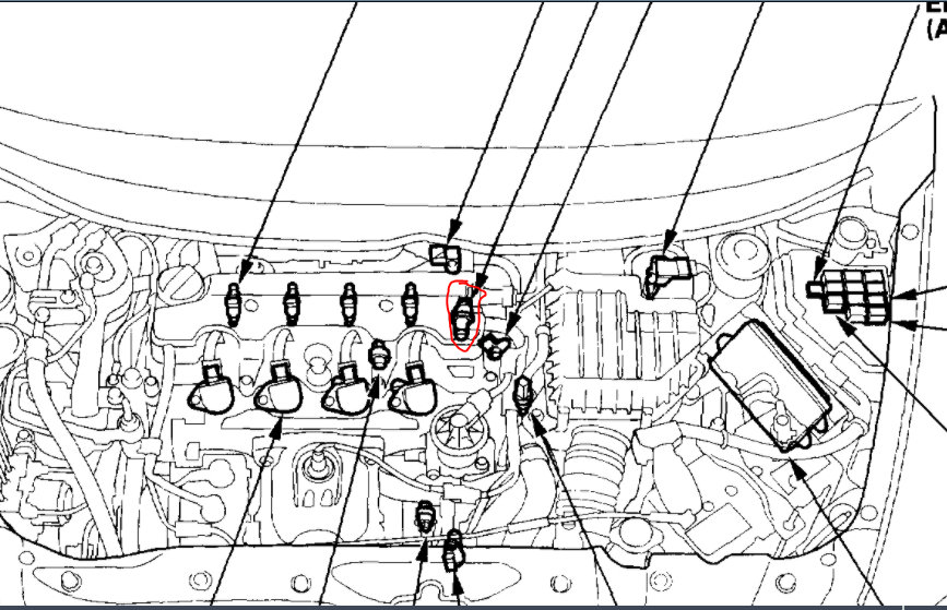

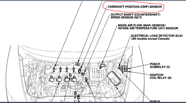

Based on the pic before last, is the location on the back of the valve cover on passenger side while standing in front of the car? Pics don't say, i saw something similar to it and i unplugged it to see what it is, and i had a rocker arm something as a code.
Jan 29, 2021 at 7:01 AM
DANNY L
  • 5,648 POSTS
Hello again,
Here is a picture of the location. I've attached it below. Let us know what happens with diagnostic testing. Hope this helps and thanks again for using 2CarPros.
Danny-
Jan 29, 2021 at 7:07 AM

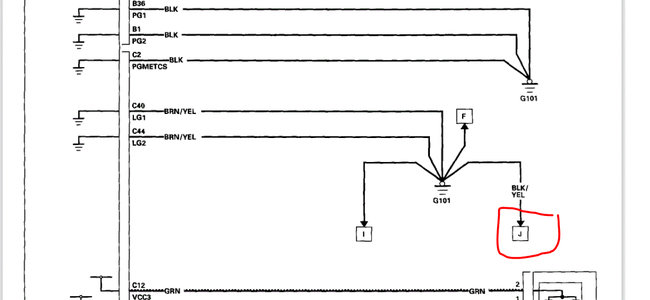

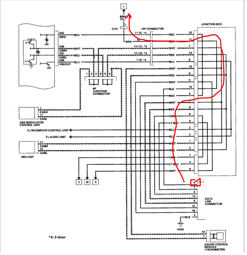

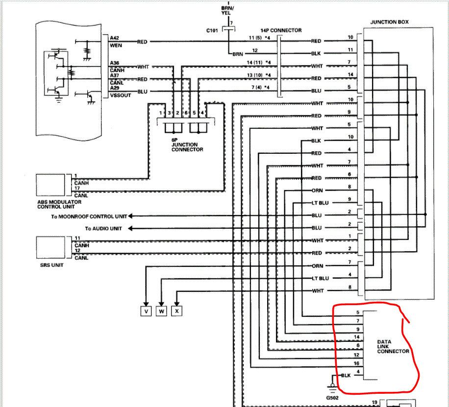

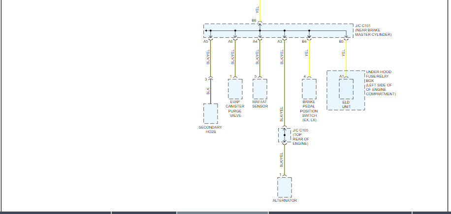

Can you tell me which obd connectors are 4 and 5? Like is there a diagram for the obd connector that can show me which number is which?
Feb 10, 2021 at 4:24 AM
  • 110,246 POSTS
I just thought I would add this for you. I attached the wiring schematic for the DLC. Connector 4 is ground and pin 5 is also a ground. If you look at pic 2, I followed the wire from pin 5. It ends at the letter J. After going through several pics, I found the other end of J and it's in pic 3.
I attached three pics below. Take a look through them and let me know if you need additional information.
Take care and God Bless,
Feb 11, 2021 at 10:57 AM

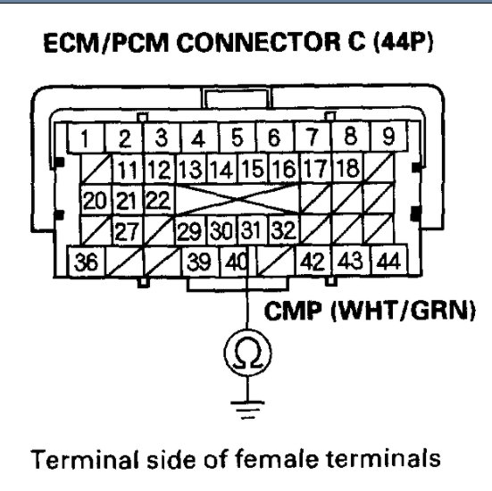

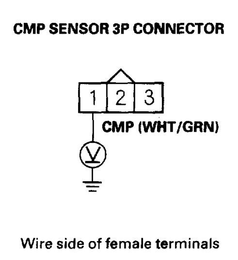

Input a new battery in it same thing, also made a couple of pop noise. MAF boot is off maybe that's why, took me quite few cranks before i got the p0365 again, but it's under pending. Should i try another camshaft sensor different brand?
Feb 19, 2021 at 4:40 AM
NASER NASER
  • 836 POSTS

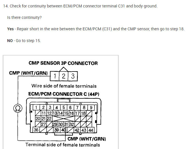

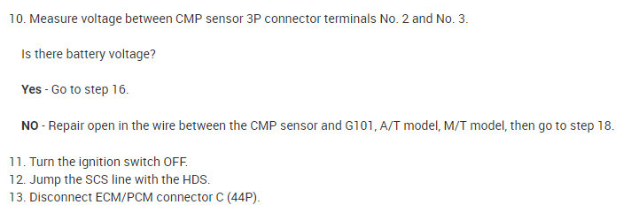

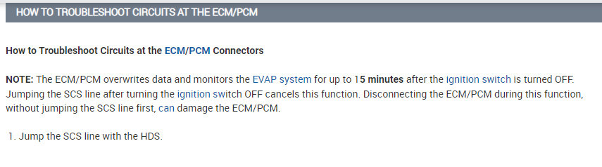

PCM and CMP harness its there, for step 12 what does it mean when it says jump SCS with HDS?
Feb 20, 2021 at 1:51 AM
NASER NASER
  • 836 POSTS

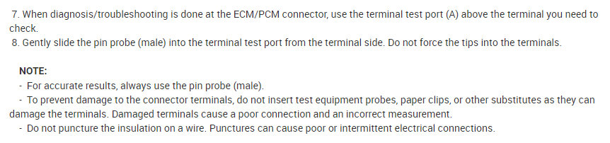

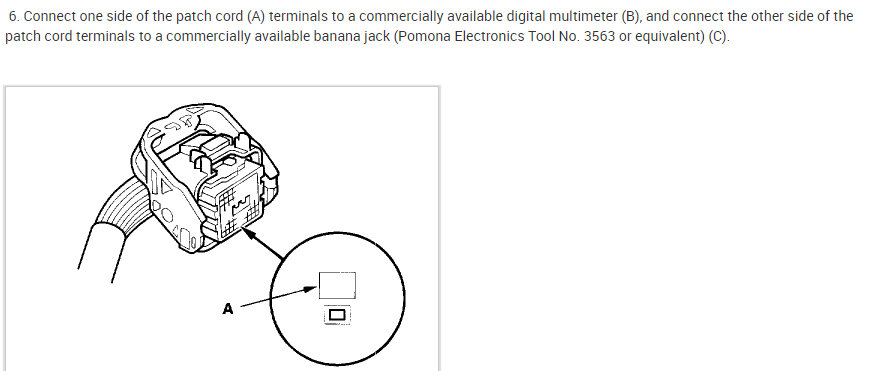

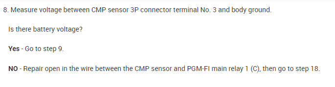

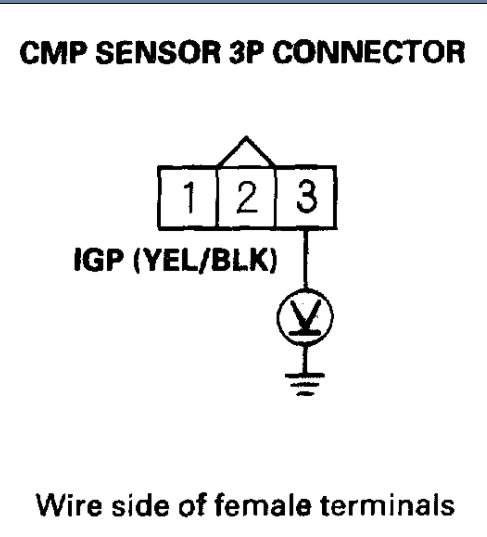

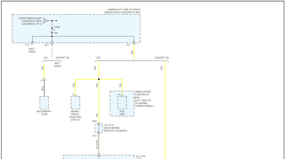

For step 8 measuring voltage between battery negative terminal and 3rd connector i only have .5 volts not battery volts, says repair open circuit between harness and relay. which relay?
Feb 20, 2021 at 2:08 AM
NASER NASER
  • 836 POSTS
Found the relay and switched with another no results, but if my findings on the volts are right then the wire to the relay has an issue? Because it's .5v?
Feb 20, 2021 at 2:57 AM

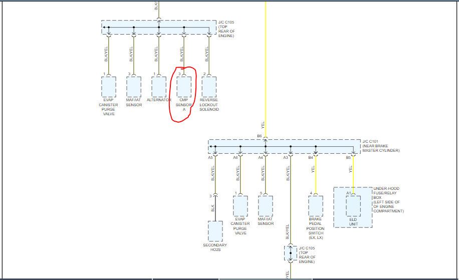

DANNY L
  • 5,648 POSTS
Hello again.
I've attached a few more diagram pictures below related to the question at hand. Hope this helps and let us know if you have any further questions on this issue. Thanks again for using 2CarPros.
Danny-
Mar 11, 2021 at 7:37 AM
NASER NASER
  • 836 POSTS
After further looking turned out some of the PCM wires under the dash were cut, not sure what they were for, all good after fixing. thanks for your time.
