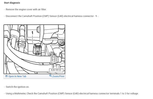

My car suddenly stopped mid road. I’ve tried turning it on and it sounds like it wants to crank but won’t. All the lights turn on in the car. I ran a diagnostic ABS this is the code that showed up along with code P0100. Any help please!

The Code P0343 is a camshaft position sensor issue, how does the engine sound when it is cranking over? If normal i would change out the camshaft position sensor. here is the instructions and location in the images below.
