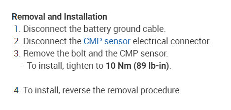

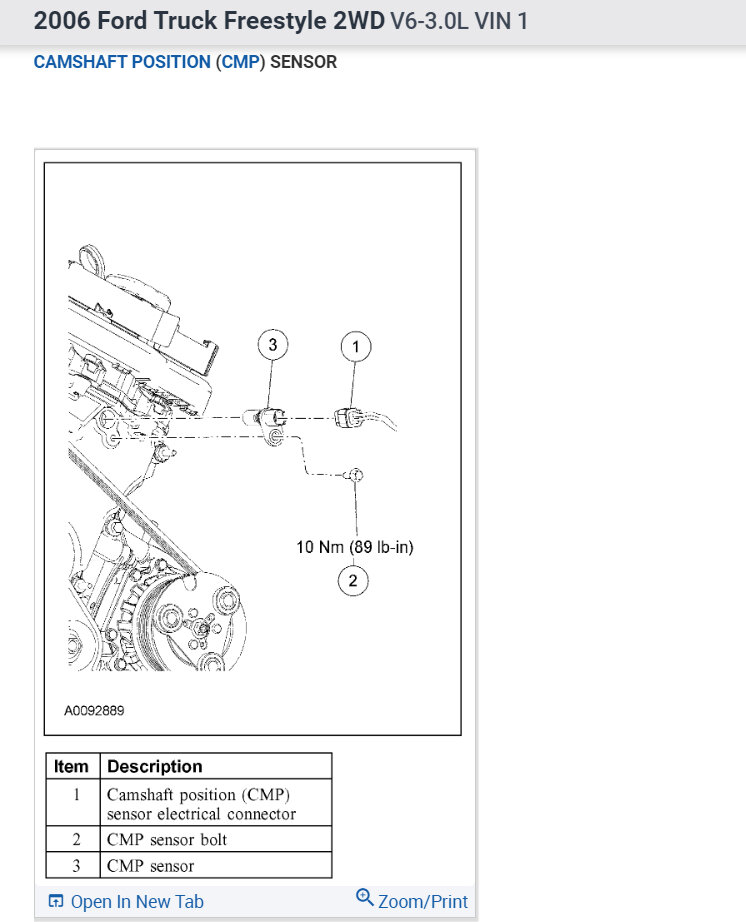

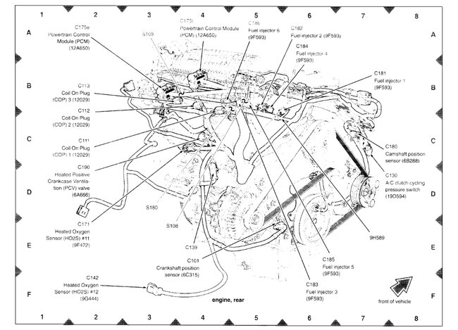

I have the check engine light on. The code reads P0340, says malfunction camshaft position sensor bank 1. I'd like to know where is the location for the Camshaft position sensor bank1. Thanks
Jan 17, 2023 at 3:07 AM
  • 55,758 POSTS
There is only one camshaft position sensor on this engine which is on the front of the cylinder head on the left side of the engine. Check the images below to see what I am talking about. Check out the images (below). Please let us know if you need anything else to get the problem fixed.
