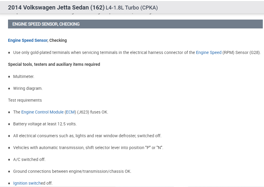

1.8L, only code is p0322.
Sep 4, 2022 at 7:40 AM
  • 110,244 POSTS

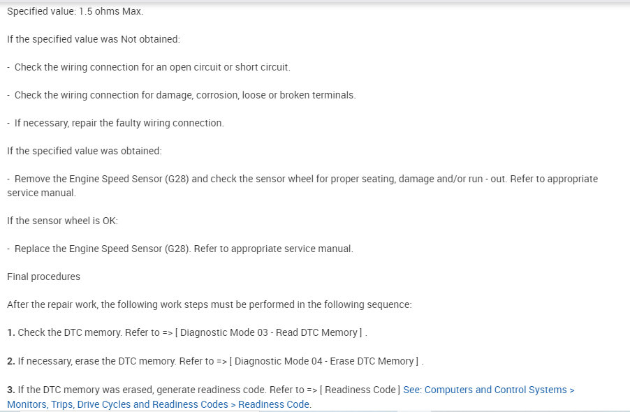

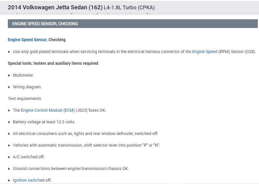

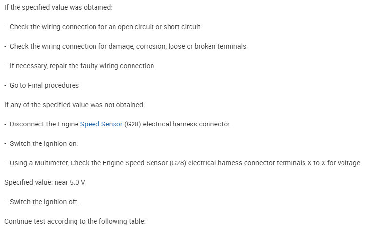

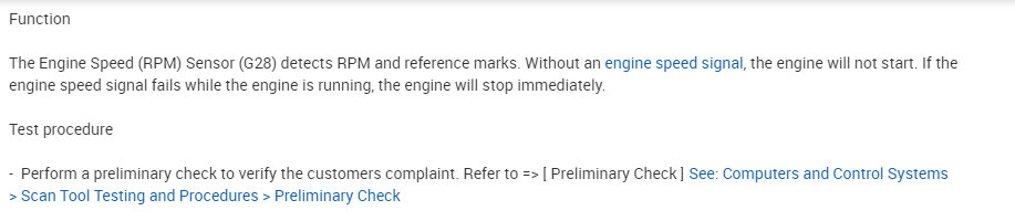

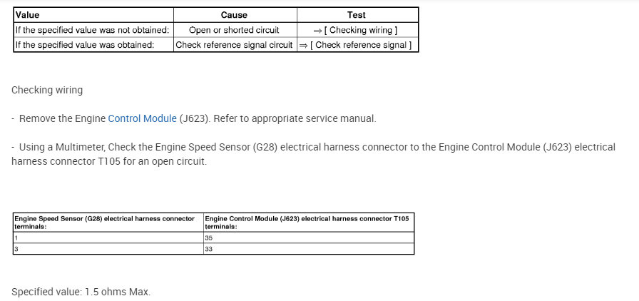

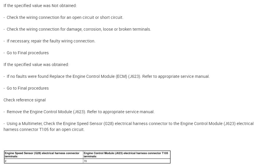

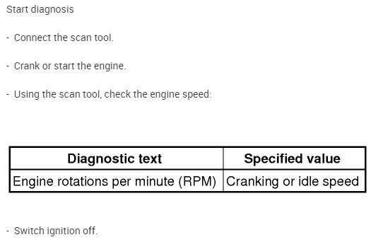

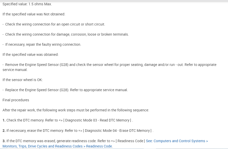

The code indicates there is no RPM signal from the engine speed sensor. Is the vehicle running? If so, what symptoms are you experiencing?
Since the code is specific, I attached diagnostics below for you. Take a look through them and let me know if you are comfortable performing them

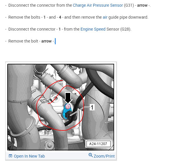

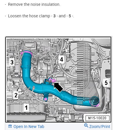

Where is it located?
Sep 4, 2022 at 11:11 PM
  • 110,244 POSTS

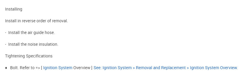

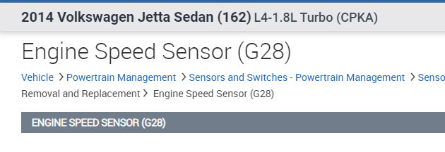

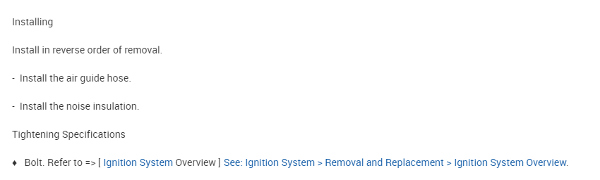

The sensor is located behind the charge air tube. You need to remove it to gain access.
If you look below, I attached the directions for replacing it. I'm not suggesting it needs to be replaced, but the directions to access it are included.
Let me know how things turn out for you.
