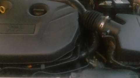

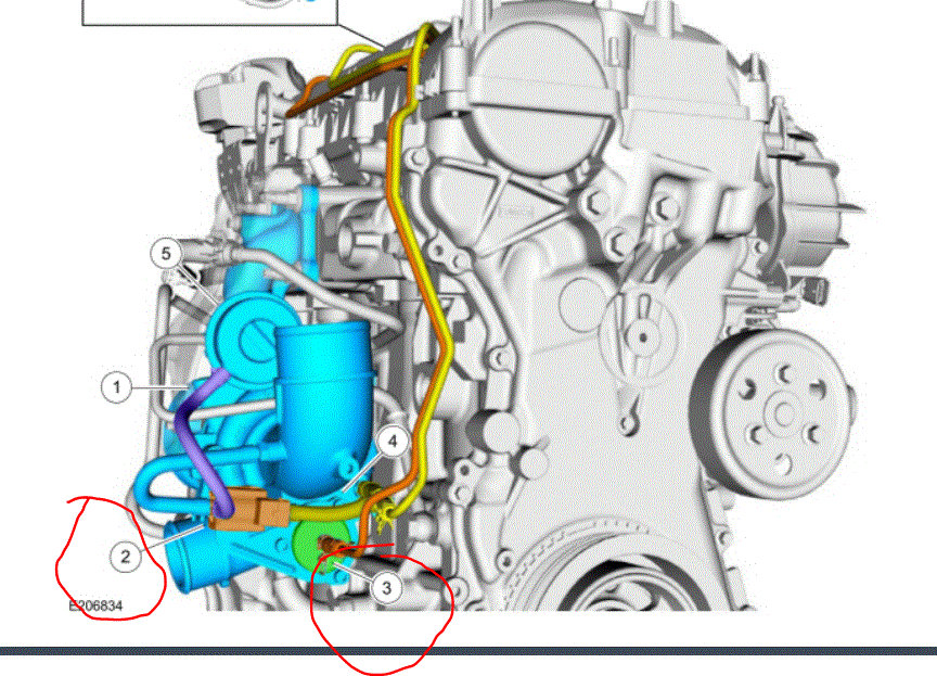

The code is related to a turbo under boost. That is why you are having a power loss. Can you describe the noise? Better yet, could you record it and upload it for me to hear?
The issue can be a bad turbo, the wastegate is stuck open, the wastegate control hose is disconnected or broken and the list goes on.
I attached a pic below of the unit. You can see all the hoses in the pic. Make sure nothing is disconnected or damaged.
Let me know about the sound.

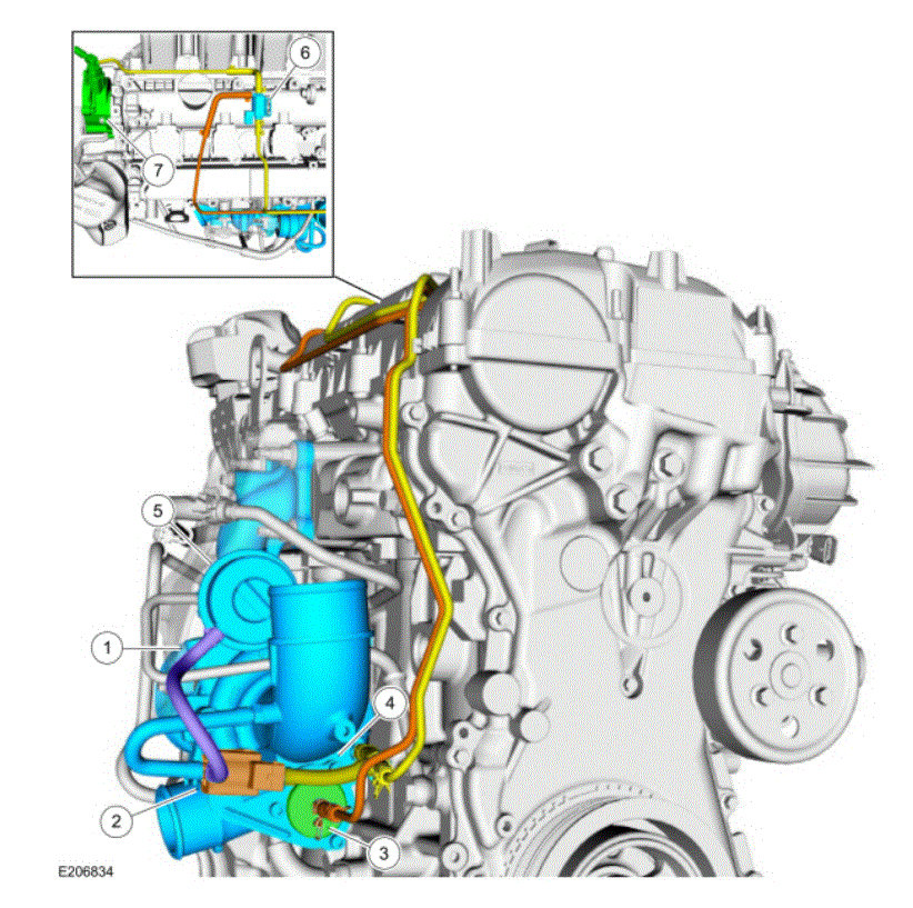

I suspect it has something to do with the waste gate. Do me a favor, check the two locations I circled on the picture below. Number 2 is the wastegate regulating valve and 3 is the bypass valve. Check to make sure nothing is disconnected or broken.

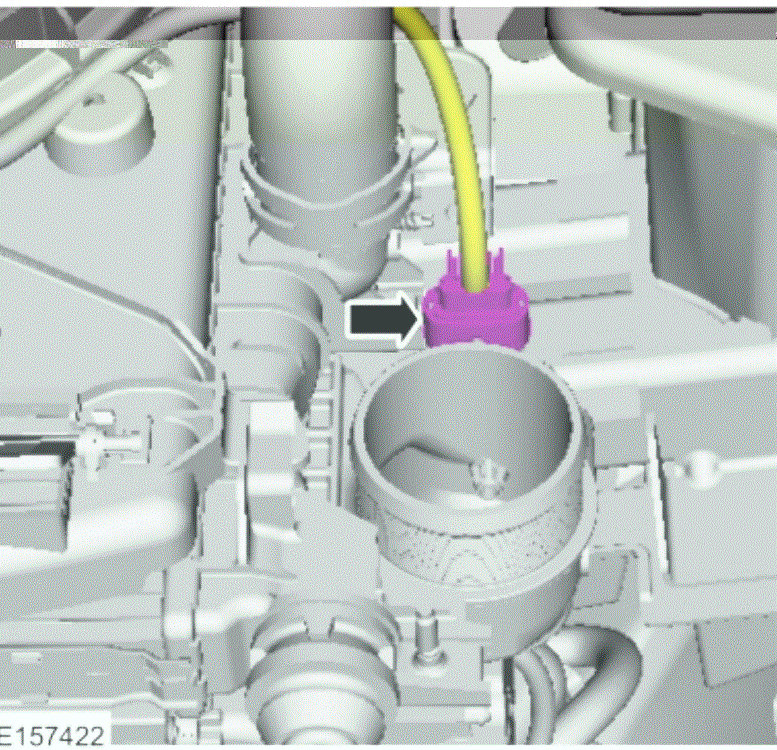

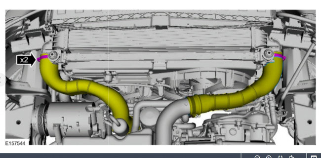

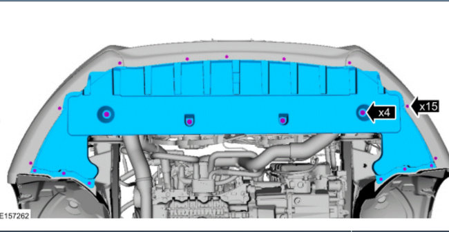

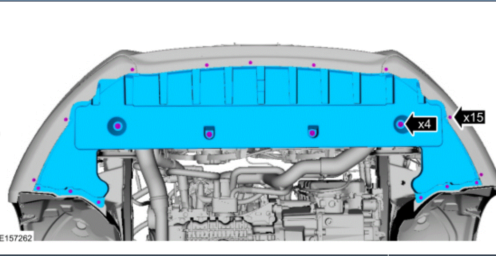

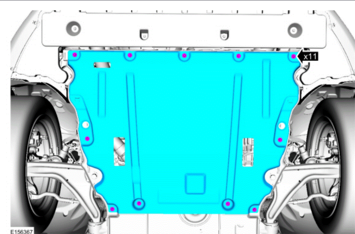

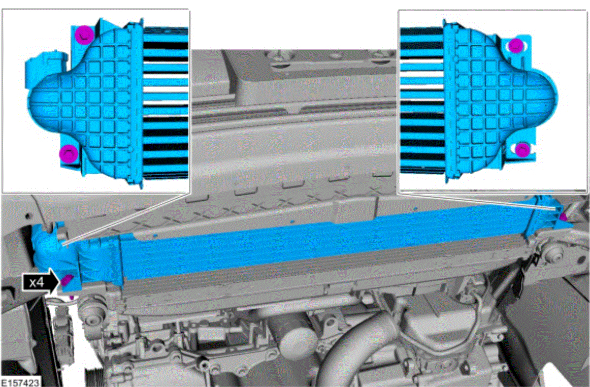

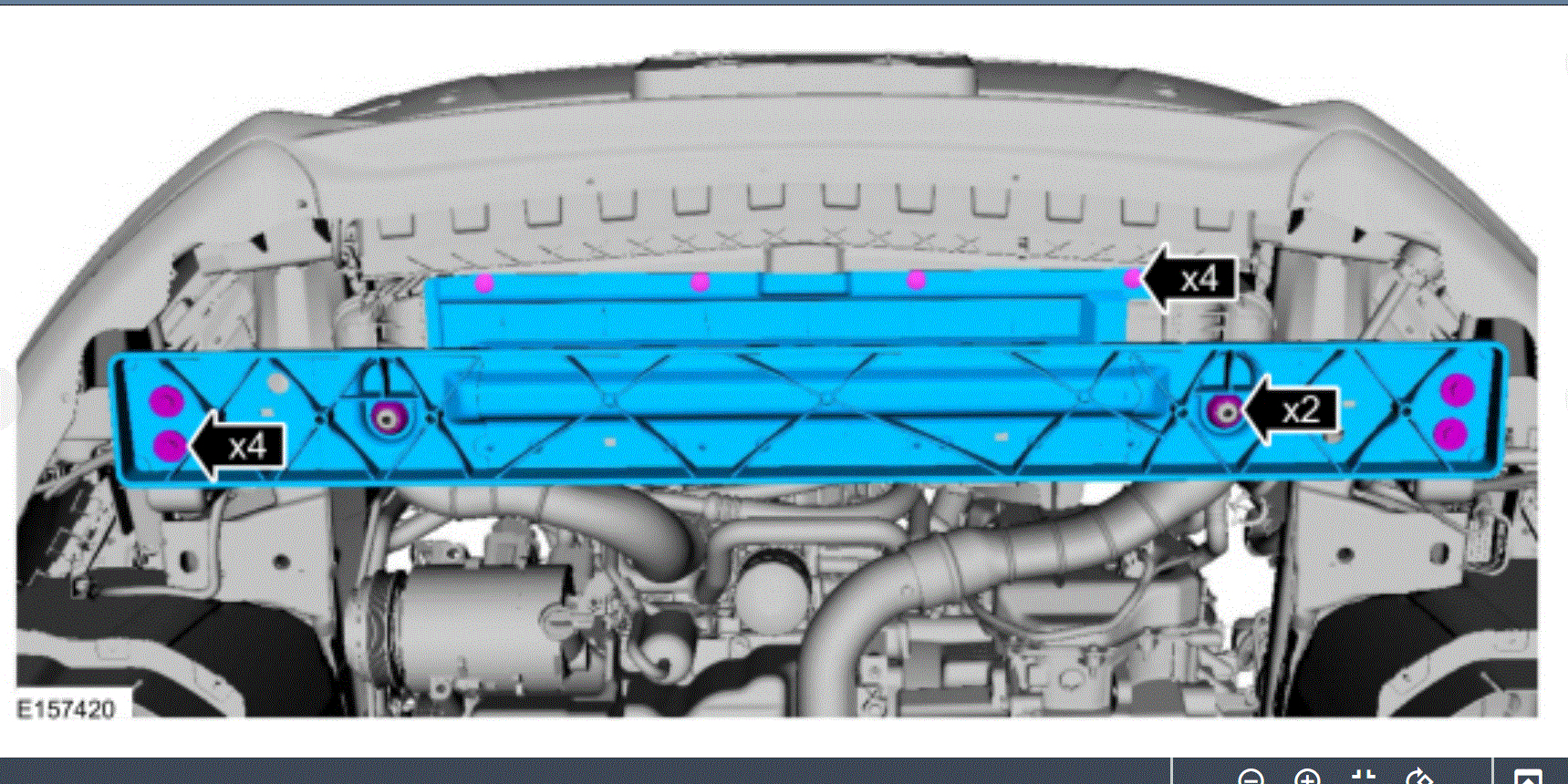

The inter-cooler is at the bottom of the radiator support. Here are the directions for removal and replacement. The attached pics correlate with the directions.
_______________________________________
2015 Ford Fusion FWD L4-2.0L Turbo
Charge Air Cooler (CAC)
Vehicle Powertrain Management Fuel Delivery and Air Induction Turbocharger Inter-cooler Service and Repair Removal and Replacement Charge Air Cooler (CAC)
CHARGE AIR COOLER (CAC)
303-12B Intake Air Distribution and Filtering - 2.0L EcoBoost (184kW/250PS) - MI4 2015 Fusion
Removal and Installation
Removal
NOTE: Removal steps in this procedure may contain installation details.
image WARNING: Before beginning any service procedure in this section, refer to Safety Warnings in section 100-00 General Information. Failure to follow this instruction may result in serious personal injury.
Follow the health and safety precautions.
Refer to: Health and Safety Precautions (100-00 General Information, Description and Operation) .
With the vehicle in N , position it on a hoist.
Refer to: Jacking and Lifting - Overview (100-02 Jacking and Lifting, Description and Operation) .
Remove the retainers and the splash shield.
pic 1
Remove the retainers and the front under-body shield.
pic 2
Remove the retainers and the lower radiator support.
Torque : 18 lb.ft (24 Nm)
pic 3
Loosen the clamps and disconnect the CAC inlet and outlet tube.
Torque : 44 lb.in (5 Nm)
pic 4
Disconnect the electrical connector.
pic 5

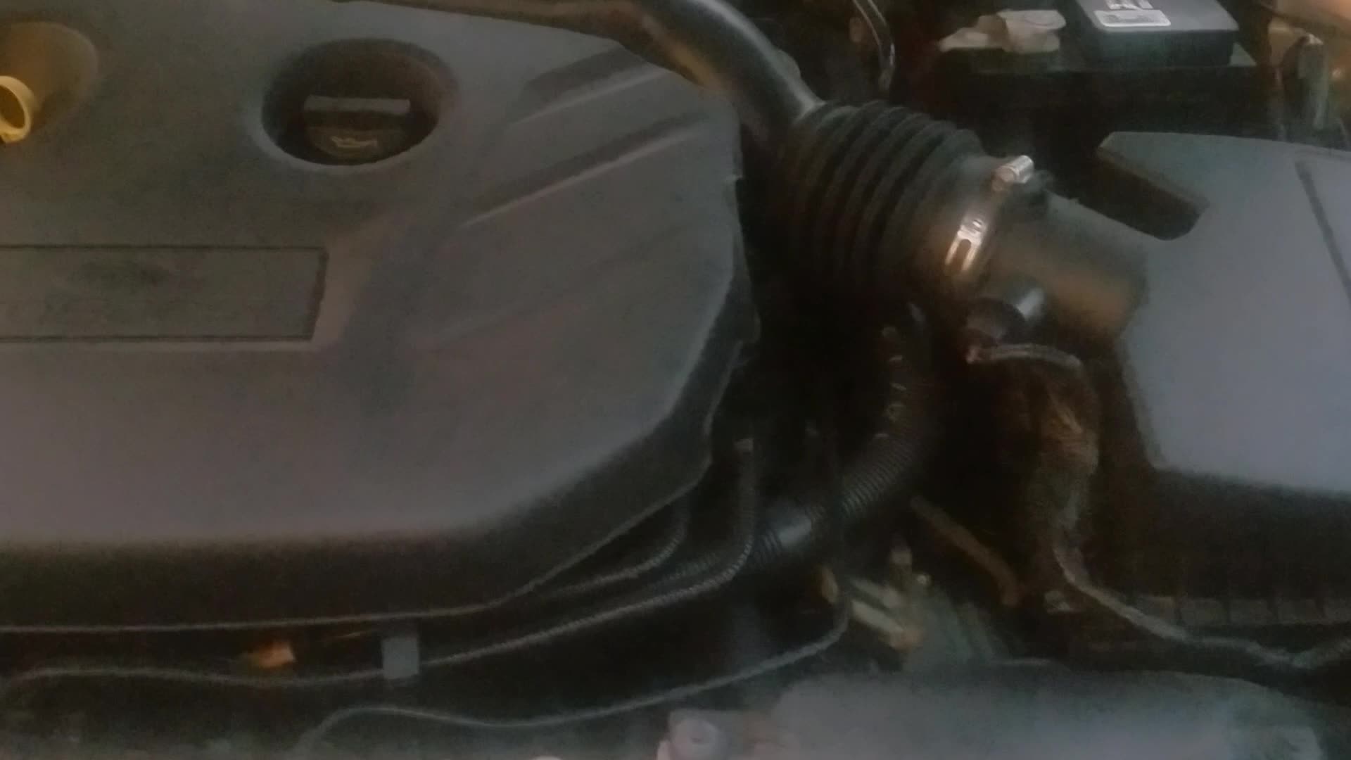

Remove the bolts and the CAC .
Torque : 53 lb.in (6 Nm)
pic 6
