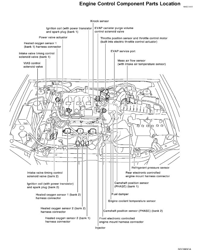

Hi, I have an code p0227 Throttle Position Sensor 2 and the parts store told it could be in the throttle body or the accelerator assembly. I can start the car but when I press the accelerator no response. Could you help me which part do I have get?
Thank you

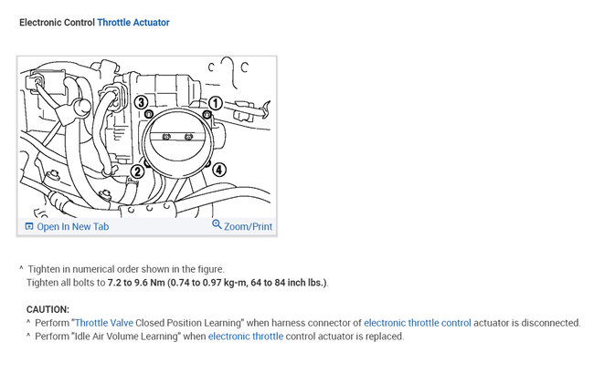

It looks like the throttle body has the TPS built into. Here is a guide to help walk you through the steps of the repair and a video to show you how to clear the codes:
Throttle Body -161198J103 $748.91
and
https://youtu.be/ahK_eucFi-k
I would try a service before I replaced the unit. Check out the diagrams (below). Please let us know what happens.
