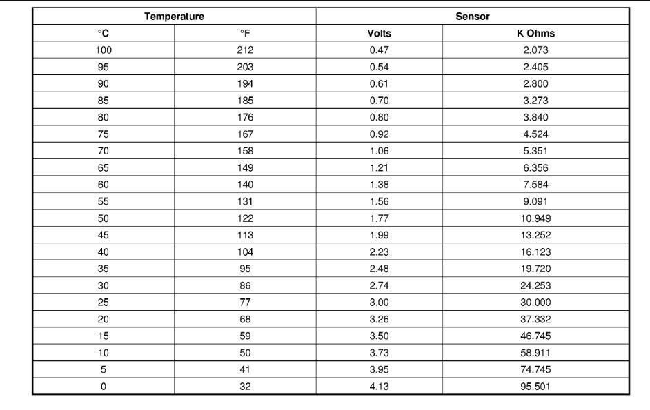

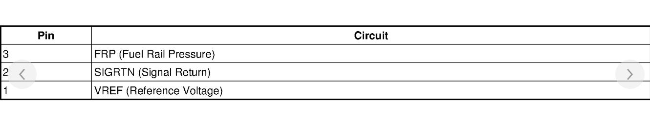

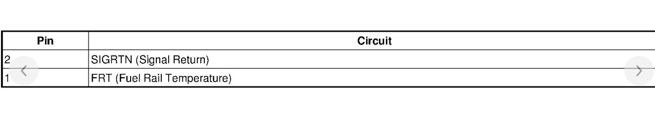

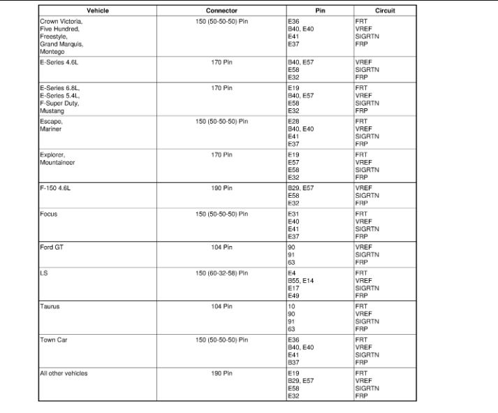

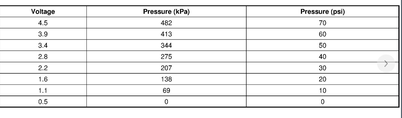

Good morning,
This sounds like a wiring issue. You could have corroded connections or a wire harness issue. You have replaced the components for the system but the controls could be the issue.

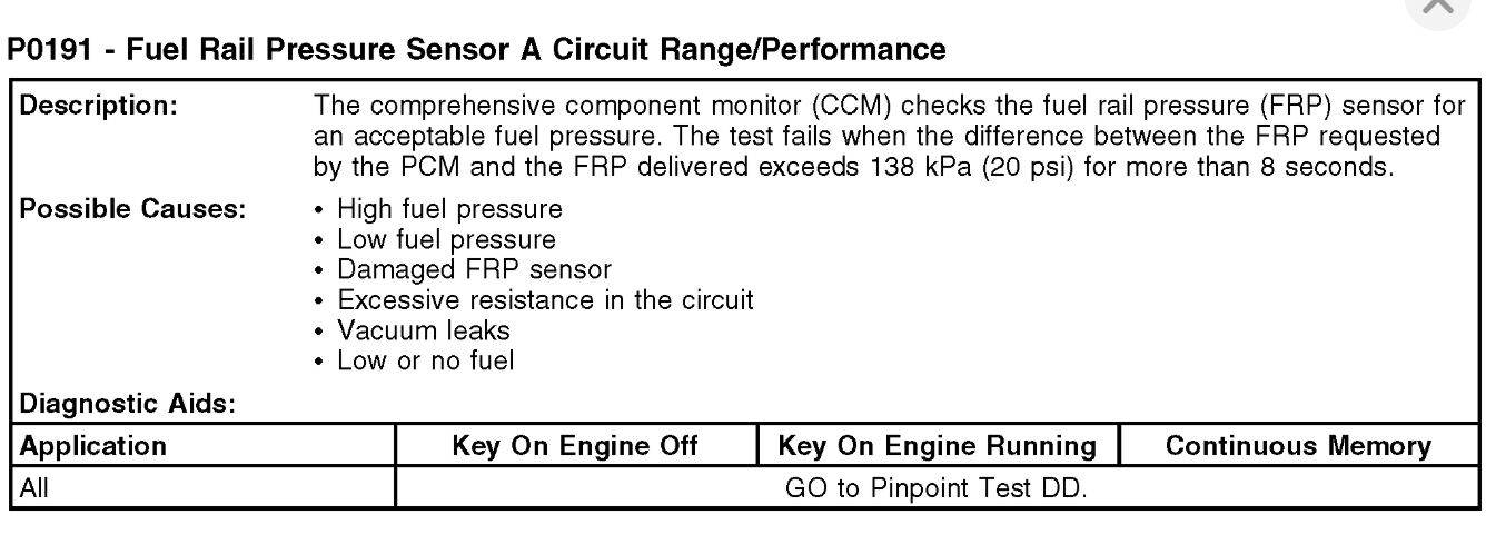

I attached some possibilities for you to view along with a flow chart. You will need a scan tool for some of the steps.
P0191
Descriptor
Probable Causes
Circuit Resistance High
Fuel Rail Pressure (FRP) Relay Sensor Damaged
High Fuel Pressure
Low Fuel Pressure
Low or No Fuel
Vacuum Leaks

FRP SENSOR VOLTAGE AND PRESSURE SPECIFICATIONS

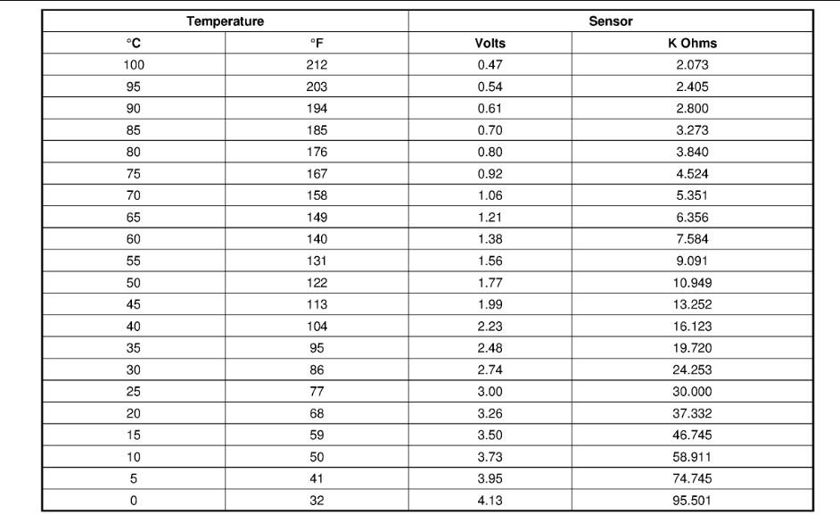

FRT SENSOR TEMPERATURE, VOLTAGE, AND RESISTANCE SPECIFICATIONS

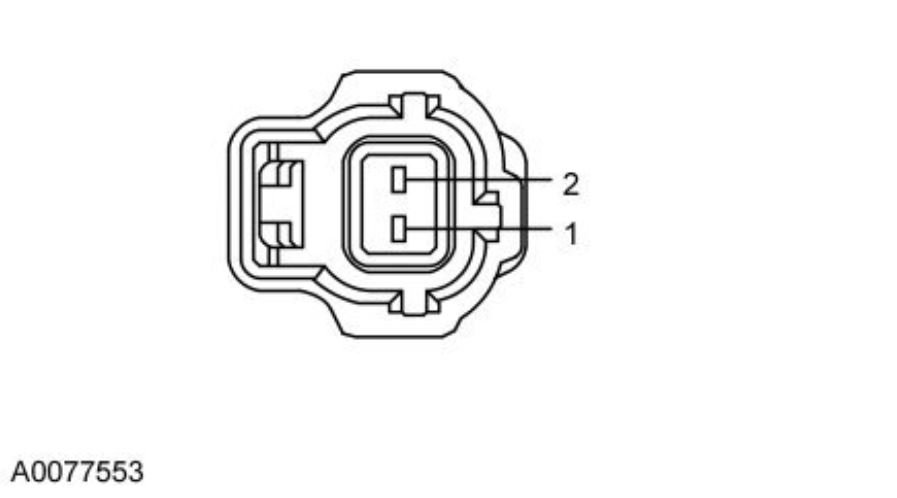

Fuel Rail Pressure (FRP) Sensor Connector

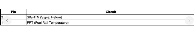

Fuel Rail Temperature (FRT) Sensor Connector

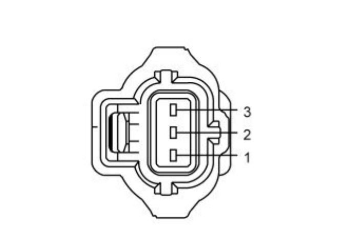

Fuel Rail Pressure Temperature (FRPT) Sensor Connector

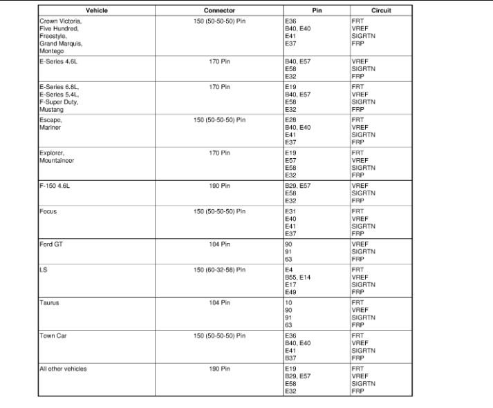

Powertrain Control Module (PCM) Connector
For PCM connector views or reference values, refer to Section 6 See: Computers and Control Systems > Diagnostic Trouble Code Tests and Associated Procedures > SECTION 6: Reference Values.

Thanks. After checking the relays and sensors, I decided to check the Fuel Pump Driver Module. Gave it a wiggle and got a jump in fuel pressure, so replaced the Module and everything is good now.
