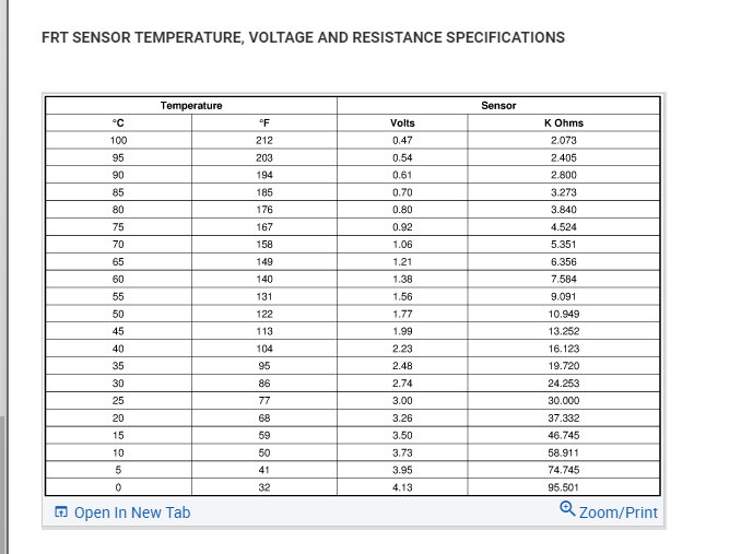

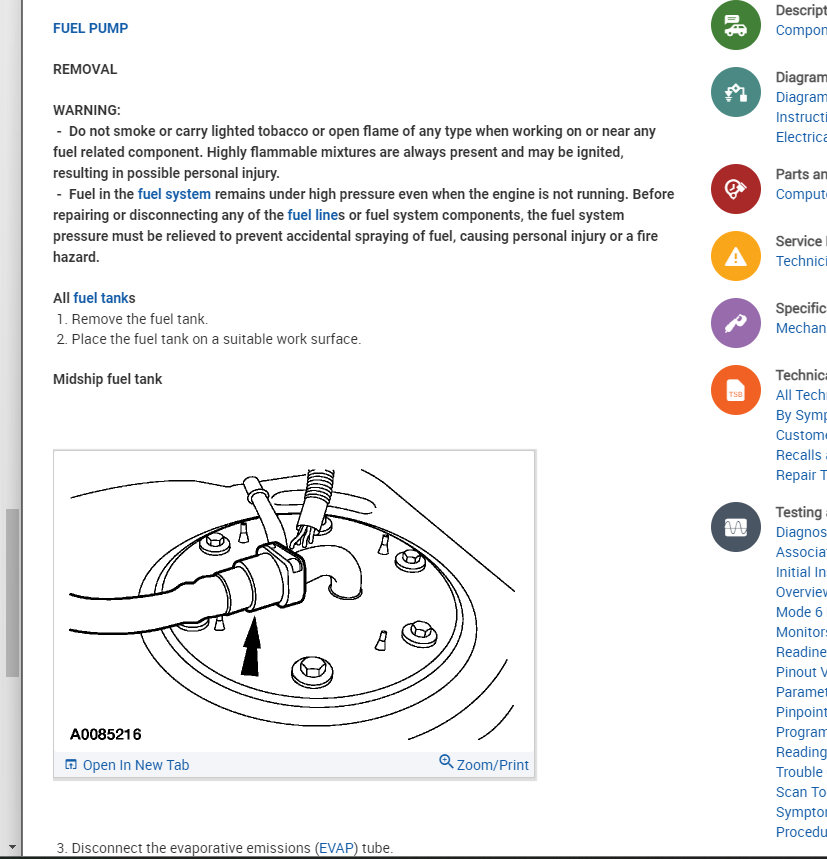

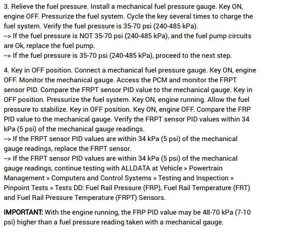

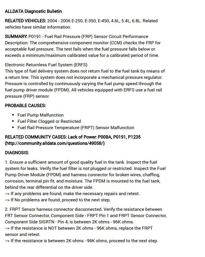

I'm Dan. It appears that your fuel pressure key on, engine off, is below spec and points to a fuel pump replacement. I've attached a Ford TSB to help you with this code. Follow the steps in the attached document and you should be ok. Let us know what you find.
Nov 12, 2021 at 1:56 PM
MICHEL PETRIN

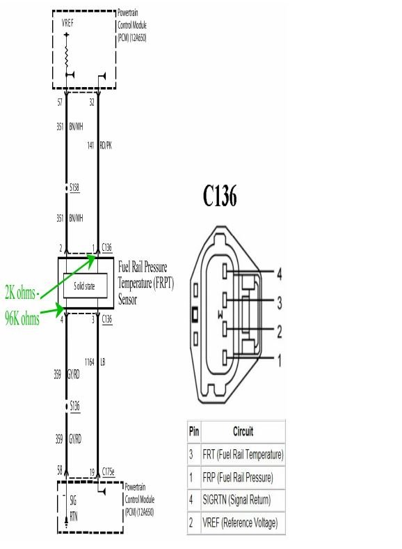

Thanks just did the test and I have 4.21k Ohms on it.
Still one more question.

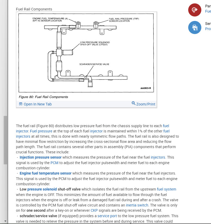

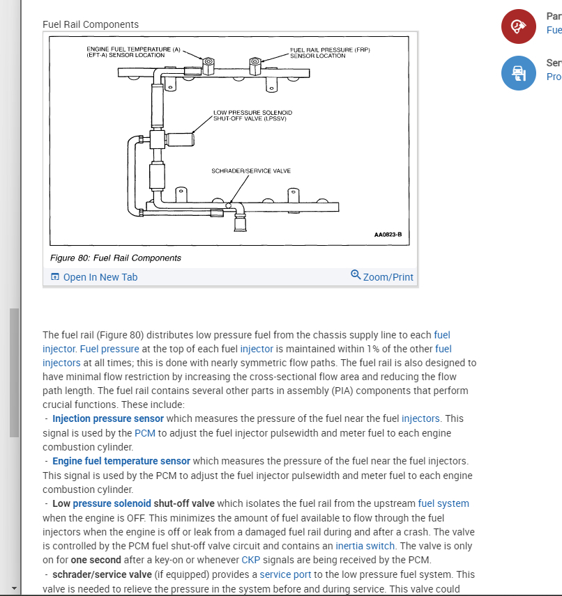

Where is the fuel pressure temperature sensor? I know where is the pressure sensor but no idea about the temperature sensor.
Is the pressure sensor is also used for temperature?
Nov 12, 2021 at 2:54 PM

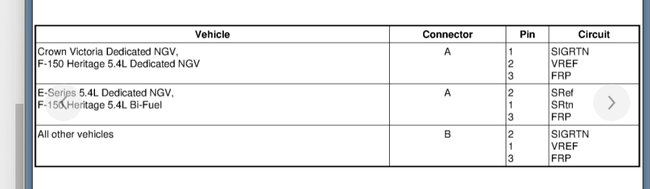

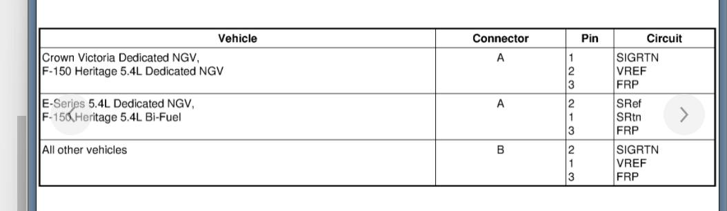

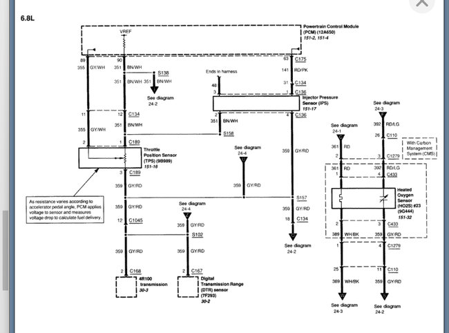

That is correct. The fuel pressure and temperature sensors are included on the same sensor if it is equipped that way.

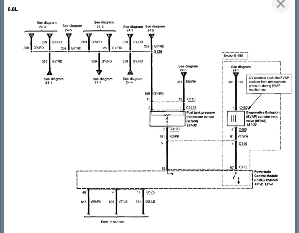

The wiring diagram for this engine shows that you have an injection pressure sensor and then a separate Fuel tank pressure sensor.
I attached those below.

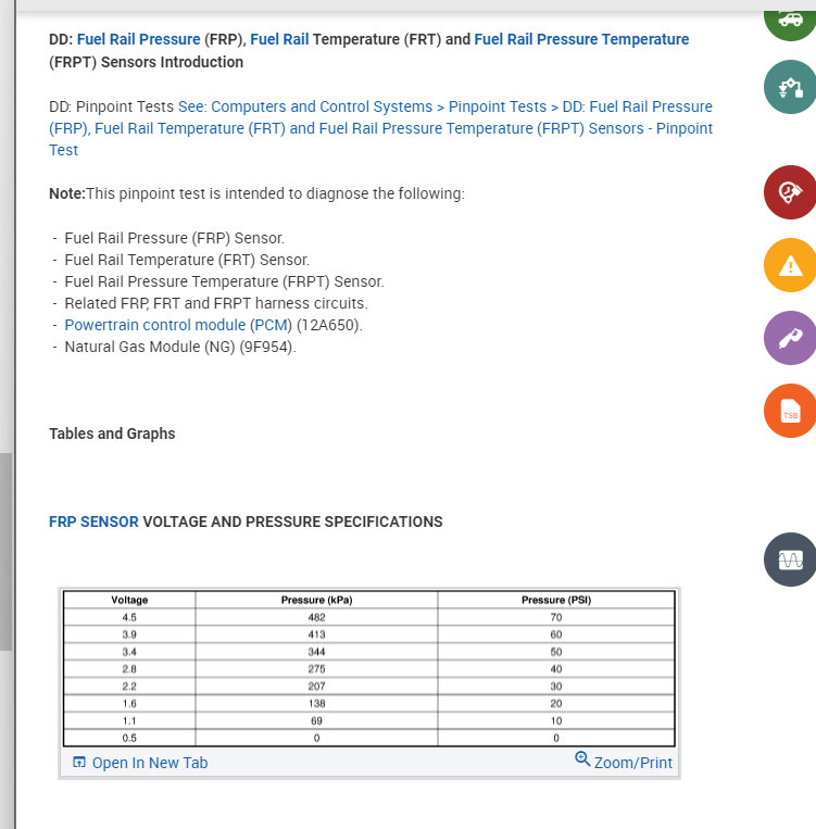

However, it looks like your pressure sensor is ok as it is within the specified range.
So that means we need to re-evaluate why you only have 20 PSI when you turn the key on.

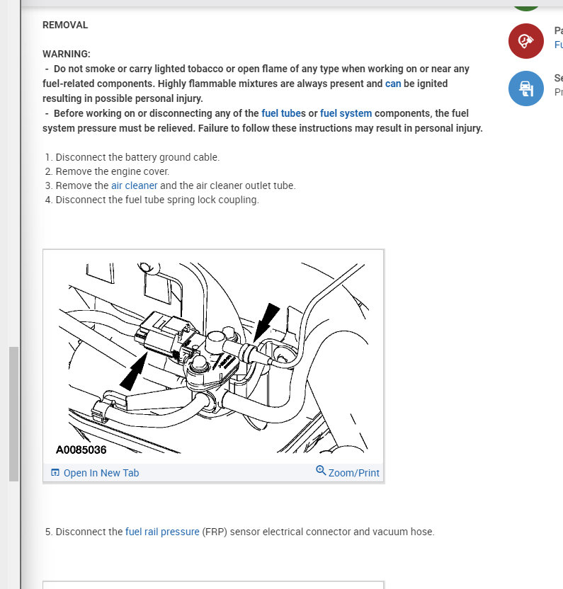

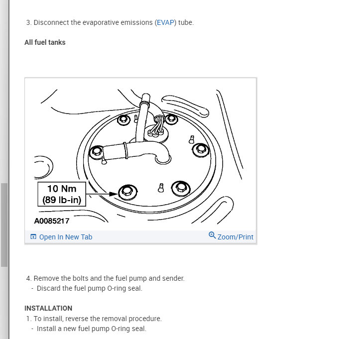

Based on what you have done, I suspect the pump is the issue. So even following through the testing that Dan posted earlier, if you turn the key on and don't get a minimum of 35 PSI then you need to check the wiring to the fuel pump and if is ok you need to replace the pump.
https://www.2carpros.com/articles/how-to-replace-an-electric-fuel-pump
Based on the fact that the PSI is correct when the engine is running, I suspect the wiring is fine, but you just have a pump that is starting to fail.
I attached this info below and let us know what you find. Thanks
