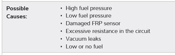

Code p0191 came up. i replaced fuel filter still sputters then replaced fuel rail pressure sensor still sputters, replaced fuel pump still sputters. please help.
Aug 4, 2016 at 10:57 PM
HMAC300
  • 48,601 POSTS
that is a fuel pressure circuit problem. check fuel pressure with a gauge auto parts rent it. see picture for other causes.

I have a tuner its data log says fuel jumps from 40 down to 10 shoots up to 75 i guess it is psi.

check it at idle not reving it up it should be in the 40 range all the time if not then it is the pump or regulator soit with a gauge not electrically.

reading your post said you have a tuner and that may be your problem. the fuel pressure should not go below or down to 10 psi under any condition unless it has been shut off for days. the regulator may be part of fuel pump have the fuel pump driver module checked as the tuner may be messing that up causing your problem.

Hey Ken, i installed fuel pump driver module Saturday and fuel pressure is a steady 40 psi drove it for about 30 min. Ran fine hopefully it's fixed haven't drove it since
