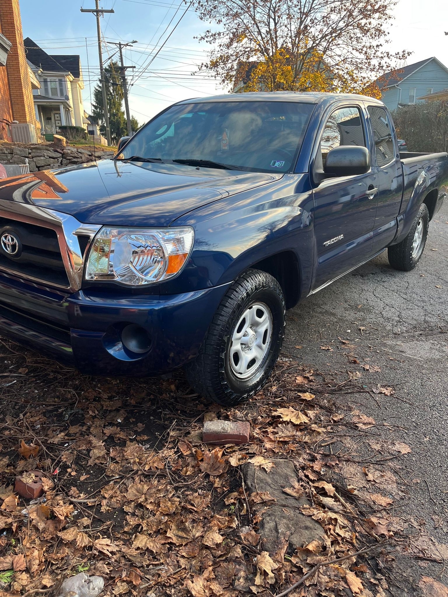

New battery, new alternator, new ground, new 2- O2 sensor, new MAF sensor, new fuel regulator, new TPS sensor,good fuel pressure ,no vacuum leak, replace engine control ECM, new spark plug, new coil, new injectors,and the truck running rich with code P0172 .Thanks Mo

That is a nice truck thanks for the image. I would remove the new spark plugs and see how they look, please upload an image so I can see.
