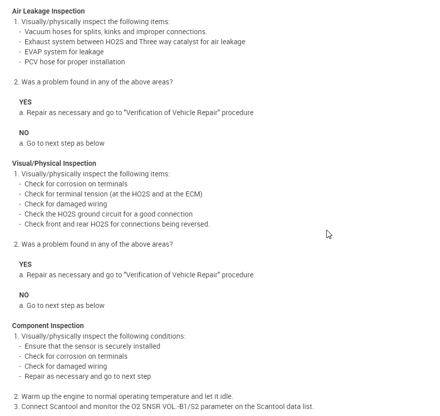

I’ve had the downstream 02 sensor replaced twice and check engine light is back on. I thought the first sensor might have been faulty. Car is running good. I’m not noticing any issues otherwise when driving it. Any other issues that could be contributing to this and what do you recommend? Thanks.
Feb 29, 2020 at 9:19 AM

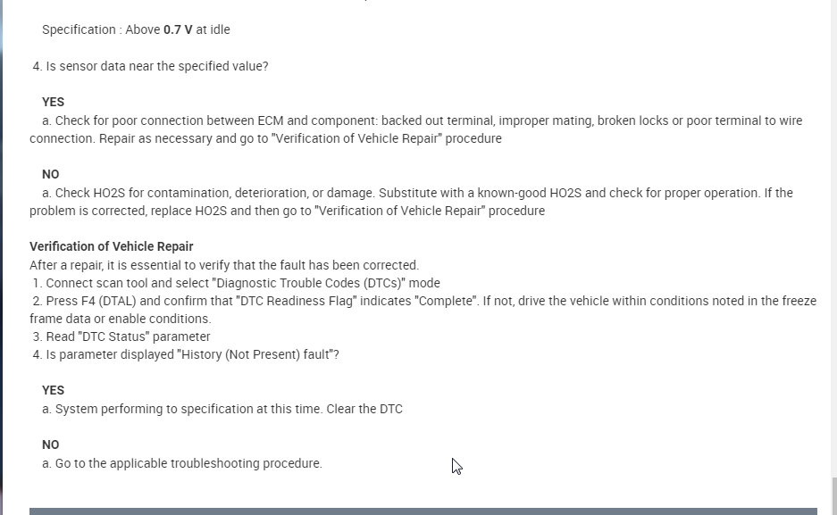

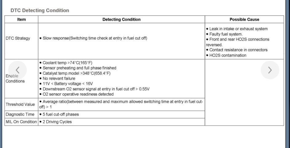

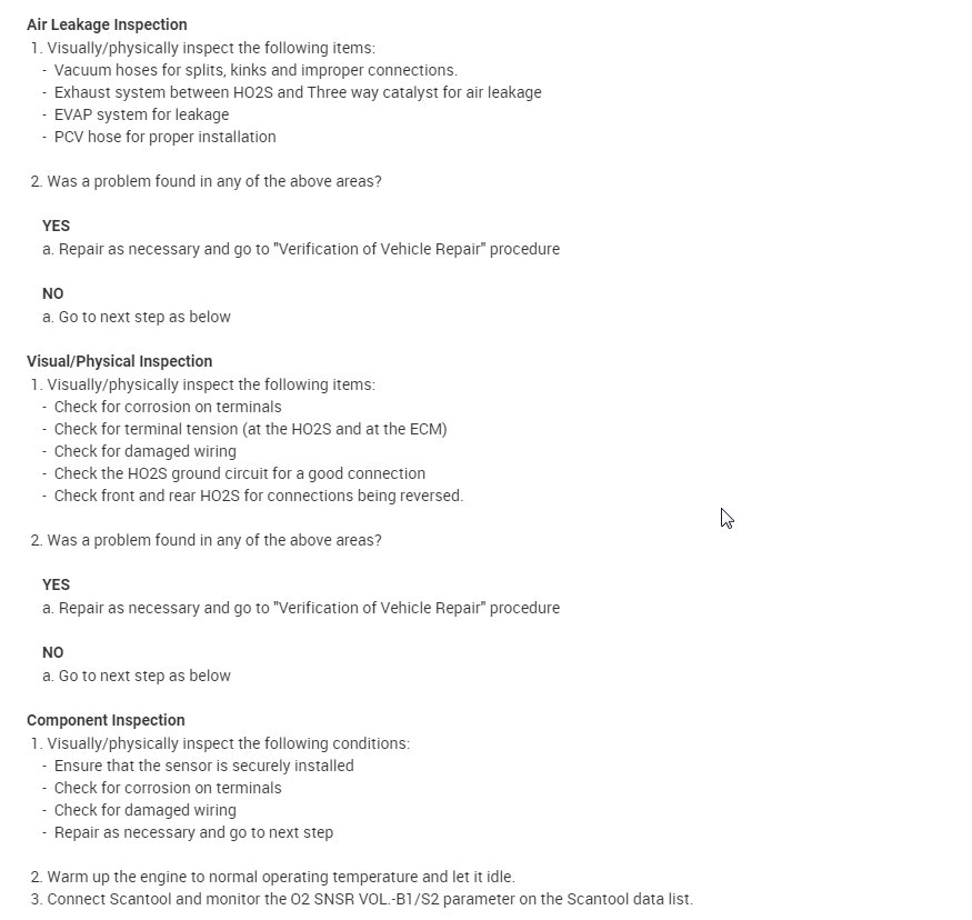

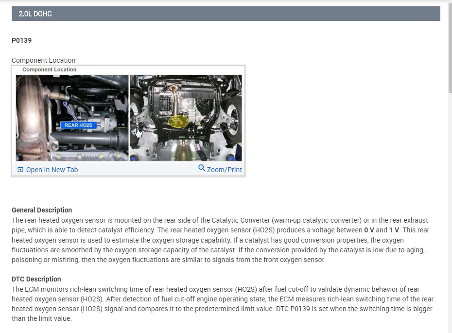

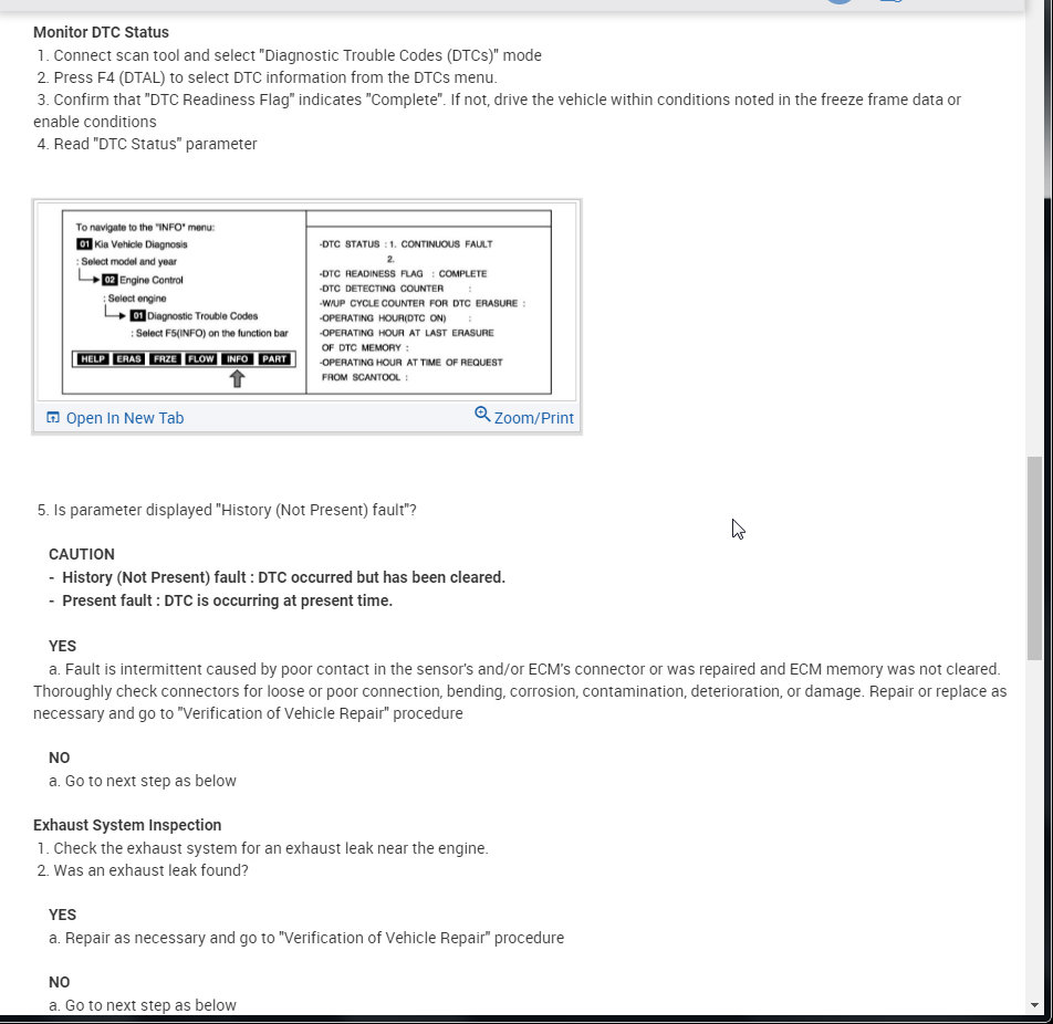

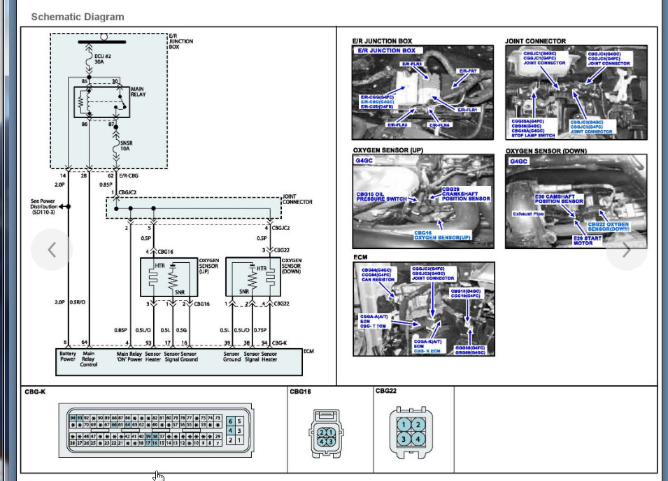

I suspect you have an air leak causing the o2 sensor reading to be off which is setting the code.
I attached the testing that we need to go through in order to determine the cause. Unfortunately there is no easy way to figure this out other than to run through the testing. I would not replace the sensor again as I think it is clear there is another issue. If you take a look at the second attachment it lists the possible causes which includes an air leak.
Let's run through this and see what we get. I am not sure if you are going to do this or have someone else. Either way, just let me know the results and we can walk through it together. Let me know if you have questions. Thanks

It could be the cat but I would think we would have other codes with this because we have the ability to monitor the efficiency of the converter.
I would make sure he is going through this test and not trying to diagnose this by his own testing. I suspect that is why he put the sensor on it because if you follow the testing through, it doesn't direct you to replace the sensor unless it was damaged. Clearly if this code keeps coming back then he is not fixing it. This is where it can get costly is when someone is replacing parts that are not actually diagnosed.

I understand. There is no name for the testing. It is just the diagnostic test for the P0139 code. I would ask that they follow the steps laid out in the diagnostic test for this code and tell you what they find.

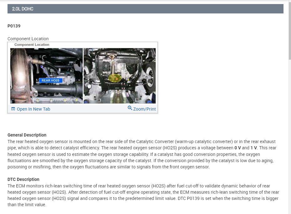

Hey Ken. So the mechanic I went to replaced the O2 sensor again in case the one replaced in December was faulty. My car is at the dealer now and they are saying it is the 02 downstream sensor that needs replaced. Of course the dealer is recommending a Kia brand sensor to be put in, which would be over $400.00. I asked the dealer if the sensor the mechanic used is not compatible with my car and he would not say that is the case. The dealer said maybe I want to go back and talk to the mechanic that put the sensor in. The dealer is not finding anything else wrong besides the 02 sensor being bad. I have no clue what to do. Thoughts?
Mar 12, 2020 at 8:28 AM
Clearly I would not want to replace the sensor again and it not work. So going back to the other mechanic doesn't seem wise because they are just going to replace it again with the same one.
I would do one of two things. First, ask the dealer to refund your money if they replace it and it doesn't work. Second, go back to the other mechanic only if he is willing to use the Kia sensor and credit the one you just put into it towards this one.
I find it hard to believe that the sensor that you put in is not compatible. At best it is just a cheap part and you are getting defective ones which is possible with these aftermarket parts. Did they say how they tested the vehicle? Did they write up their diagnostic steps on the repair order? I am just wondering if they tested the wiring. I would assume they did but clearly this is something we need to make sure or we will just keep putting sensors in it.

So apparently with Kia and Hyundai’s it is recommended to use OEM sensors versus aftermarket for best performance. I will look on the paperwork and see what all was tested and let you know at the dealer. The dealer did give me the sensor back that was in the car that was put in 3 weeks ago. Unfortunately, I cannot tell the brand of the sensor and it is not written on the paperwork from the mechanic who put it in. He did claim it was a name brand sensor. I originally purchased the sensor in December for $120.00. I was thinking about contacting the mechanic to see about getting a refund on the sensor. Another mechanic I spoke to online said that the mechanic’s supplier would take the sensor back and refund the mechanic. The issue I’m concerned about is after the mechanic replaced the sensor a second time he said if the CE light came back on then it is not the sensor and something else is causing the issue possibly the CAT. I would assume that the dealer checked everything and the sensor they put in is under warranty I know for a fact. In your opinion do you think the mechanic would refund me the cost of the sensor if I return it to him and advise that the dealer recommended the OEM sensor for the car? He might refute what the dealer said and still think it is another issue and therefore would not be willing to refund me. What do you think? Thanks.
