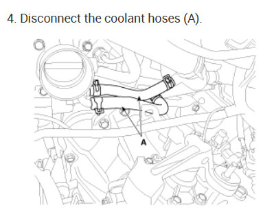

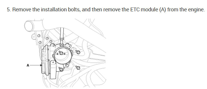

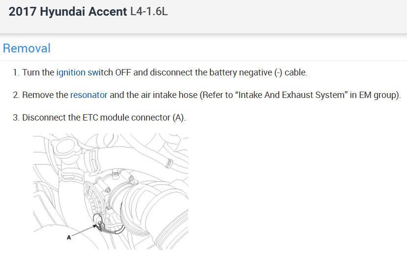

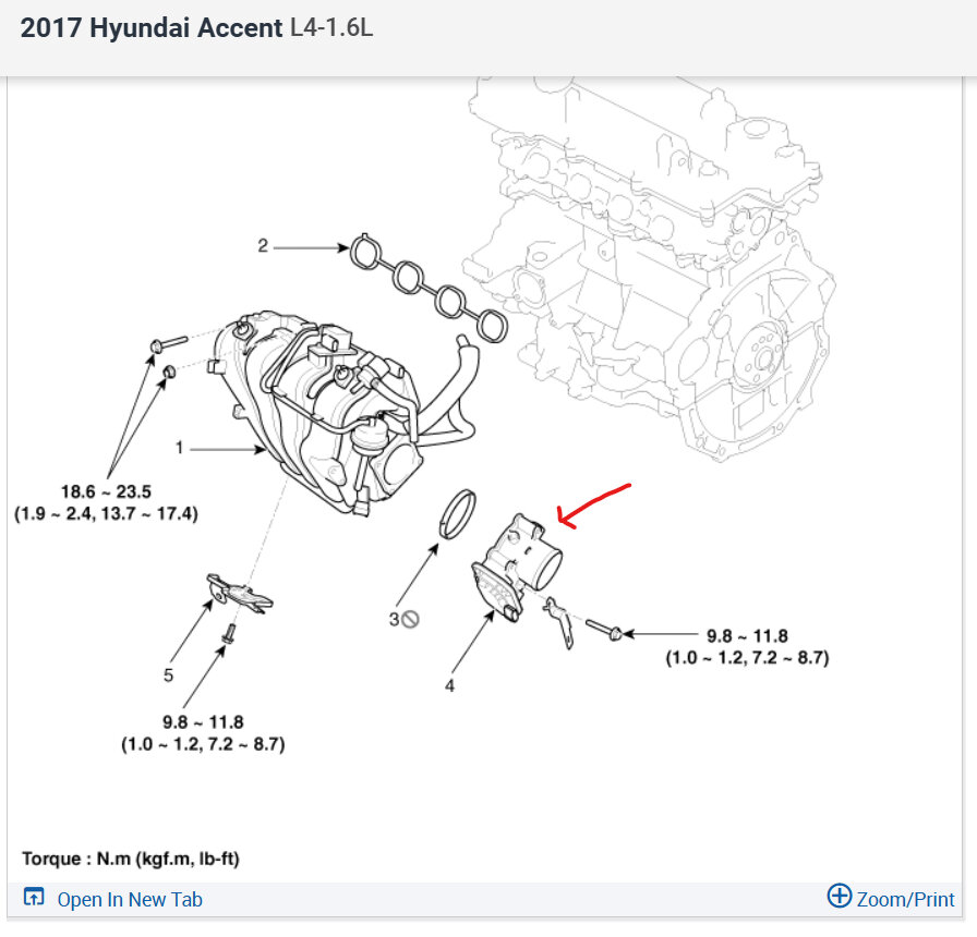

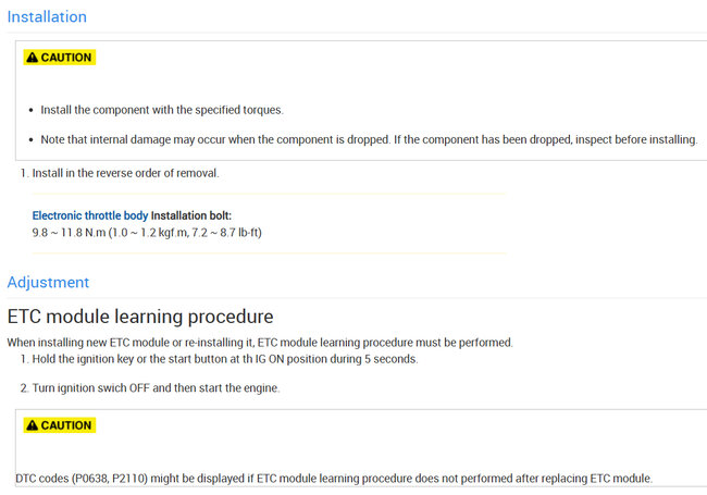

The first codes may cause the other codes BTW. The TPS sensor is inside of the throttle body.
Here is how to change it out in the images below.

Please clear the codes once the repairs are complete. Check out the images (below). Let us know how it goes.
