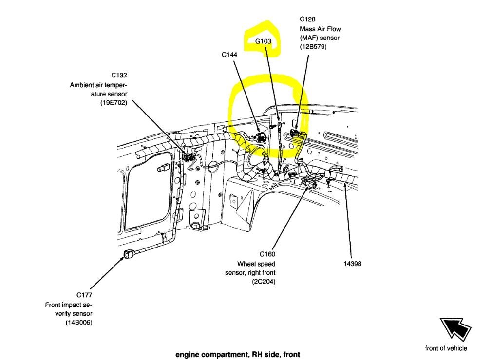

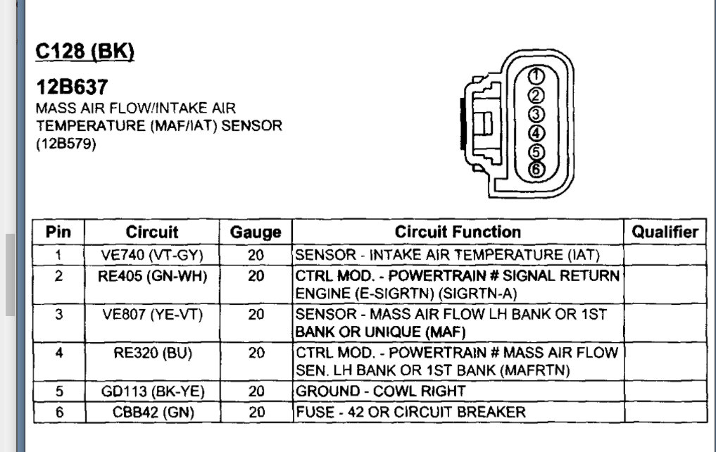

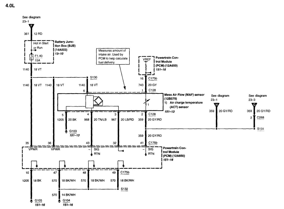

The IAT and the MAF are the same part, so they share the same circuits. Usually when an IAT shows -40 degrees, it means it's unplugged or not responsive. (Open circuit).
You should check the wiring going to the MAF/IAT sensor. Check for 5 volts at the sensor and be sure to check the ground too. I've attached a wiring diagram and the location of G103, the ground point for that sensor.
A good test would be to disconnect the battery and OHMS test the circuits end to end. It really sounds like you have an open wire somewhere.

I checked all the grounds before just out of habit and they're all great including that one you mentioned. I'm going to check the wiring coming from the grounds and it was fine too. And does this have anything to do with what I'm dealing with? Once again, I keep blowing a fuse that I wouldn't think has anything to do with this but every time I start the SUV it blows. It is the number 40 fuse which is for fan clutch PCV valve A/C clutch relay and GCC fan?

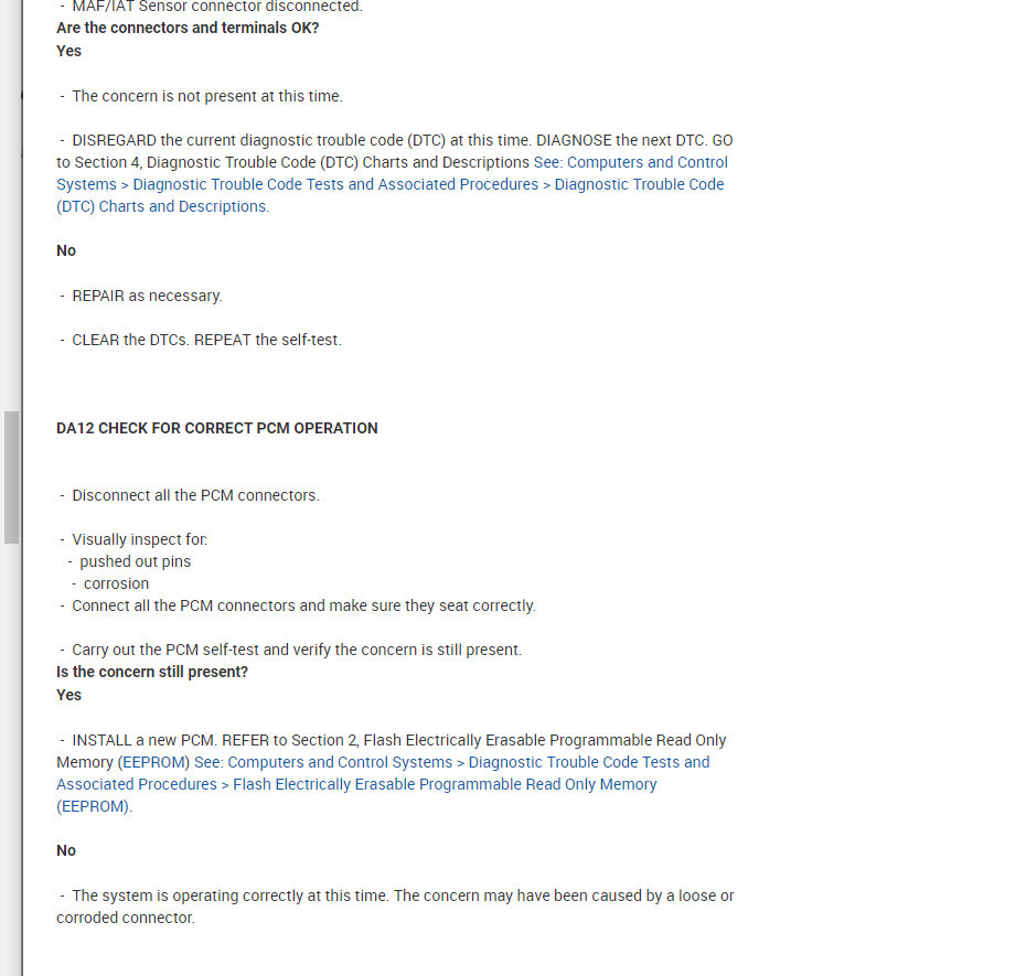

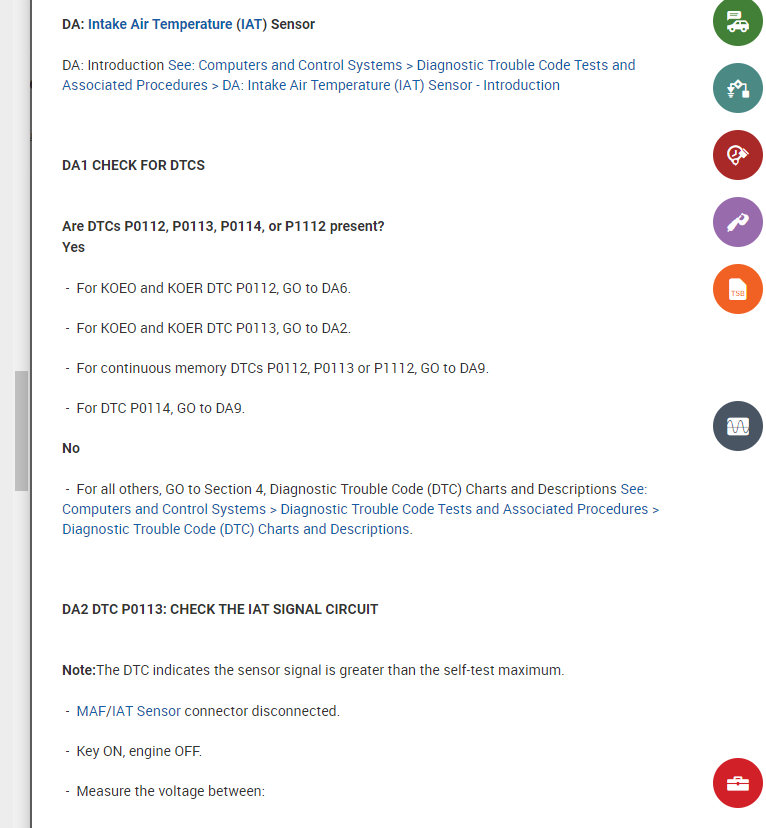

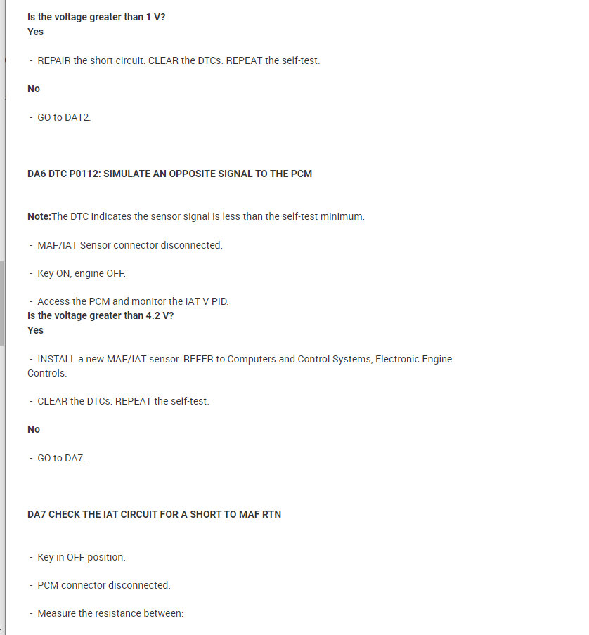

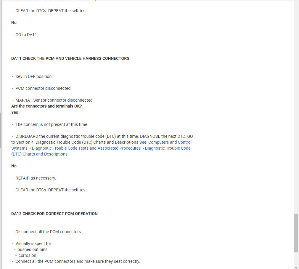

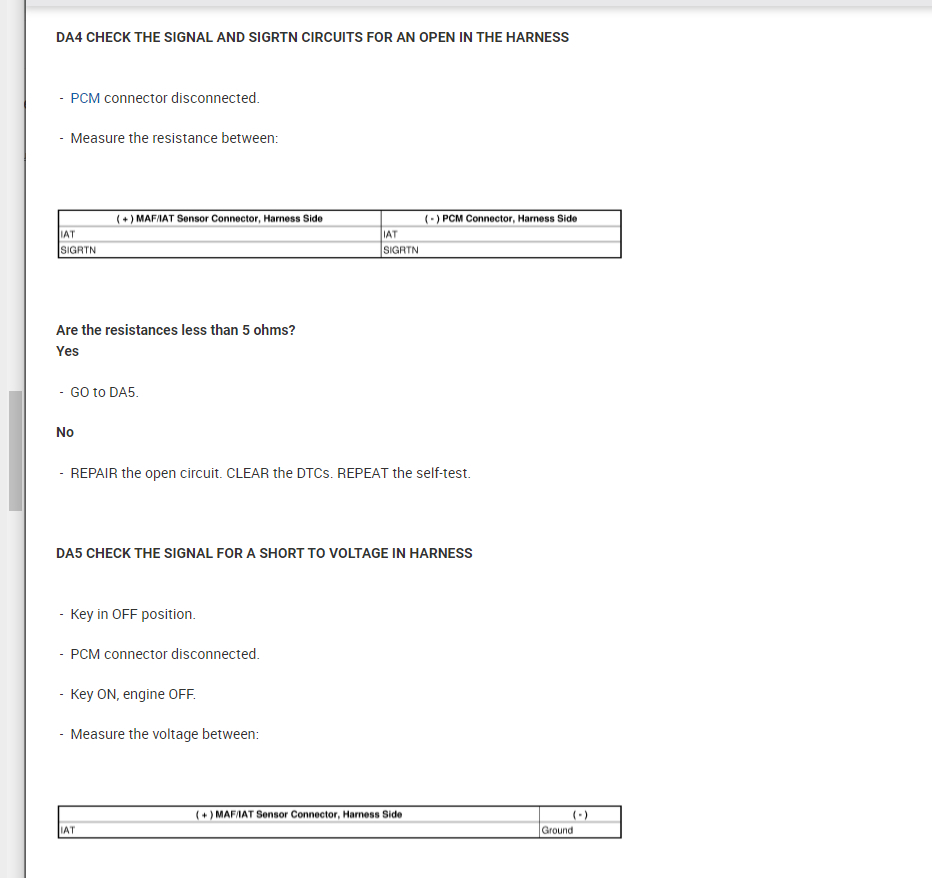

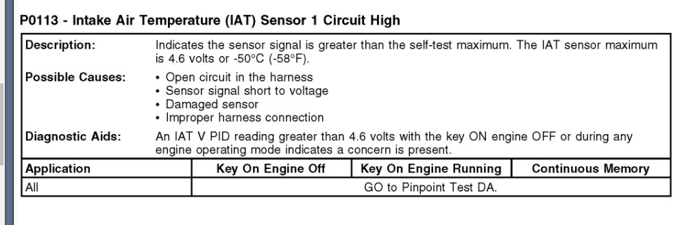

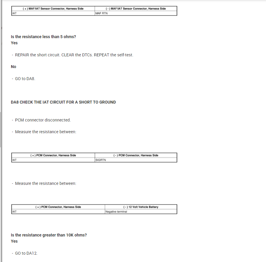

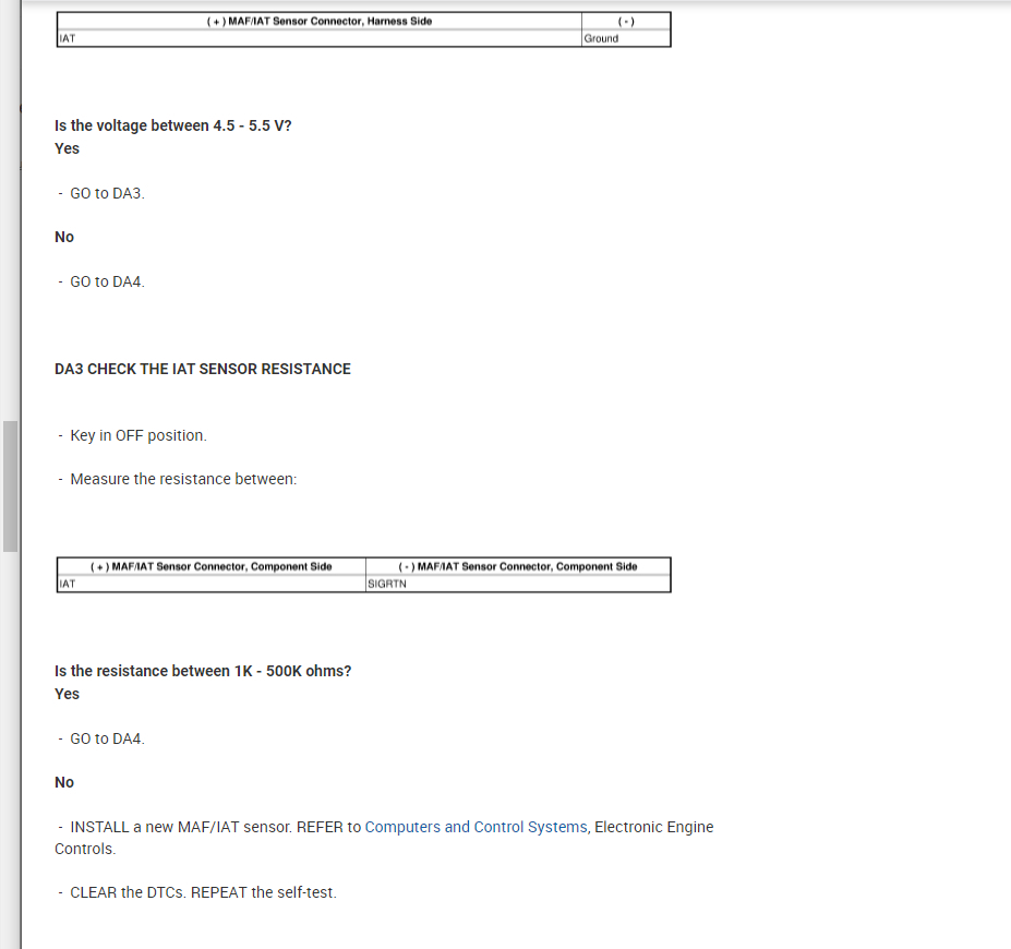

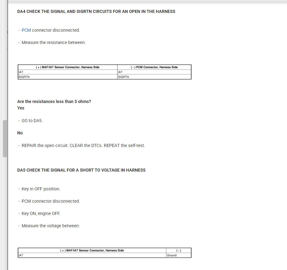

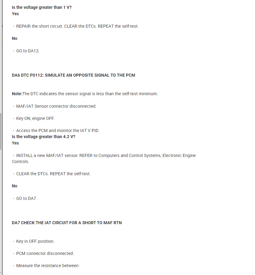

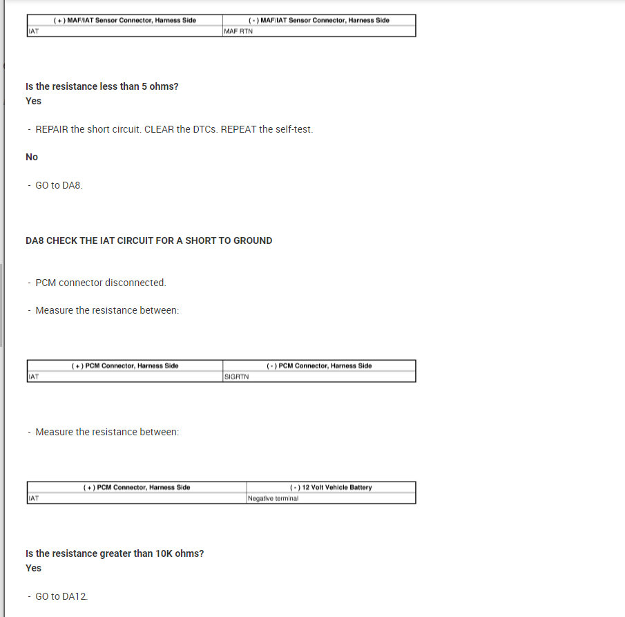

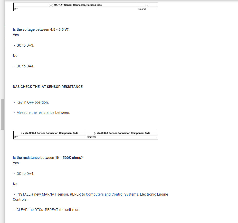

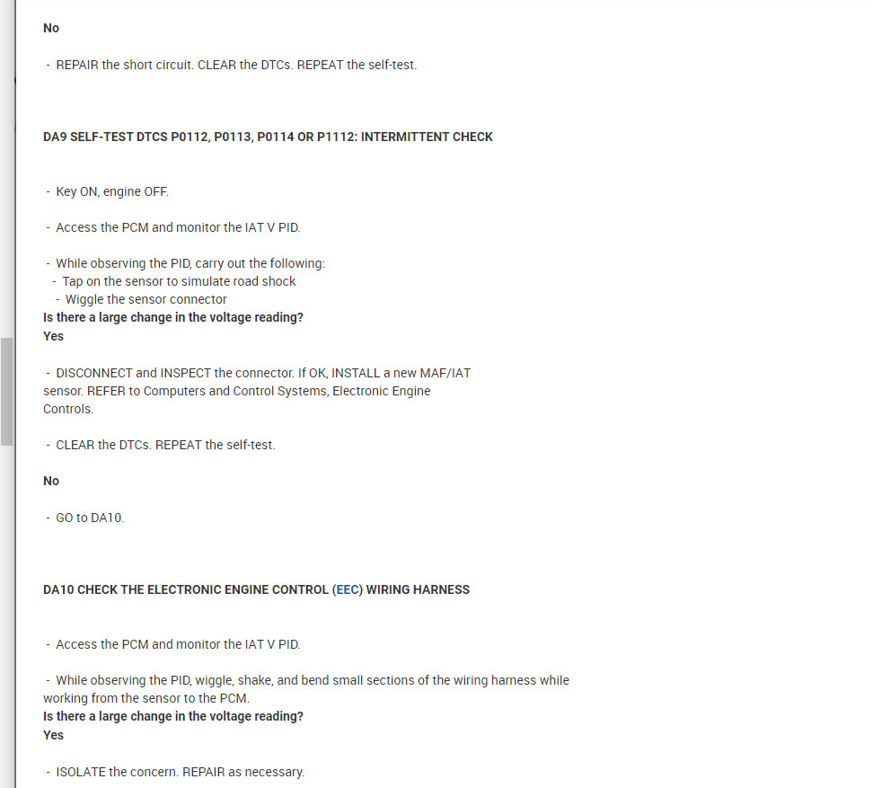

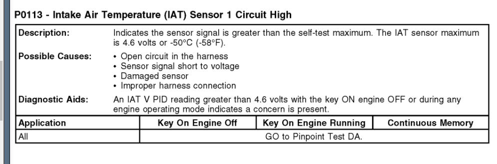

However, I am attaching the exact steps for this code. Clearly you are seeing the issue when you are looking at the MAF and IAT as they are a combine sensor. So, this is an open circuit issue, it is just a matter of finding it.
If the sensor is new, then I agree that it sounds like a wiring issue.
However, I attached all the testing below.
Please run through this and let us know what you find. Thanks
