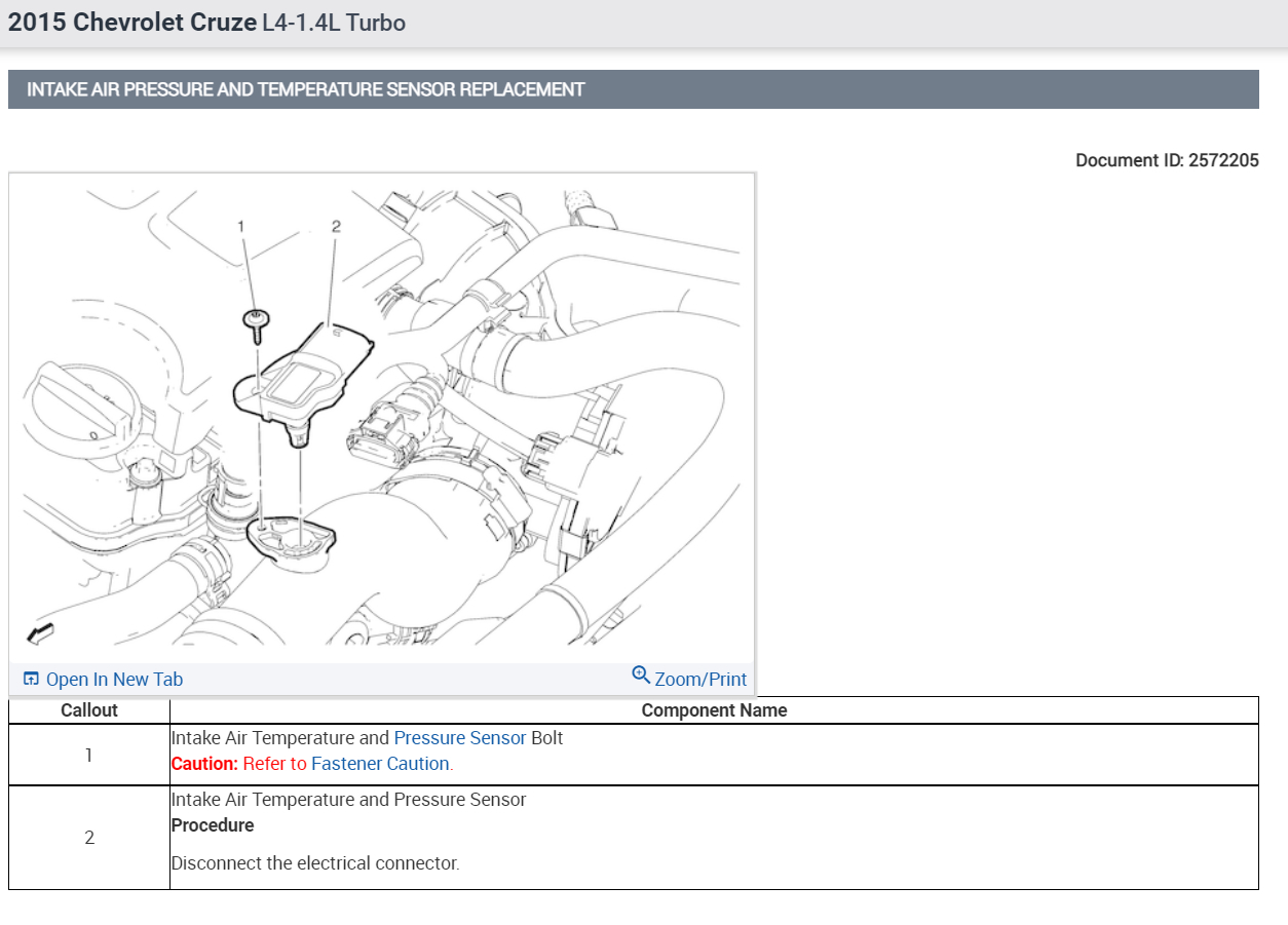

My cooling fan runs on high constantly. I have the engine code P00EB. This relates to Intake Air Temperature B1S3. Where is this sensor located so it can be replaced?

The air intake and pressure sensor is in the air intake tube between the air filter box and the throttle body, here is the location and how to replace it in the diagrams below. Check out the diagrams (below). Please let us know if you need anything else to get the problem fixed.

I had three codes: P0236, P0238, and P00EB. I replaced that sensor, and now I only have P0236 and P00EB. How do I eliminate these?

Did you clear the codes after the repair? Also, you may need to drive the car to help the computer to relearn.
P0236 stands for “Turbocharger/Supercharger Boost Sensor “A” Circuit.”
So, this will be a different problem, please post your new question here, you must be logged in.
