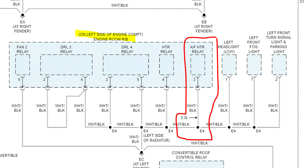

The code above came up so replaced sensors bank 1 sensor l and bank 2 sensor 1, check engine light still on. I read that cheap part might do it, so I replaced bank 1 sensor 1 again with a Denso. still on. Is there a certain way to reset check engine light? Why is the light still on? i need to get it smogged. can you help me?
Jun 11, 2020 at 9:19 AM
  • 110,246 POSTS
The code indicates low voltage, bank 1 sensor 1. Usually that is caused by a connection issue. Have you inspected the wiring to make sure there are no breaks or damage? Also, have you checked the sensor relay? See pic 1 for location.
As far as the check engine light, the code needs deleted using a scan tool. Do you have access to one?
