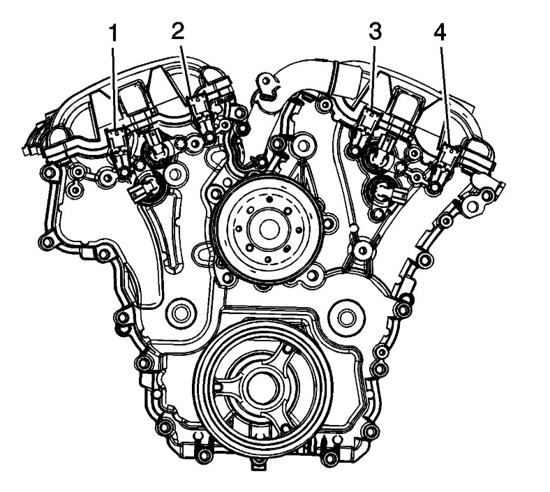

Where are the camshaft position sensors located?

Hi Syclone,
Happy to answer that for you. There are four sensors. I am attaching an image to show you where they are. They are at the front of engine at the end of each camshaft. This guide will help you step by step with diagrams below to show you on your car
https://www.2carpros.com/articles/camshaft-angle-sensor-replacement
Hope this makes life a little easier! Cheers!
