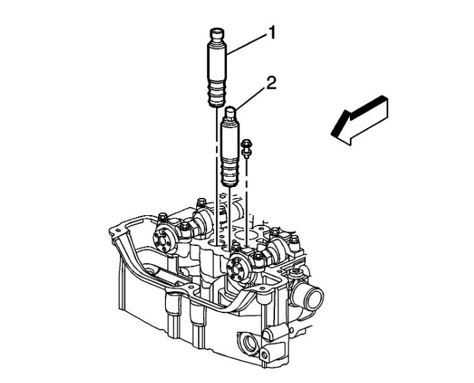

The check engine light comes on along with traction control and esc.
Nov 9, 2018 at 1:58 AM
Good afternoon.

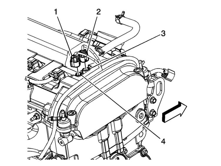

The code is for the camshaft actuator.
Below is the picture and procedure.
1. Remove the air cleaner outlet duct. Refer to Air Cleaner Outlet Duct Replacement (See: Air Cleaner Fresh Air Duct/Hose > Removal and Replacement > Air Cleaner Outlet Duct Replacement).
2. Disconnect the engine wiring harness electrical connector (1) from the exhaust camshaft position (CMP) actuator solenoid valve (4), if required.
3. Disconnect the engine wiring harness electrical connector (2) from the intake CMP actuator solenoid valve (3), if required.
4. Remove the exhaust (1) CMP actuator solenoid valve bolt and valve, if required.
5. Remove the intake (2) CMP actuator solenoid valve bolt and valve, if required.
6. Inspect the solenoid valve O-ring seals for damage, replace as necessary.
