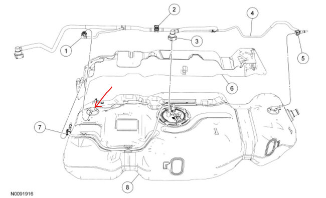

Code for fuel pressure sensor?
2010 FORD EXPEDITION
194,000 MILES • 5.4L • V8 • 4WD • AUTOMATIC
RANDOMMOSSY
I just bought this truck and I have a code for a faulty fuel tank pressure sensor. When I try to look up the part it says that this truck does not have one, nor can I find anywhere showing the location for it.
Feb 7, 2026 at 8:56 PM
  • 55,214 POSTS
Yes, this truck does have a fuel pressure sensor for the tank which is where the sensor is located. Check out the images (below). Let us know if you need anything else. Ken
Feb 8, 2026 at 11:56 PM
RANDOMMOSSY
By any chance would you have a part number, even if it's the entire hose assembly? The dealer game me a part number for a hose connector this morning... Instead of the sensor
Feb 9, 2026 at 12:15 AM
  • 55,214 POSTS
Sure, the OEM Ford part usually has Ford part number XS4Z-9C052-AA (supersedes older numbers like XS4Z-9F479-AA) for 2009-2010 Expedition fuel tank pressure sensor applications. Let me know if you need anything else.
