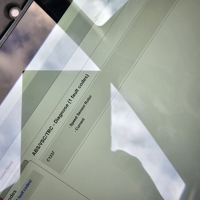

Hello all,

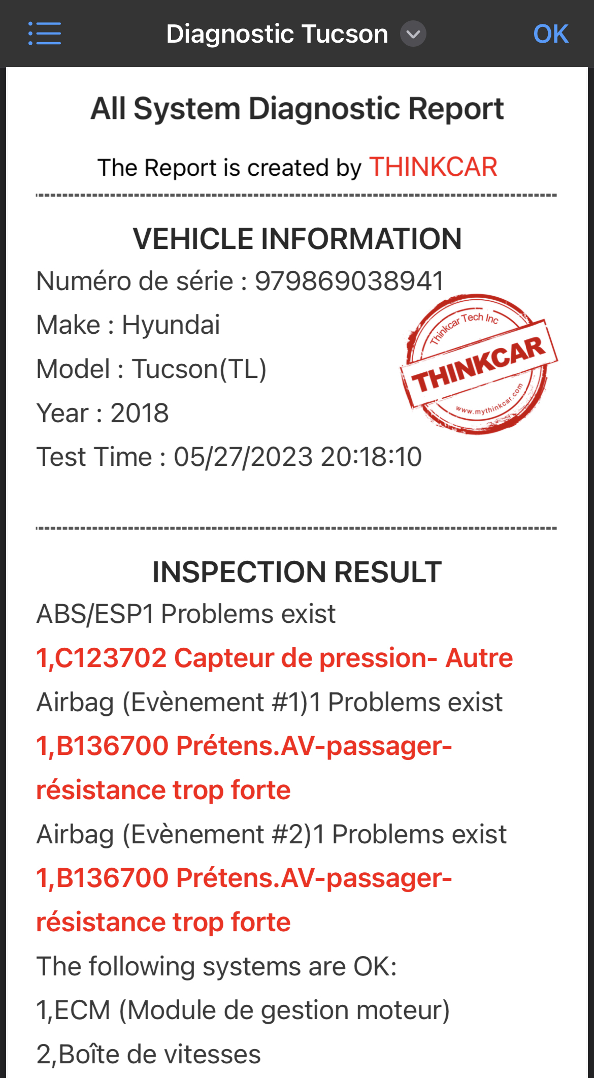

There is the stability control and hill descent control signals permanently lightning on my dashboard and I got this error code on my vehicle listed above TL when launching a diagnostic C1237.
Can you help me to determine the problem?

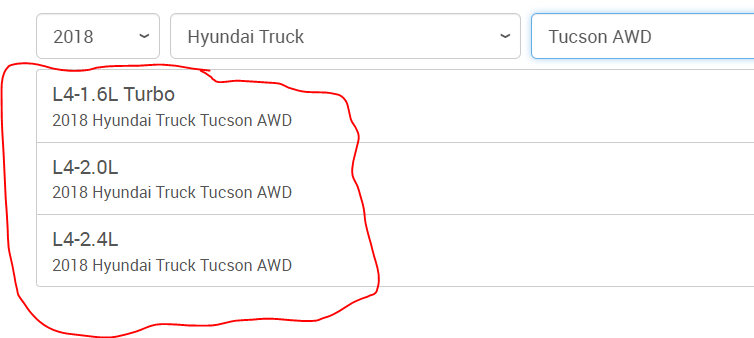

Before I confirm my thoughts, I need to know which engine the vehicle has. There are three different ones that were available. See pic 1 below and let me know which you have.
Now, the code, in general, deals with the ABS control module (HECU, hydraulic electronic control unit). This code may be specific to the pressure sensor which is integral to the module. If that is the case, the HECU will need to be replaced.
Please confirm the engine size for me.
See pic below.

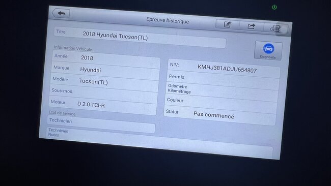

My Tucson's engine is D 2.0 TCI-R so it should be L4-2.0L in your list.

Can you please double check the code number? Code C123702 does not exist in the standard OBD-II (On-Board Diagnostics) code list.
Aug 5, 2023 at 3:40 AM
DAN ONDO
  • 9 POSTS
Hello Ken,
Please have a look at the diagnostic obtained below.
Thanks
Aug 5, 2023 at 4:39 AM
  • 55,399 POSTS

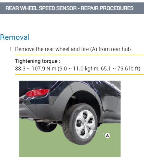

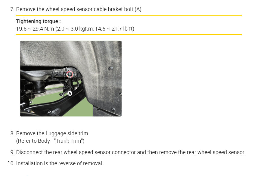

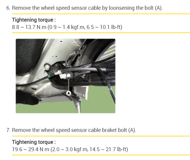

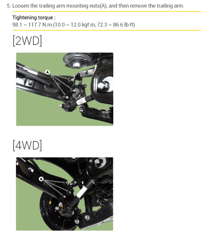

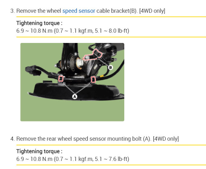

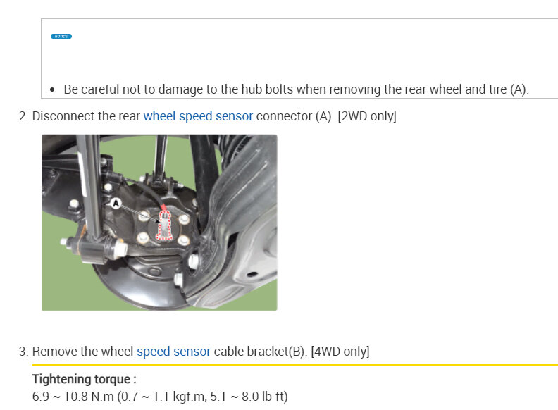

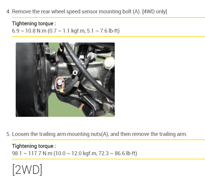

I see, so the codes are C1237 and B1236:
The C1237 and B1236 codes you mentioned are specific to the Anti-Lock Brake System (ABS) and the Stability Control System on your vehicle. Here's what each code means:
C1237 - Speed Wheel Right Rear Input Signal Missing
Possible causes of B1236: Damaged or faulty mirror vertical switch.
So, I would replace the right rear wheel speed sensor and then clear the codes. Check out the images (below). Please let us know how it goes.

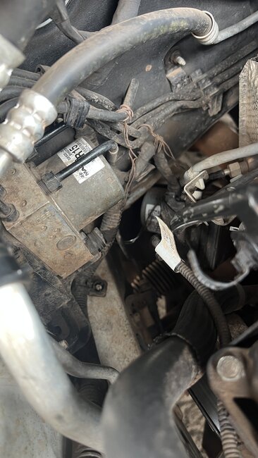

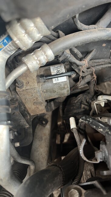

When I opened the hood of the car, I found something extraordinary (lmao).
The hydraulic ABS with the ref 58920-2S310 R15 is still next to the engine but disconnected and bypassed by another one with different ref 58920-D3100 H2.
I have to take a picture to show you the "trick"
Do you think this could explain the error codes observed ?
Dan
Aug 11, 2023 at 9:26 PM
  • 55,399 POSTS

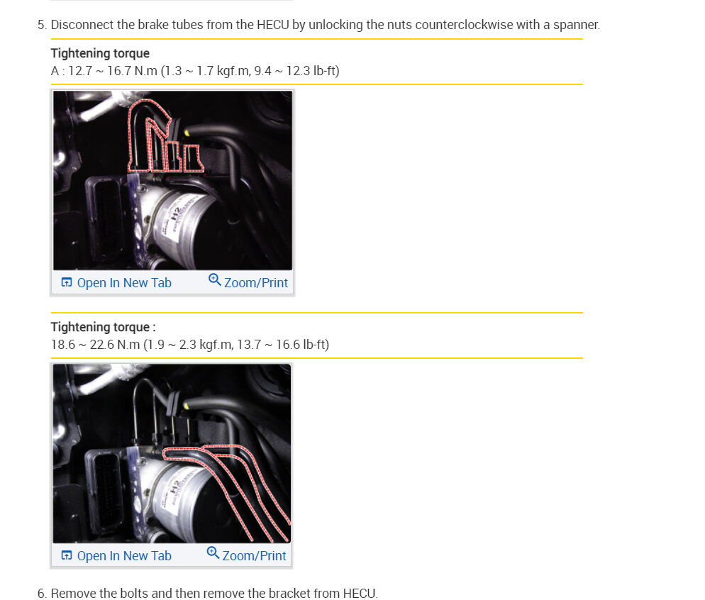

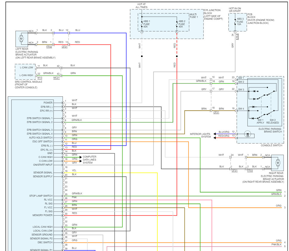

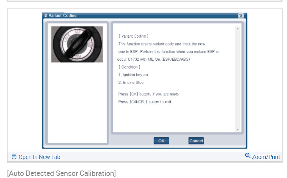

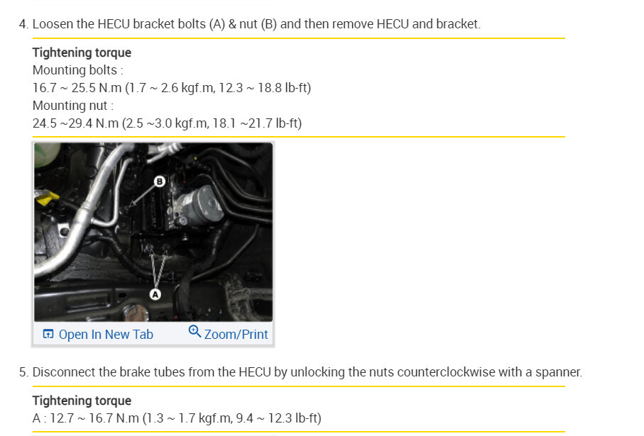

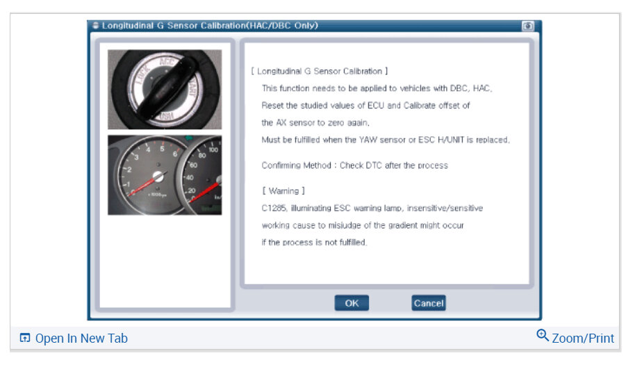

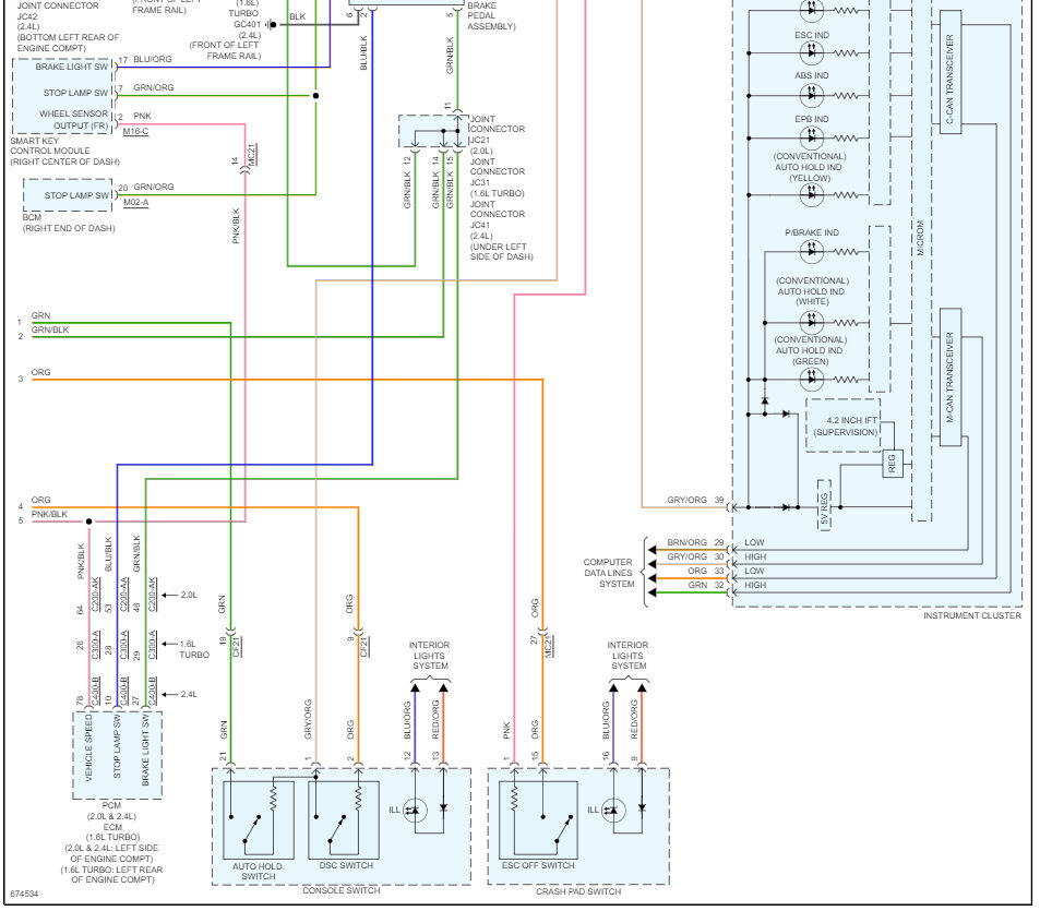

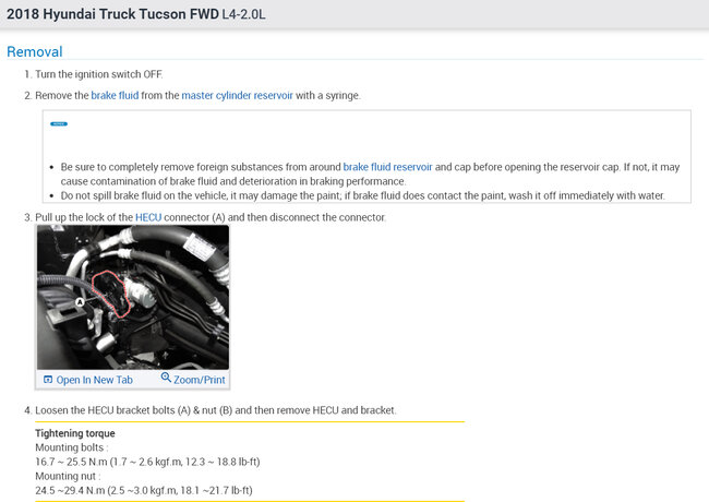

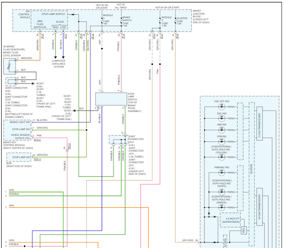

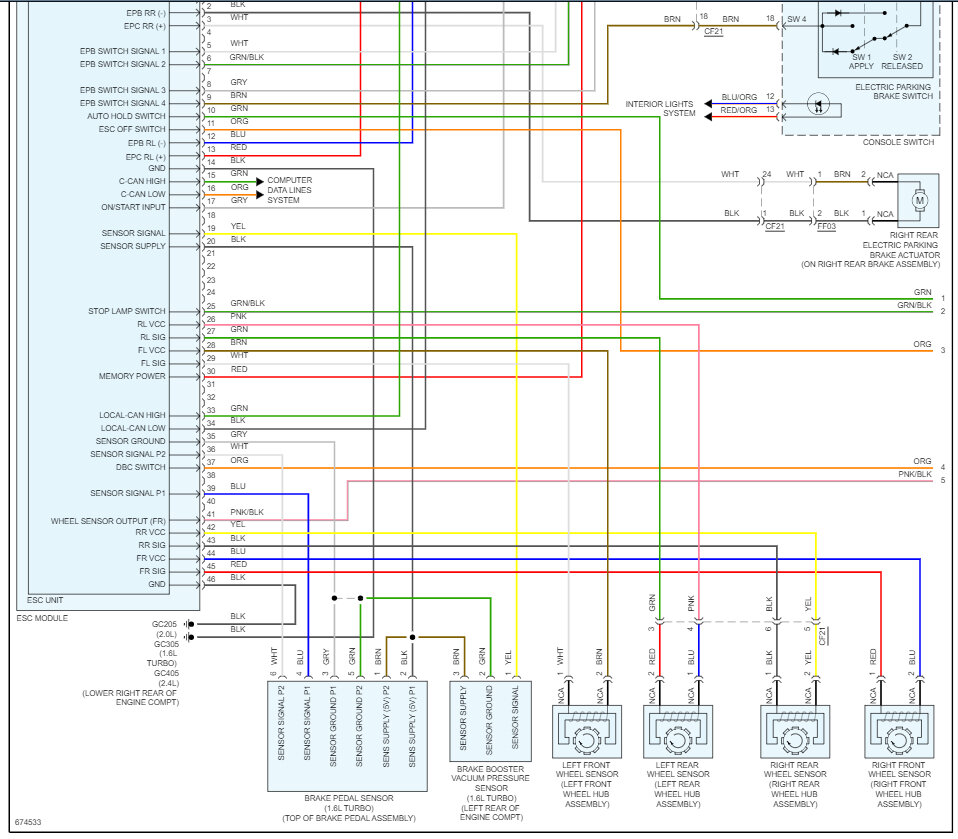

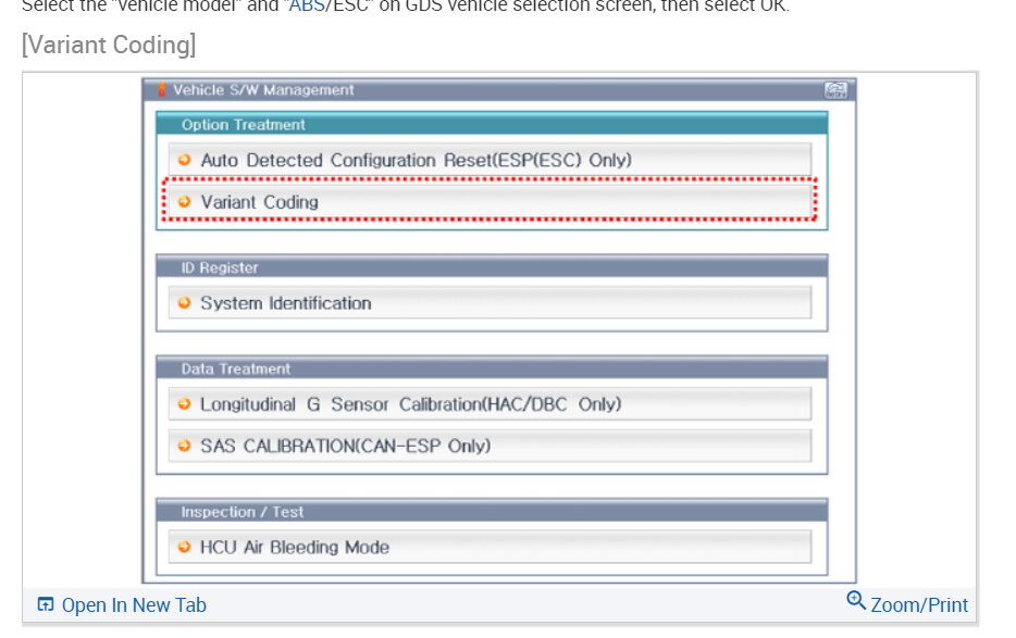

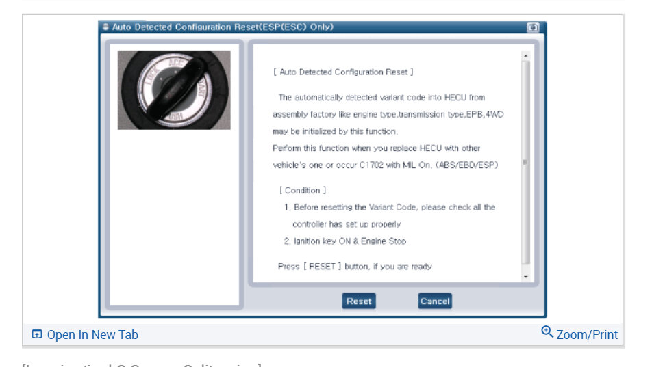

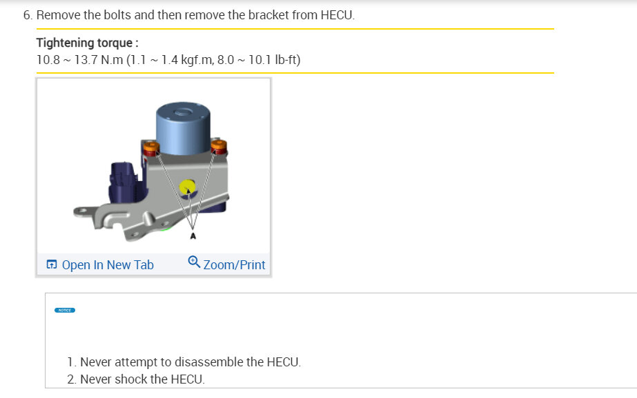

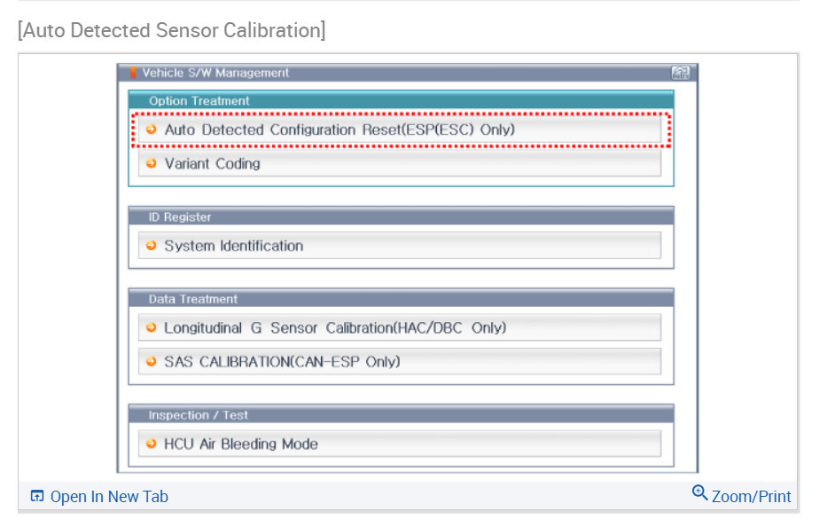

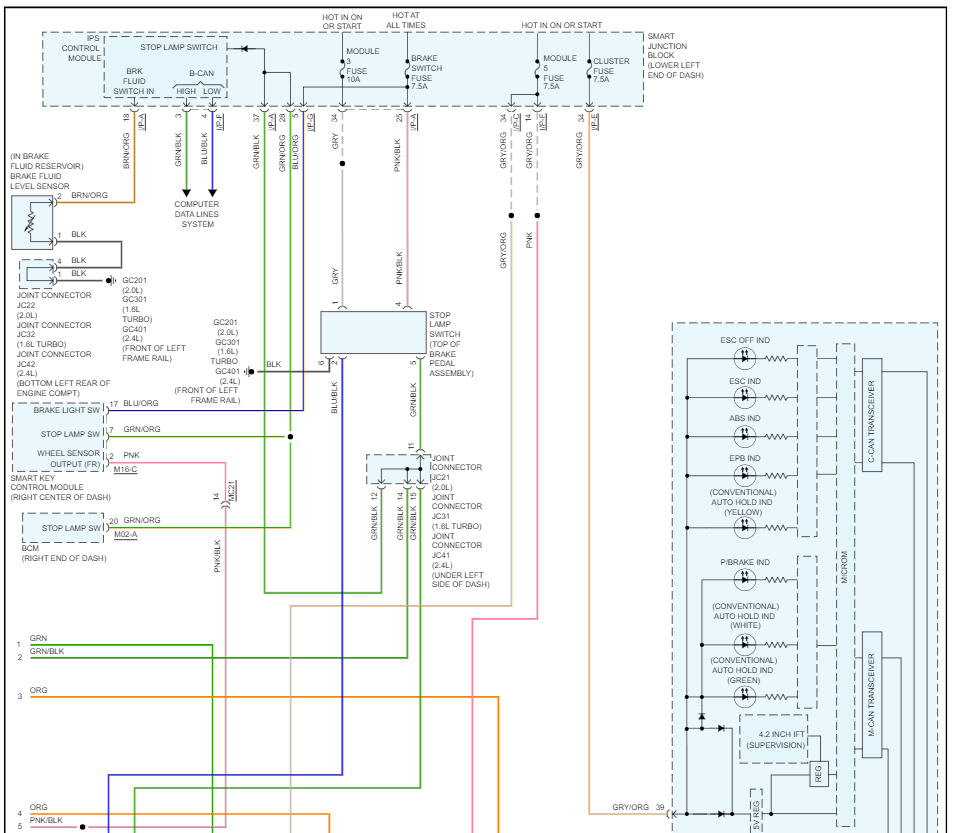

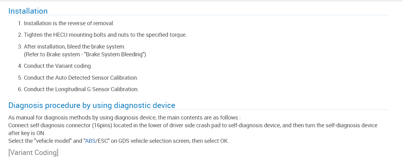

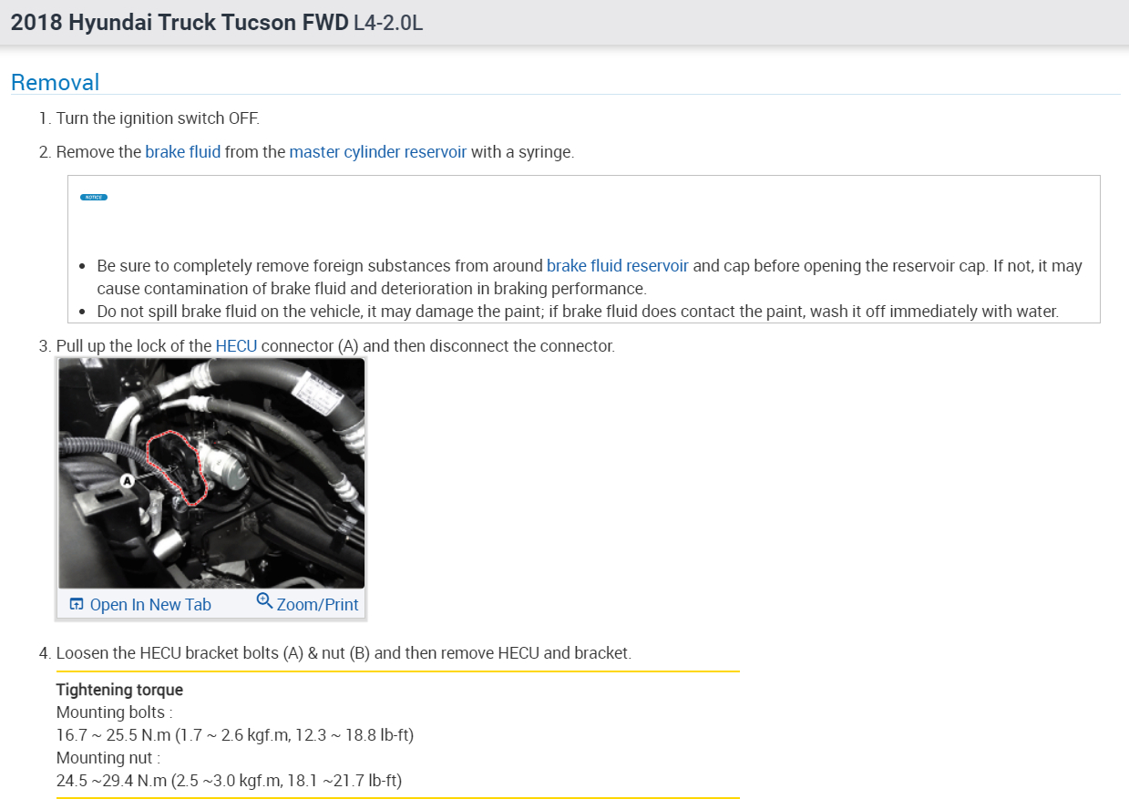

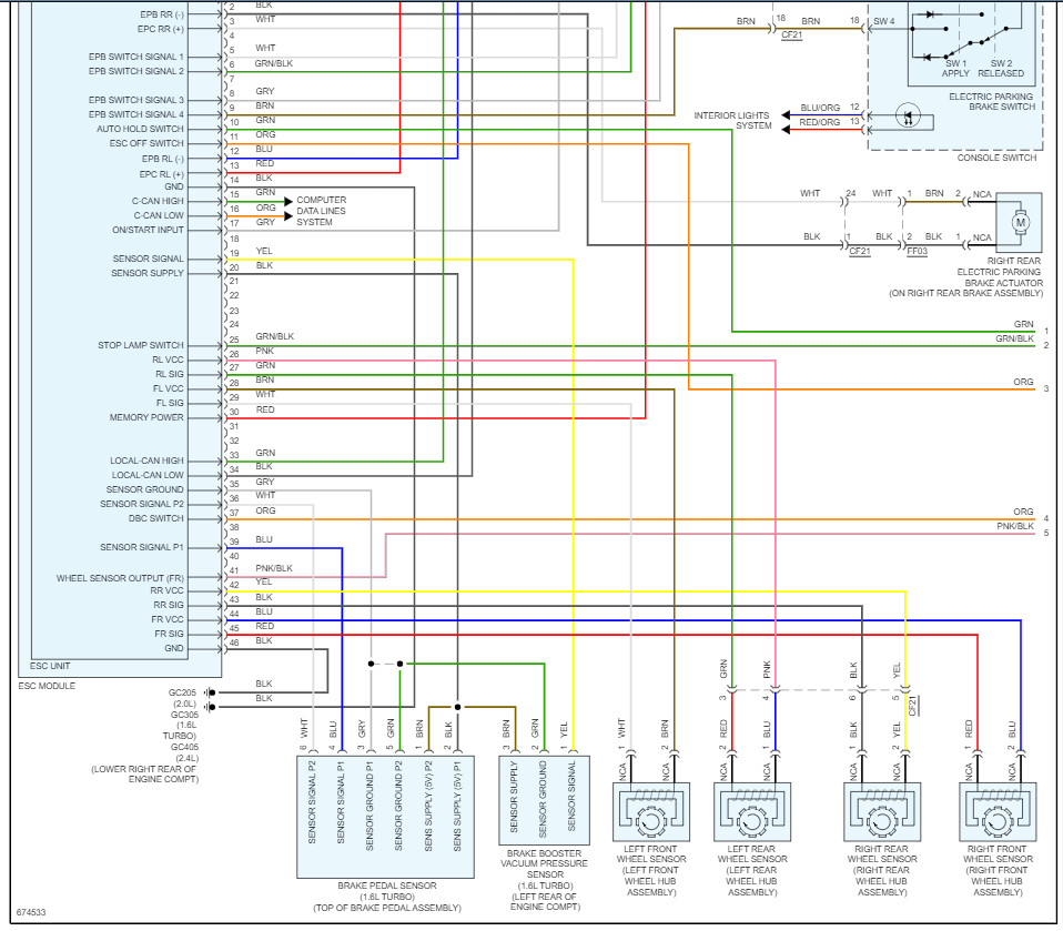

Yes, that can be a problem, it looks like the wiring is damaged as well. Here is a guide to help test the connections and the traction control and BAS wiring diagrams so you can see how the system works:

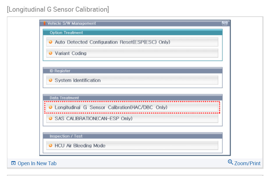

It looks like there is a set up procedure that must be done when changing out the ABS module. Check out the images (below). Please let us know what happens.
