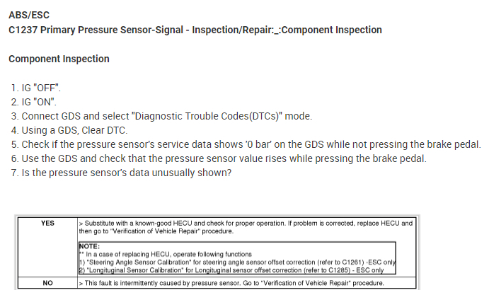

Codes C1237 and C1800
2012 HYUNDAI SONATA HYBRID
110 MILES • 2.4L • 4 CYL • 2WD • AUTOMATIC
GIORGI GAMBASHIDZE

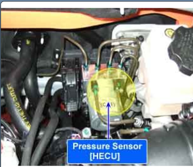

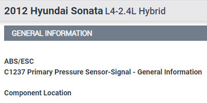

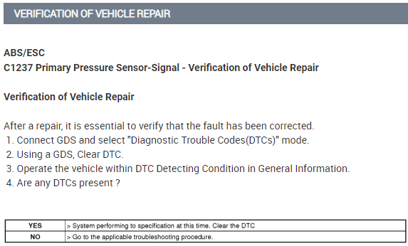

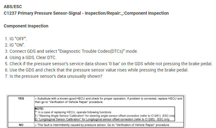

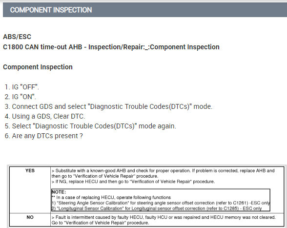

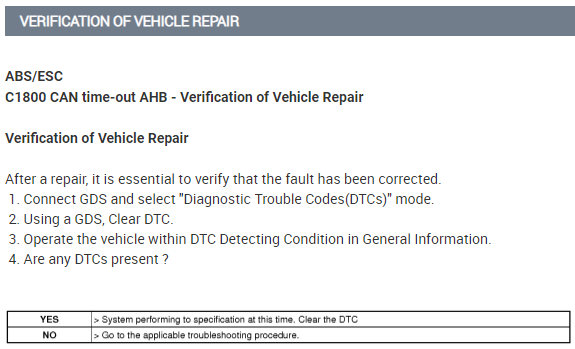

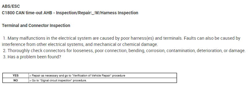

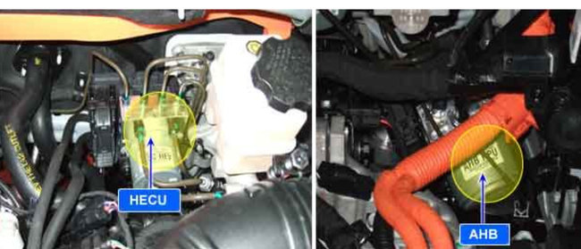

Good evening,
I got a codes on my vehicle listed above.
C1237 and C1800 primary pressure sensor signal.
Can you help me to determine the problem?
Should I change the HECU?
Thanks
Apr 17, 2021 at 1:02 PM
DANNY L
  • CAR REPAIR CONTRIBUTOR
  • 5,648 POSTS

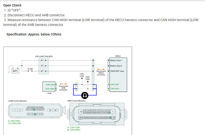

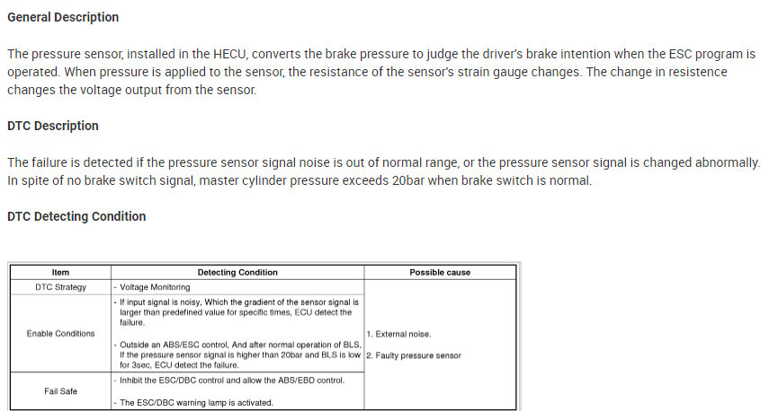

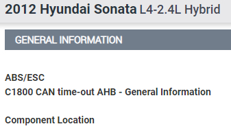

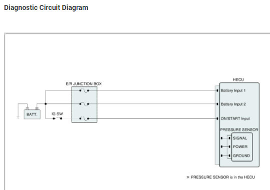

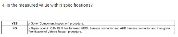

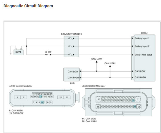

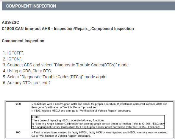

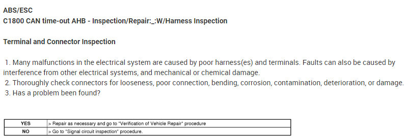

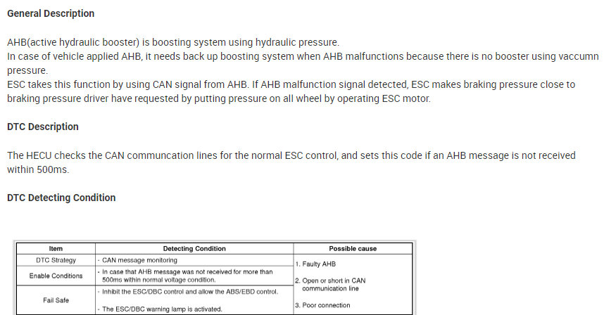

Hello, I'm Danny.

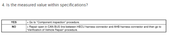

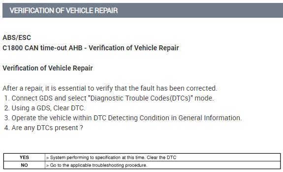

Here is the information you requested. I've attached picture diagnostic steps below related to the 2 ABS codes you provided. Let us know what you find and get back to us so we can provide you with the necessary repair information. Hope this helps and thanks for using 2CarPros.
