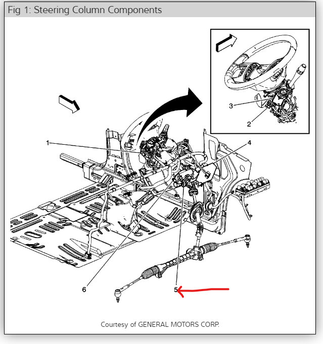

Says the steering wheel angle sensor is the problem. can't find what this is or where it is. Please help, thank you.

The diagnostic trouble code "C0460-5A" on a 2008 Saturn Vue is related to the steering angle sensor.
C0460: This is the generic part of the code, indicating an issue with the Steering Angle Sensor (SAS).
5A: This part of the code is a manufacturer-specific or enhanced code that provides more detail.
Here is how to change out the steering angle sensor to help you fix the problem, also when the job is complete, please clear the codes.

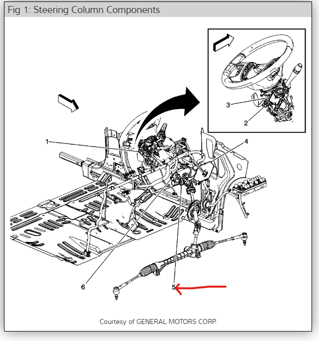

The sensor is at the base of the steering column. Check out the images (below). Please upload pictures or videos of the problem so we can see what's going on.
