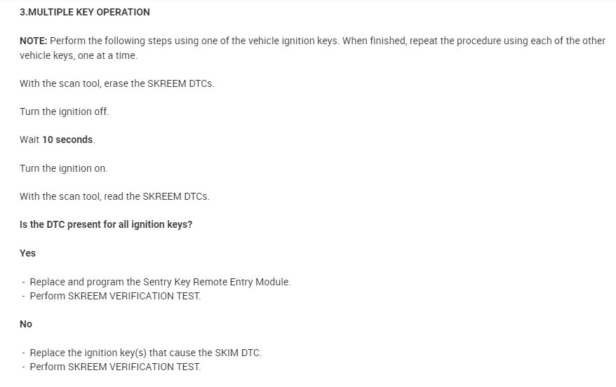

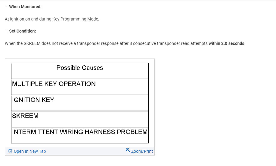

Third owner of the car and it’s been a journey getting this car fixed of all engine codes beside a vacuum leak, but I’ve been dealing with my key having to be basically turned on and off multiple times and having to rip it out like I’m starting a chainsaw. Could I get any advice on where to start at?
Aug 3, 2023 at 9:11 PM
  • 110,194 POSTS

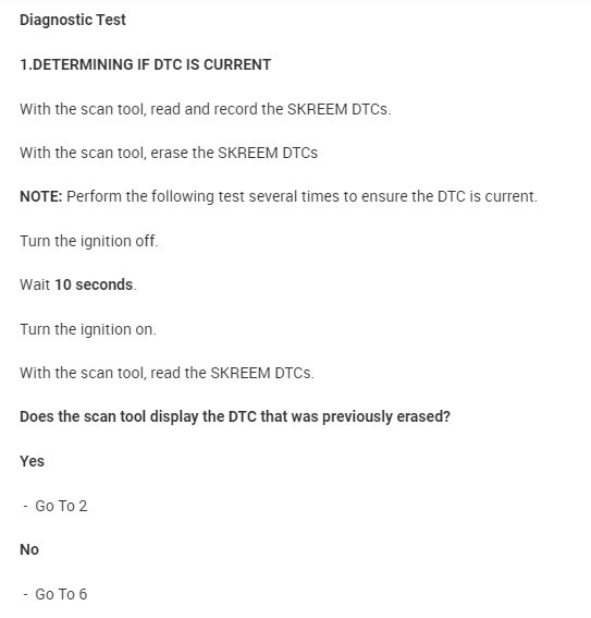

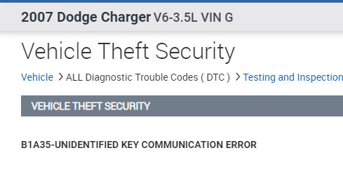

Both of the codes are related to the key not being recognized. If you have a spare key, try it to see if it makes a difference.
I looked through the diagnostics for both codes, and they are basically the same. So, I attached the diagnostics below. Take a look through them and let me know if this is something you feel comfortable doing.

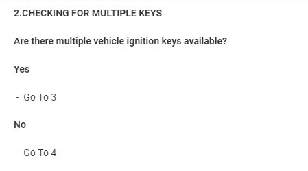

That second picture is blurry. Is there any way you could send a link or email it to me? And I just have $50.00 Bluetooth hyper tough ob2i reader, would that work to fix this issue? I feel like the person before me that installed the aftermarket radio might have gotten something mixed or cut or something idk. It’s been a crazy ride with this car for sure.
Aug 4, 2023 at 4:12 AM
  • 110,194 POSTS
Hi Ryan,

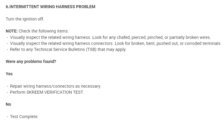

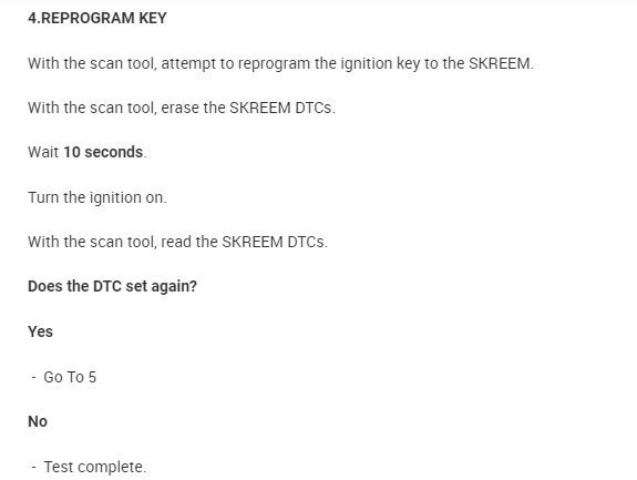

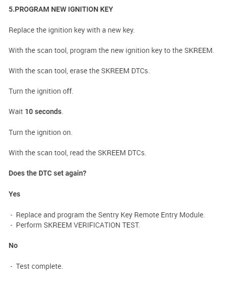

I'm not allowed to email or link it to you because it is from a manual. (Copyrights) I'm allowed to send it via this site. Also, it's unlikely the scanner you have will do it. You need a bidirectional scanner that can communicate with the modules and not just receive information.
I enlarged the pic and cut it in half to make it readable for you. I did overlap the two so you can follow from one to the next.
Let me know if you are able to read this one.
Aug 4, 2023 at 8:12 PM
