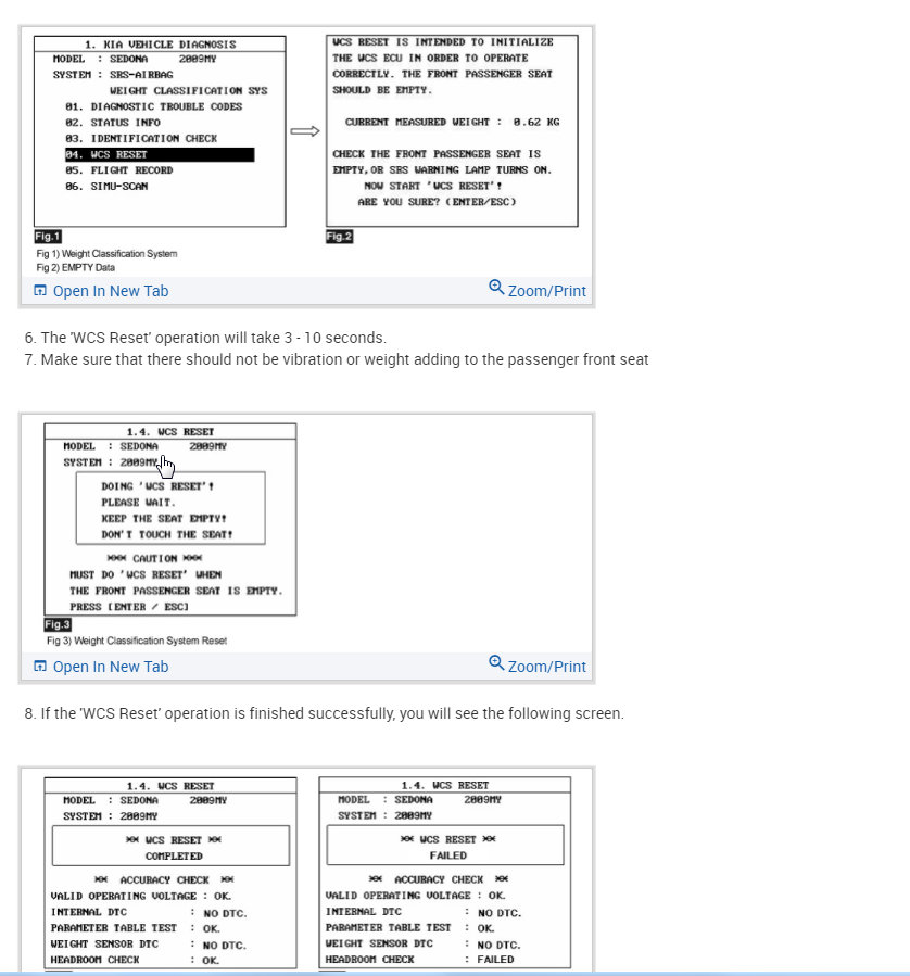

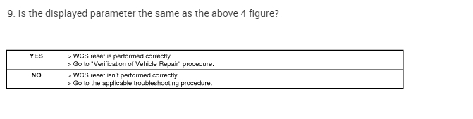

I scanned my vehicle for Airbag light on and the result is; Code B1324 WSC communication error. Kindly tell me what does that means and what is the possible solution? thank you
Aug 8, 2019 at 5:42 AM

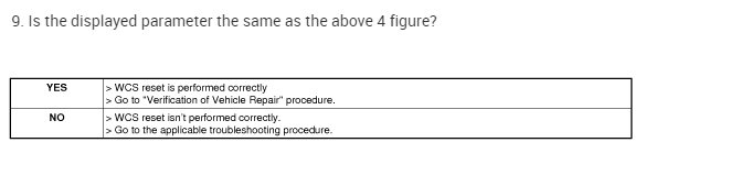

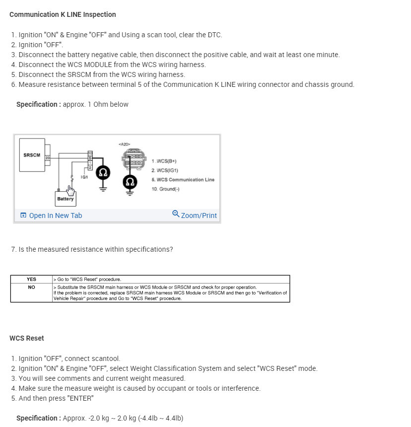

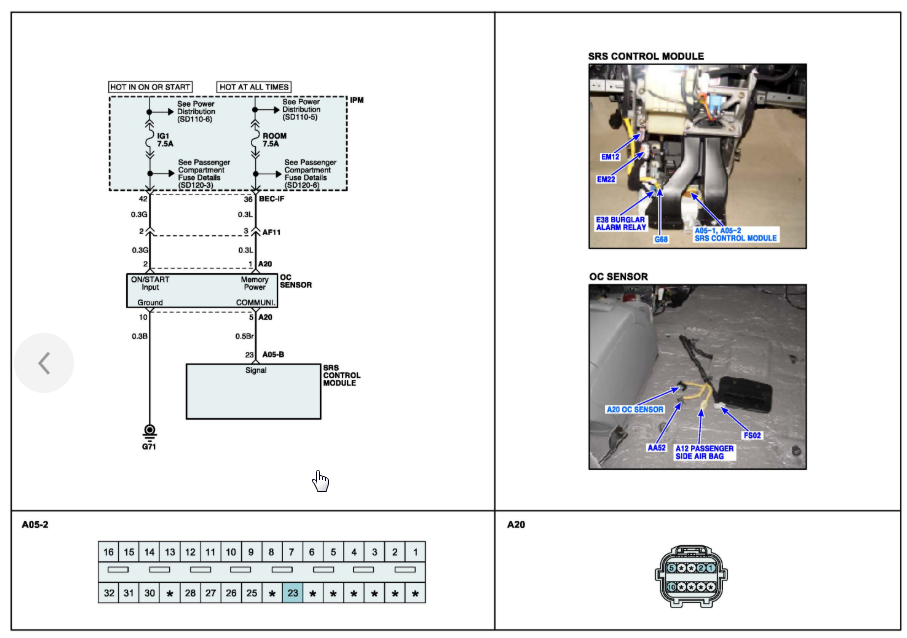

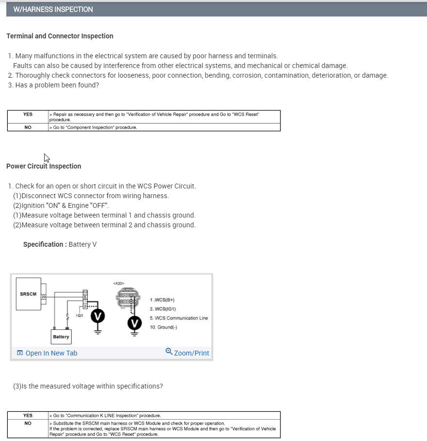

This is the weight classification system. Basically, it is telling you that there is more than likely a wiring issue. Attached is the detail about the system and diagnostic information. Unfortunately, there isn't one easy answer for this one.
You will need to go through the wiring as described to see if there are any terminal or wiring issues. Let me know if you have questions that these documents did not answer. Thanks
